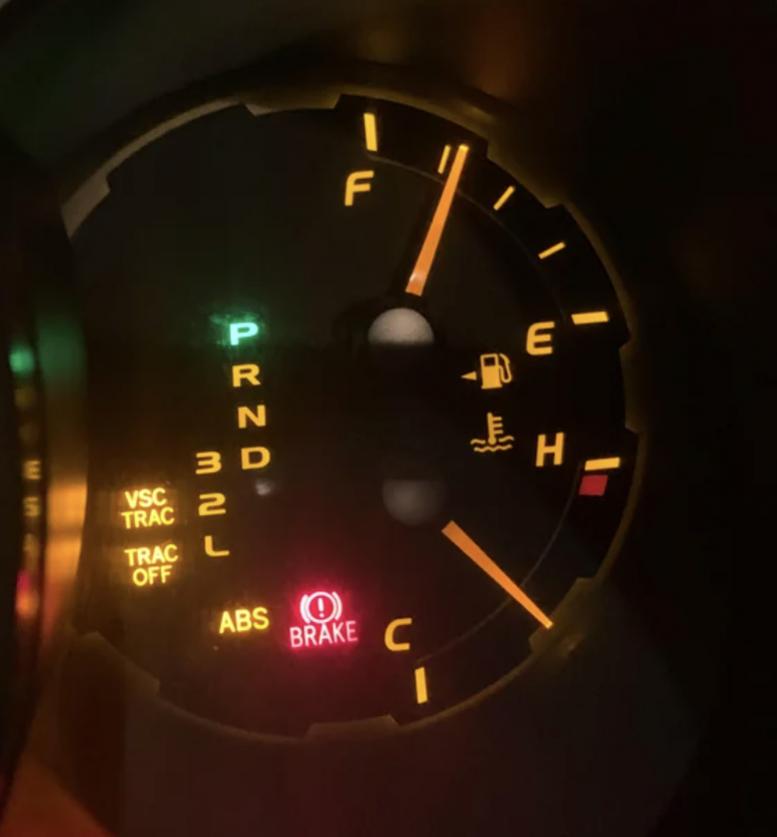

Here is my summary of what happens
As of March 27 after installing the new brake pump accumulator on my 2003 T4R
I experienced some weird things
Key in the ‘ignition on’ position (no engine start) is leading to one of the two modes….
The more I am repeating this exercise the more dominant B becomes meaning A is happening only very rarely (maybe one out of 10)
A)
VCS/TRAC/ABS/BRAKE alarm light issue:
All 4 warning lights come up but no alarm sound and brake motor does not run..
During test drive I am still having good braking power.
B)
VCS/TRAC/ABS/BRAKE alarm light PLUS alarm sound issue
All 4 warning lights come and alarm sound!
Brake pump motor runs non stop.
In addition in B I have the sighing/wining noise coming from the side of the brake booster unit
(see/hear video)
What do the VCS/TRAC/ABS/BRAKE alarm lights mean?
I simply don’t know for sure what the lights mean.
