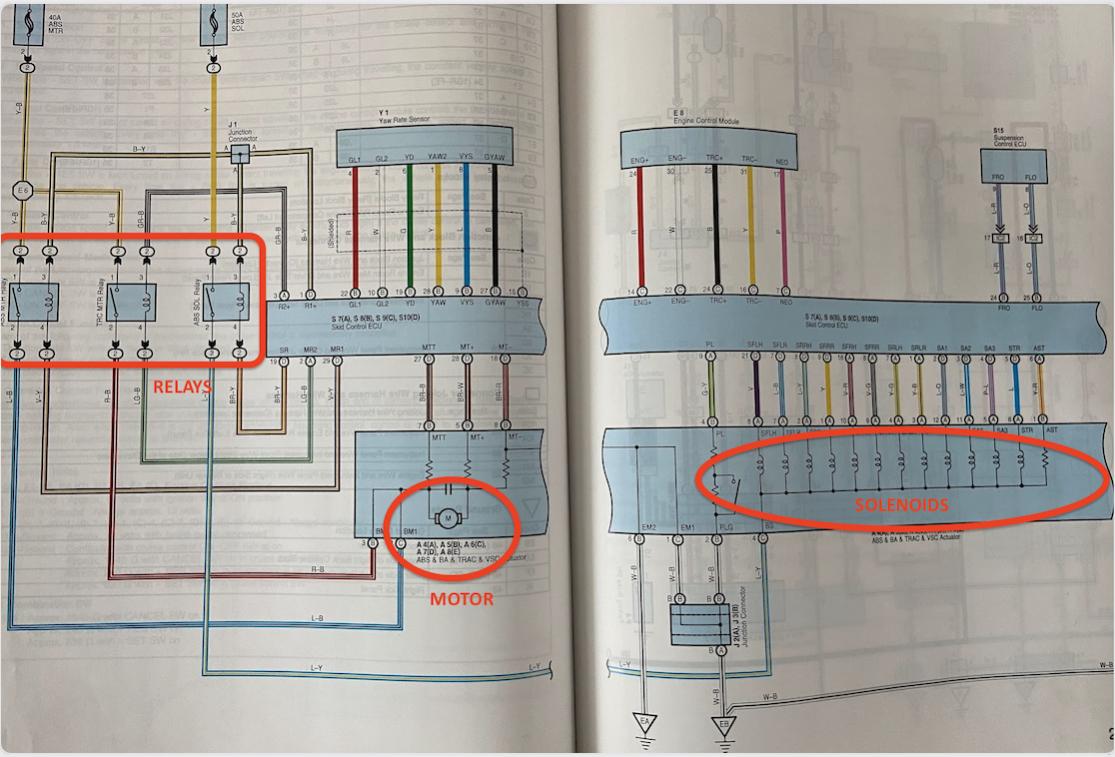

Thanks Auseeker,
Indeed you are right!
I found the buggers (ABS and TRC Relays) here on the electrical diagram,
There is a ABS Motor and a battery of solenoids (That must be located in the block next to the master cylinder where the 5 plugs are attached).
Also I see the Skid Coltrol ECU in this diagram, a computer that controls the ABS VSC TRAC.
Now it dawns on me. That weird sighing noise during the alarm from the side of the VSC block next to the master cylinder is from this ABS/TRC Motor! It must be.
That means this motor is running during the alarm.
What is the ABS motor doing?
Does the system use a lot of braking power in the process?

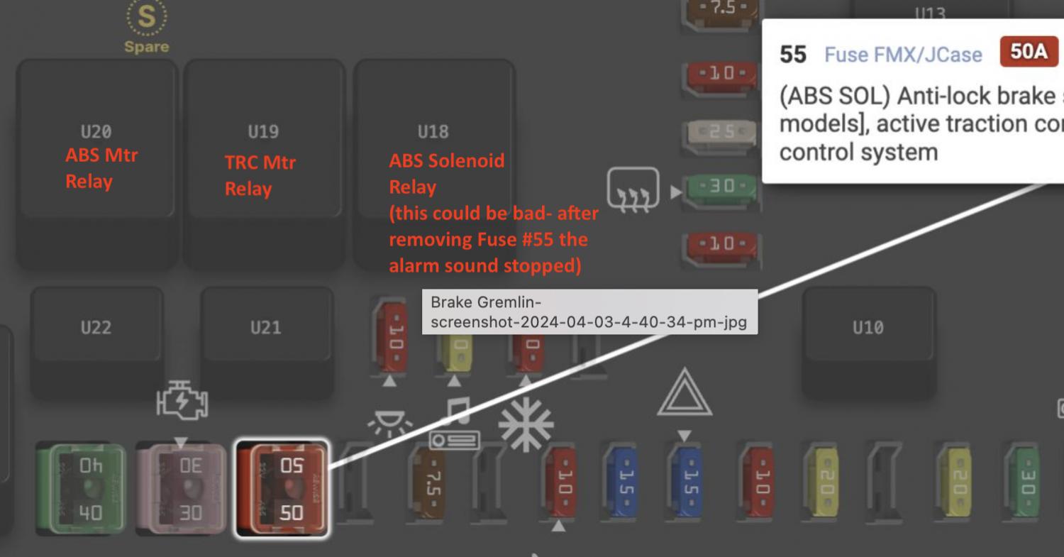

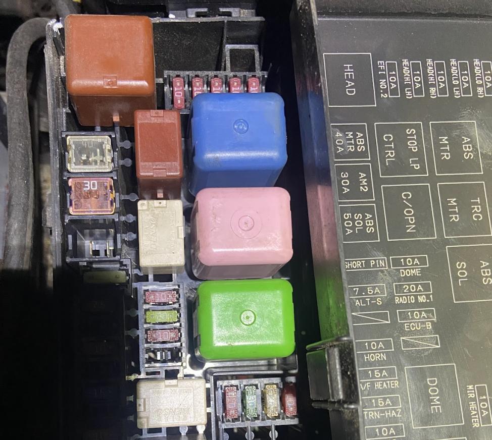

Hi Mike,
here is a picture of my relays.
Blue Cube= U20 (ABS Mtr)
Grey Cube = U19 (TRC Mtr)
Green Cube = U18 (ABS Sol) - This one is most possibly bad
I guess these Relays are all the same...don't know why they have different colors.
You also see that I removed fuse #55 (ABS Sol), which mad the alarm sound go away.
I can try and test the relays tomorrow.
If there is continuity between 1 and 2... well then the relay is obviously bad.
Martin

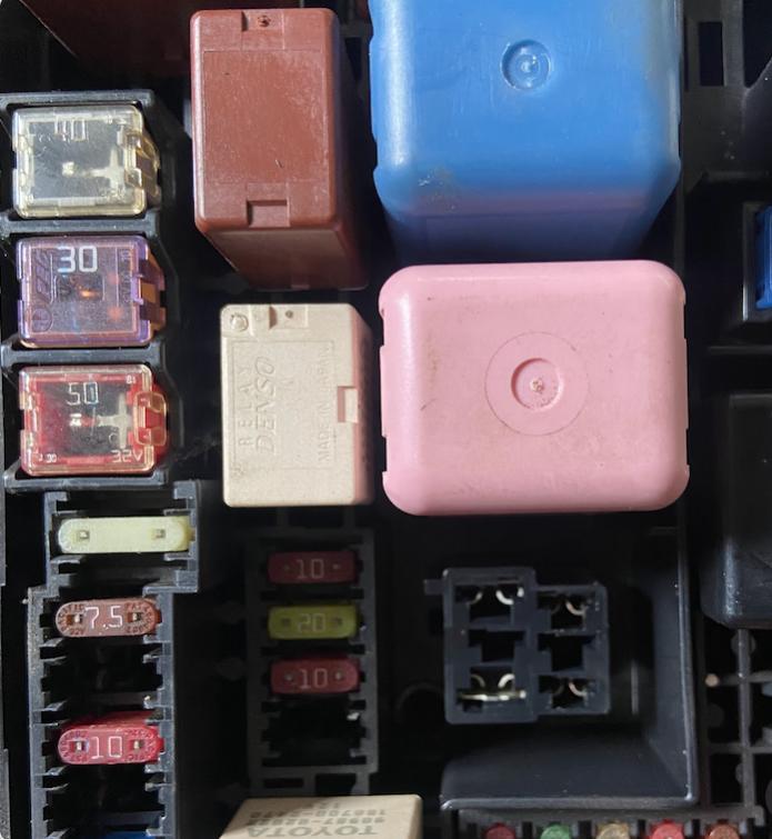

Looking at the colorful covers, I think relay ratings are going to be different. Swapping may not be possible. There is a way to jumper at the socket but not sure that is a great idea for ABS module. You may be able to hear and feel them click with key on. Not sure if these relays can be opened but there is a way to open them and burnish the contacts. Testing is good idea.

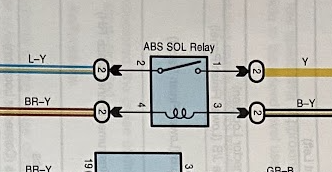

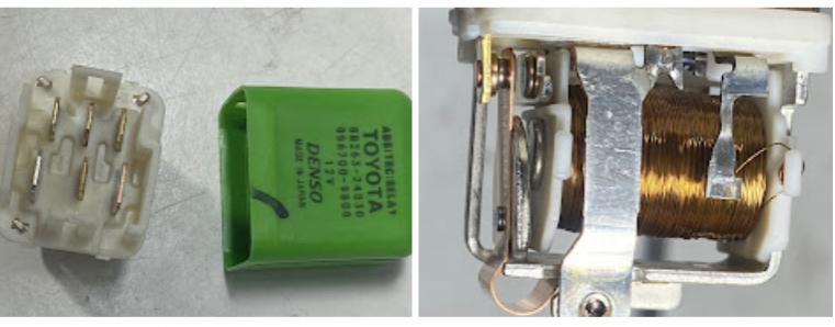

Hi Sam
I pulled the green -ABS SOL- relay U18
It has 6 pins underneath but only 4 that can be active (4 in the socket of the fuse box)
I pulled the cover and everything underneath looks brand new. Everything works after testing it.... so I don't know what is wrong.
I also checked the voltage in the relay socket (fuse box) and there was no voltage at then control socket (for smaller control pins #3 and #4 in the diagram). I checked with key in ignition position and with engine running and fuse 55 installed.
So I don't know what triggers the alarm sound when I install this relay back.
Martin
