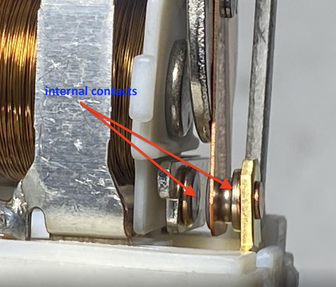

I removed the green Relay again and tested it extensively. It works perfectly fine.

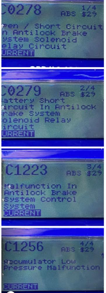

I was just reading the current ABS codes 1-4.
Before I erased the codesn I had 8 failure codes.
I listed them all below and marked the 4 current ones.
1) C0278 open/short Circuit in Antilock Brake System Solenoid Relay Circuit
2) C0279 Battery Short Circuit in Antilock Brake System Solenoid Relay Circuit
3) C1223 Malfunction in Antilock Brake System Control System
NOT [C1246 Malfunction in Master Cylinder Pressure Sensor]
NOT [C1252 Hydro-Booster Pump Motor Malfunction]
NOT [C1253 Hydro-Booster Pump Motor Relay Malfunction]
NOT [C1254 Pressure Switch Circuit]
4) C1256 Accumulator Low Pressure Malfunction
What I am reading now is that there are 3 events
A) Solenoid Relay Circuit problem (open circuit/short in circuit)
B) Antilock Brake System Control System (Malfunction)
C) Accumulator low pressure malfunction.

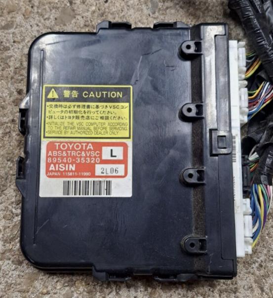

I am not certain what the ABS control system is but it could be the ECU (Skid Module ECU)?
If so I could probably buy a good used Skid Module ECU (Toyota 4Runner ABS TRC VSC Traction Control Skid Module 89540-35320 5626)
I know I am starting throwing parts at this problem but what else can I do?

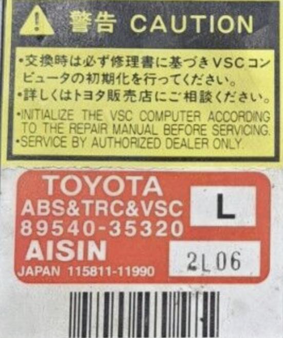

The ABS Skid Control ECU looks like in the picture and on the label I see the note:
"Initialize the VNC computer (I am assuming the VNC computer is this very skid module?) according to the repair manual before servicing.
Service by authorized dealer only (I love these kind of instructions)
So it seems there is a procedure described in the manual (which I don't have). Is the installation of the the Skid module doable for me?
Need help here.

Replace relay. It supplies power to solenoids. Or perform click test and check current side for continuity. It's a good idea to open up relay and clean up current side contacts. If relay passes, then issue lies beyond the relay.
Do dash lights and CEL some on immediately on key on or do dash lights come on after driving a little? The former is a POST or initiation error, the latter is likely bad sensor input.
C0278 and C0279 indicate relay and power issue.
C1223 indicate unresolved ABS issue and goes away when root cause is fixed.
C1426 is Master Cylinder Pressure Sensor which is part of the ABS Hydraulic Control Actuator. That's the $1.4k part we are trying to avoid.
You need to clear C0278 and C0279 first. Best case scenario is solenoids are not getting power which is causing C1426 code.

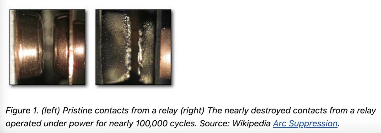

short the relay's output side [contacts 1 and 2], connect the 2 socket leads with the relay removed. The electronics must be really clever.
C1223 seems related.
I'll try and get new relays, at least the Green Relay (U180 that runs the solenoids.
old Contacts look brand new, but I will get the burnish tool and clean
contacts and test with the old relays again.

Lets hope this code is NOT unrelated to the first 3 codes?
Maybe no one really knows what is going on inside the ECU and therefore hard to analyze what is happening?
I could try and remove the pressure sensor and clean it out... if that is the issue. If it does not solve the issue... get a new pressure sensor.... or a new ABS hydro booster when I am desperate enough.

So maybe that ECU is cooked...Can I replace that ECU simply or do I need to reset/program that board somehow?

External contacts are not the issue. Take relay top off and clean internal circuit side contacts. They carry current and can arc which wears them out or causes carbon deposit. Click test is applying 12V to the control poles. This tests the coils which magnetizes to close circuit side and allows current to pass to the solenoids.
Thanks Sam,
Did I understand correctly, that the internal contacts can arc. The contacts would look like this and that could cause my symptoms (brake alarm)?
Here is a picture of my relay contacts and I found a picture of a good and bad contact.
