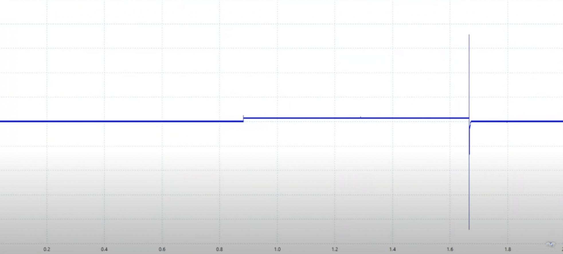

Here I found a video showing the problems of a relay... I wonder if this is one issue that happens in my case as well?
He is talking about the relay that might jeopardize the ECU with its high voltage ... is that arcing?

Corroded contacts can cause poor electrical transmission which can lead to overheated circuits. Most sensors rely on voltage signal so it is critical they get clean power. I'm no EE but I know this is not good.
Thanks Sam,
The green relay: control circuit pin 4 is fed by the ECU signal port 'SR'. The relay power circuit active then feeds into the ABS VSC TRC Actuator ( Port 'BS' at black box of the hydro booster). I think the solenoids are causing this weird sighing noise that I was describing earlier during the alarm.
The modern ECU seem to be much more sensible, and not accepting a worn out relay, compared to the good old electrical circuits from the 60s-90s.

2) C0279 Battery Short Circuit in Anitlock Brake System Solenoid Relay Circuit (EVENT 2)
3) C1223 Malfunction in Antilock Brake System Control System (EVENT 2)
4) C1246 Malfunction in Master Cylinder Pressure Sensor (EVENT 1)
5) C1252 Hydro-Booster Pump Motor Malfunction (EVENT 1)
6) C1253 Hydro-Booster Pump Motor Relay Malfunction (EVENT 1 or EVENT 2)
7) C1254 Pressure Switch Circuit (EVENT 1)
8) C1256 Accumulator Low Pressure Malfunction (EVENT 1)
Event 1 is the low pressure below the Stage 2 pressure (super low pressure).... causing a low pressure alarm and with this the low pressure codes (codes 4-8...my assumption).
This is an event that happens if I am braking hard hitting the pedal several times in short time... like during race driving. This dash alarm is canceled after the pump motor is picking up the required pressure.
Then there is EVENT 2 , the ABS/TRC/VSC event.... this alarm starts out of the blue (after 10 -20 miles of driving after the alarm is canceled by pulling the green relay), no braking involved in triggering this alarm. This Alarm does not cancel itself. I need to pull the relay in order to cancel.
I believe this failure is triggering the 2 relay codes.
I could spend more time and figure out more. My problem is my cheap code reader (I can easily read the codes but cancelling is difficult, it does not always work...driving me nuts).
Martin
