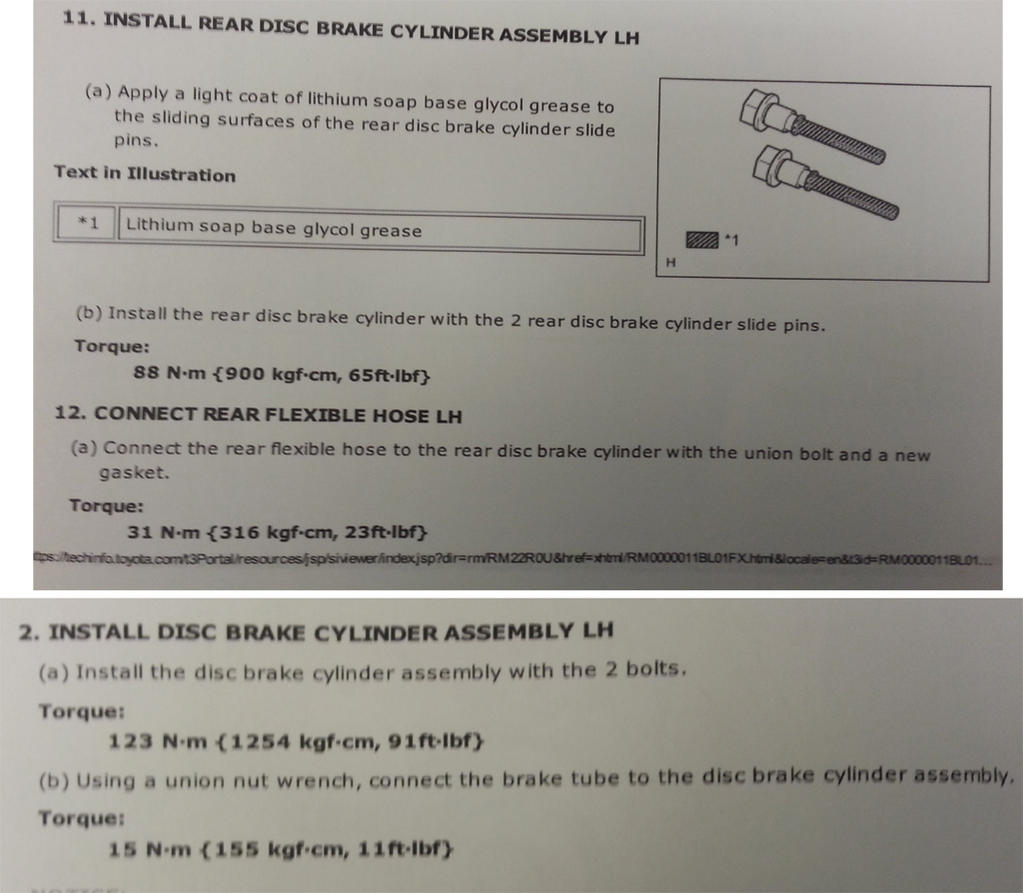

Torque
From TIS for my 2013. 91 for the front and 65 for the rear.

If you're yanking the rear rotors, there is a second pair of bolts (beyond the slide pin bolts) that attach the 'rear disc brake cylinder mounting' bracket to the axle hub. You have to remove that 'mounting' to pull the rotor. The torque spec on those two is 105 N-m or 77 ft-lbf.
