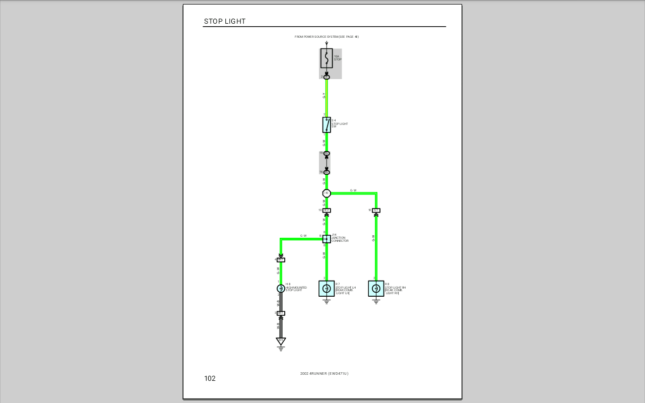

Could be a dirty ground loose wiring rusty socket. Test the socket pins should have 12 volts Have some one step on the brakes and check.. Turn your hazards on and see if they work I believe they use the same filament.
White/Black- Ground
Green- Running lights
Green/White- Stop Lights
edit: Just noticed you have 2001. There was a change in the tail light harness in 01 and 02.
Courtesy of [MENTION=10169]TheDurk[/MENTION]. the tail lighthe wiring 2001 4runner.
Oh this is great, I hope I don't have to use, but will be perfect to reference if chasing.
