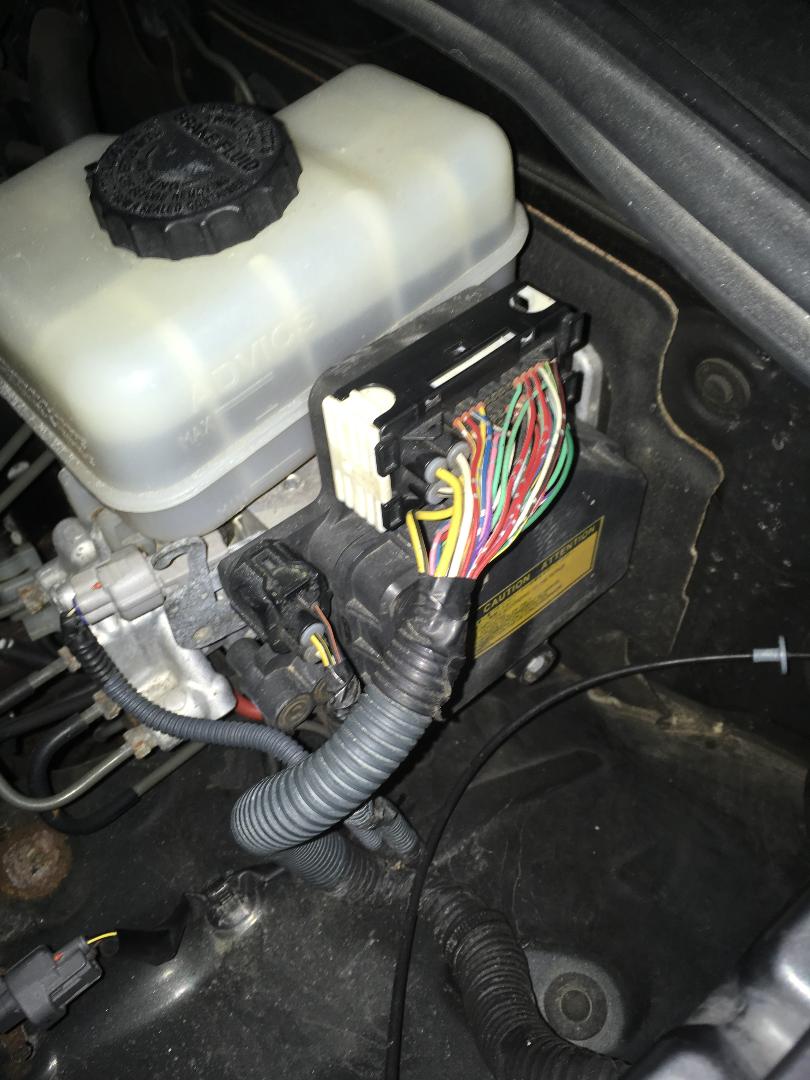

the module is expensive new, but probably a fraction used. only paid $150 for the entire abs brake booster unit. my interest is in knowing if i can easily swap out the middle, which i presume is the black box on the side of the abs unit?

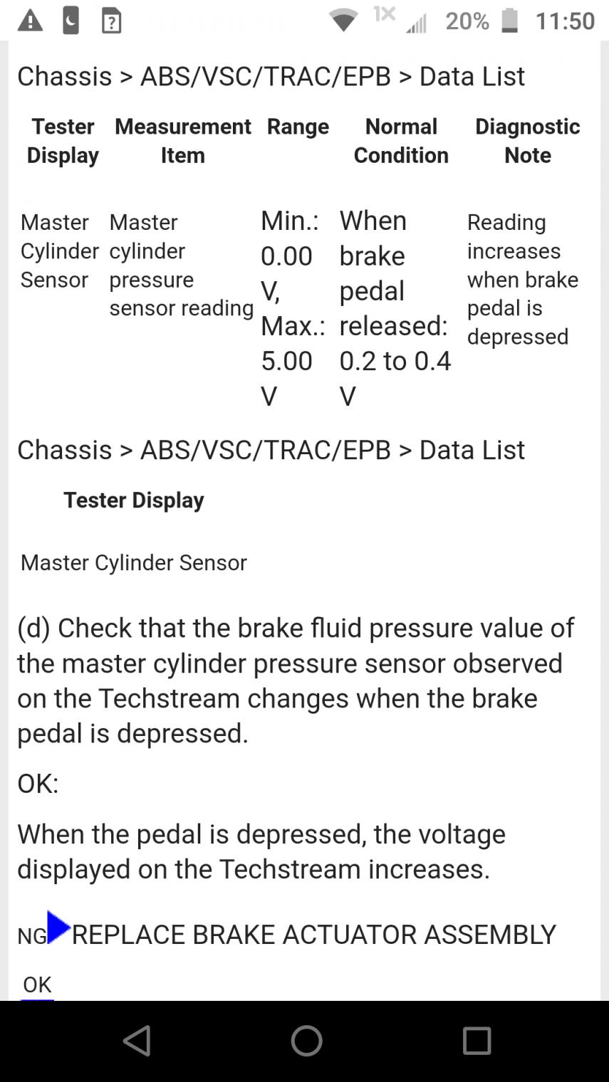

C1246 master cylinder pressure sensor
This diagnostic should have been done with this code. This will prove if your abs actuator module is communicating with the stop lamp switch or not. By observing the voltage at the master cylinder pressure sensor which is inside the abs actuator module as you vary the pressure on the brake pedal. The voltage should increase as you depress the pedal according to the chart. If you're reading the stop switch voltages there then the abs actuator module is communicating properly.. he pulls the stop wire and the lights work.. did all your traction control and stability functions come back too with that wire out? Does your pedal ever get hard or spongy..

5) replacement: haven't seen a video on replacing the module yet (others yes, not my 4runner). it looks like it just unbolts, assuming it is the black case in the pic. haven't got an exact part number yet. i did ask what the labor was, he quoted about $500. sounds ridiculous of it just a bolt on piece. he said there were brake lines involved, etc.

had a productive visit to my local dealers parts dept. (i like parts, low key, no pressure). discussed the part (one in the country). it is part of the master sub-assembly, so that is more available. computer component alone is not sold separately, only as part of the master solenoid, which is the name of the part with the module attached.
compatibility for the solenoid is all v6/v8 8/04-8/07. mine was made 7/07, so all work. i can either shop for just used solenoid w/module, or entire sub-assembly which includes solenoid.

i can replace just the computer module on the solenoid, no brake line involvement? if the whole solenoid, then brake fluid/lines?
if i had to replace the whole solenoid, then i would shop for the entire sub-assembly again and have that replaced. local shop would charge about 3 hrs.
