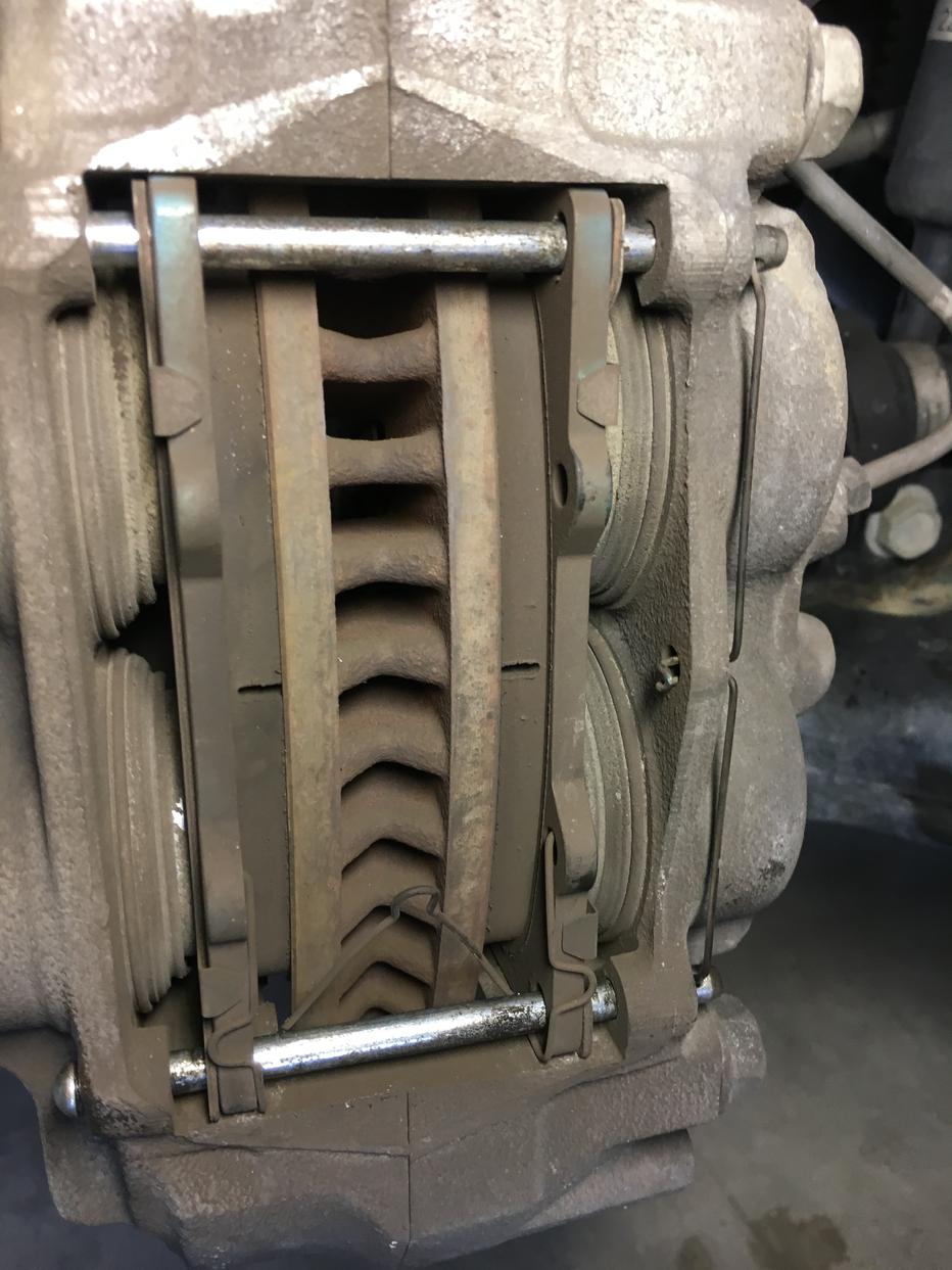

Mine still looked brand new when I checked last month at 80K. I cleaned the pins.

Mine were pretty corroded as you can see from the "after" pic but I didn't try THAT hard like taking a wire wheel to them.
I did just buy an ACDelco brake kit on Amazon with new pins and springs. I haven't installed so I can't confirm if they are exact replacements.
A little steel wool and/or a quick soak in brake cleaner/brake fluid is good enough for me and my vehicles
