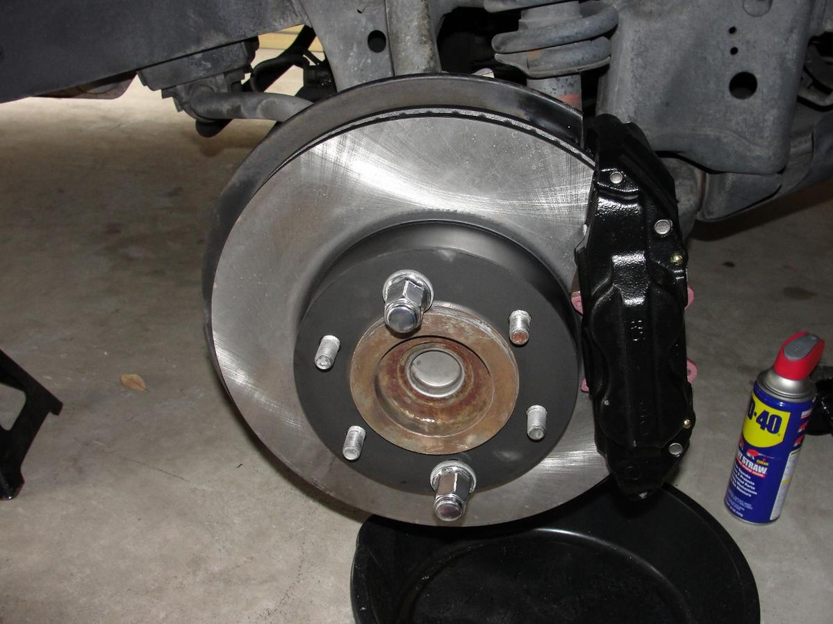

tundra brake upgrade. problem solved.

VERY nice but probably a little overkill for my flat Ohio driving.
overkill? not really. when i want to brake, i want to stop. oe runner rotors warp too easily. i've had 2 runners and they did the same with stock rotors and wasted money replacing with oe ones before i found this upgrade. anyone here will tell you that this upgrade is by far one of the easiest to do and worth the money. it cost a little more than stock parts but well worth it.

Not overkill by any means. The factory brakes on these trucks are so grossly undersized you could almost consider them unsafe. Add your boat into the equation and it's that much worse.
You can certainly just replace your rotors but you'll be doing pretty regularly or living with the pulsation. Or, you can do the Tundra upgrade which is a direct bolt on. Do it once & do it right as they say.
