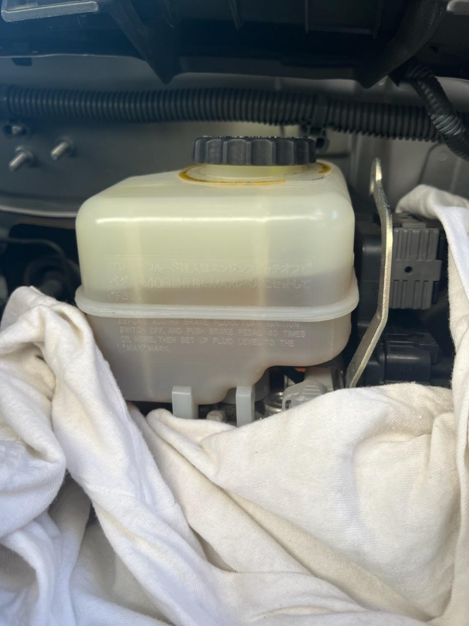

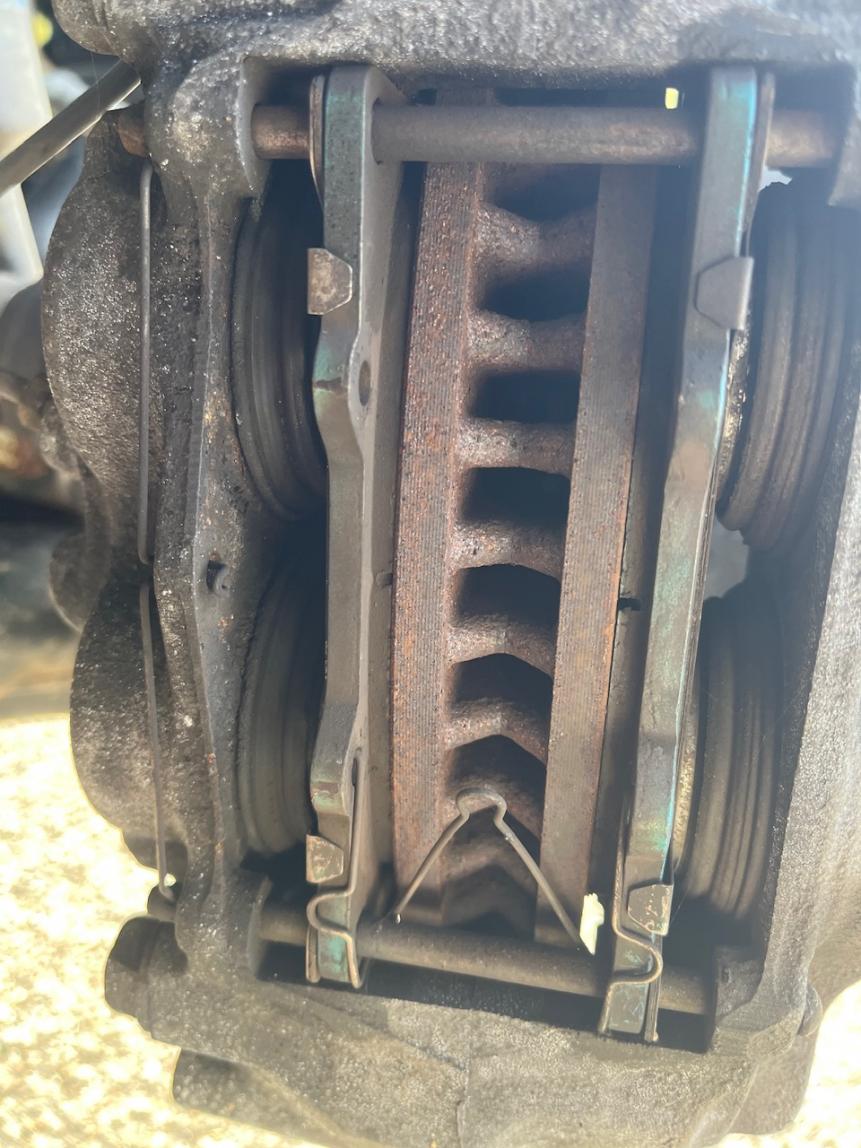

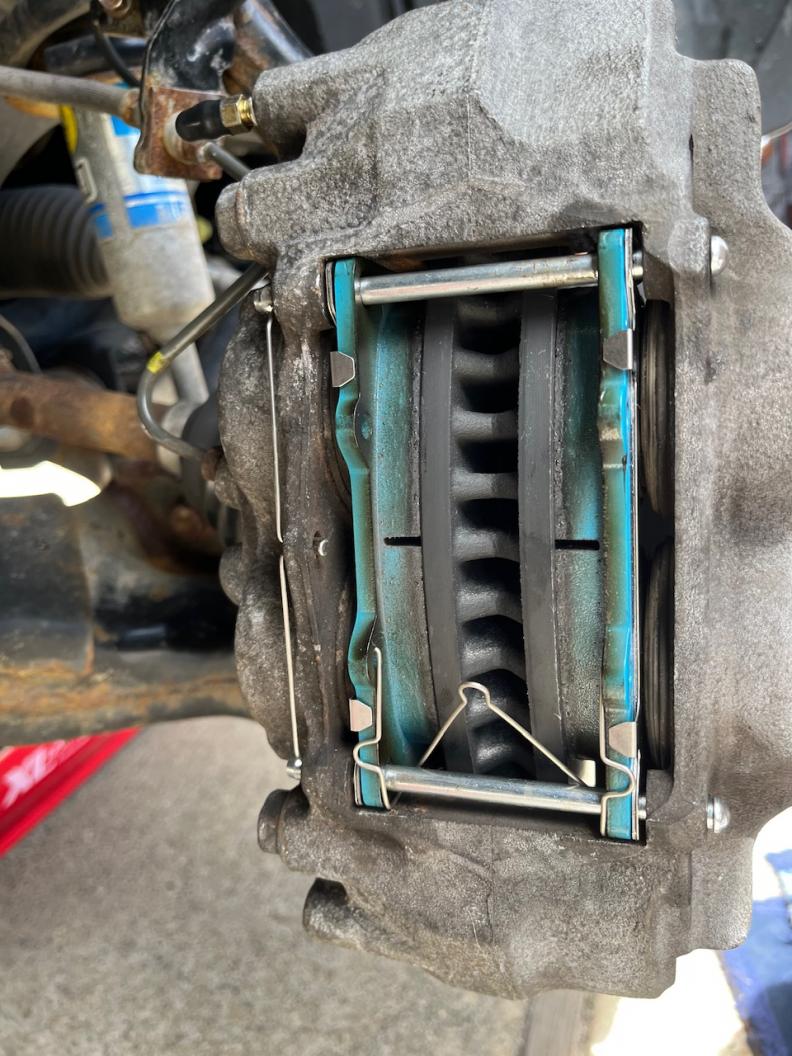

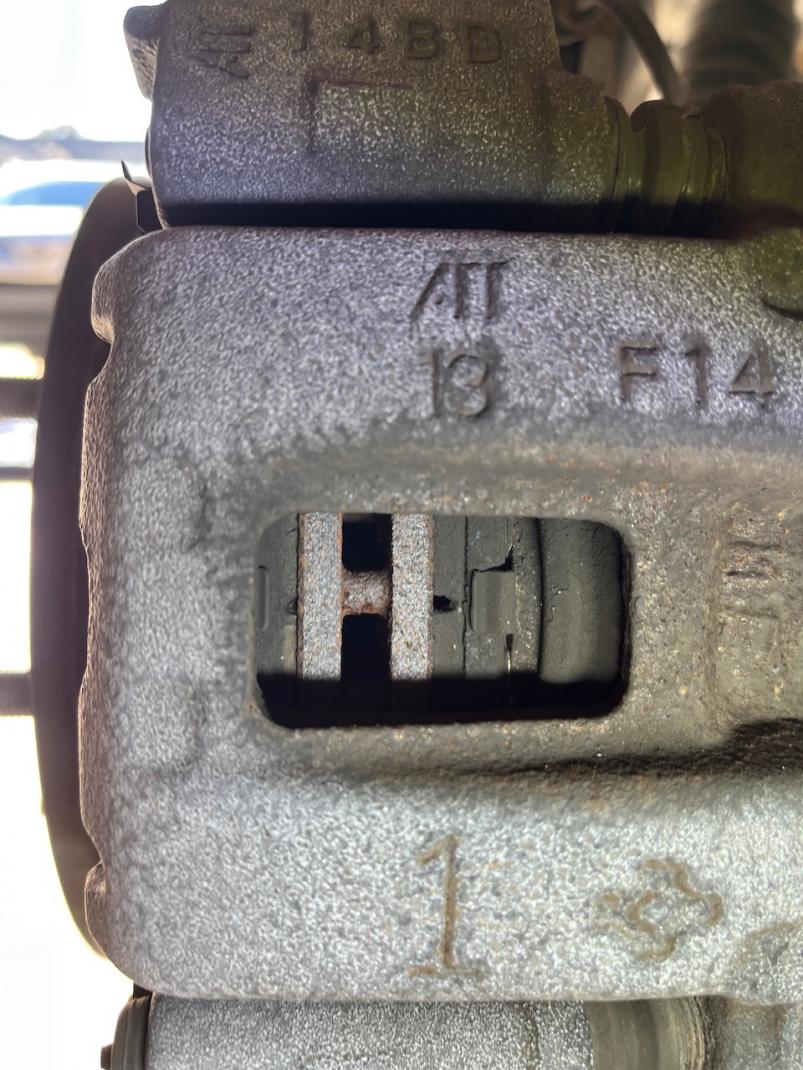

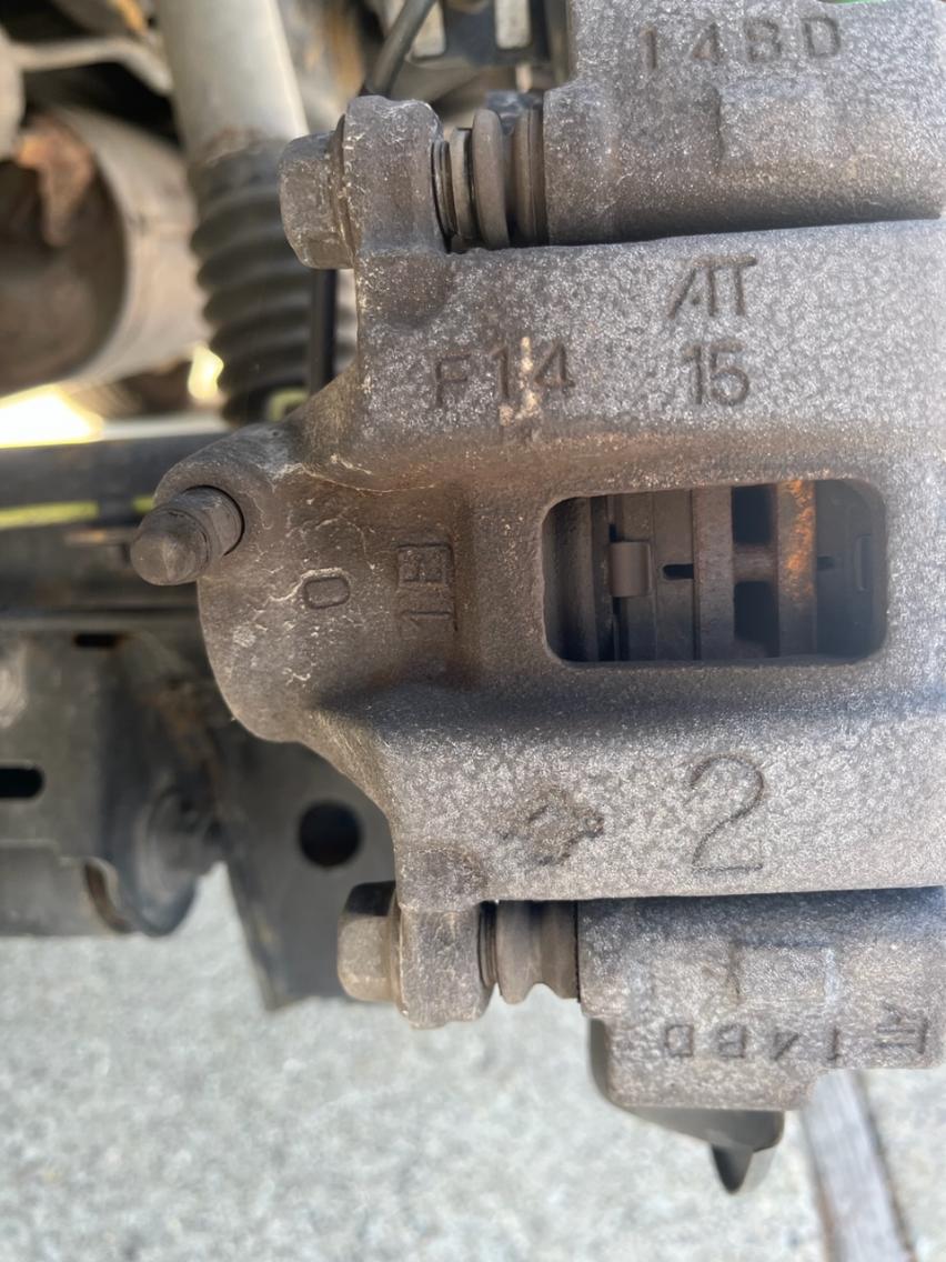

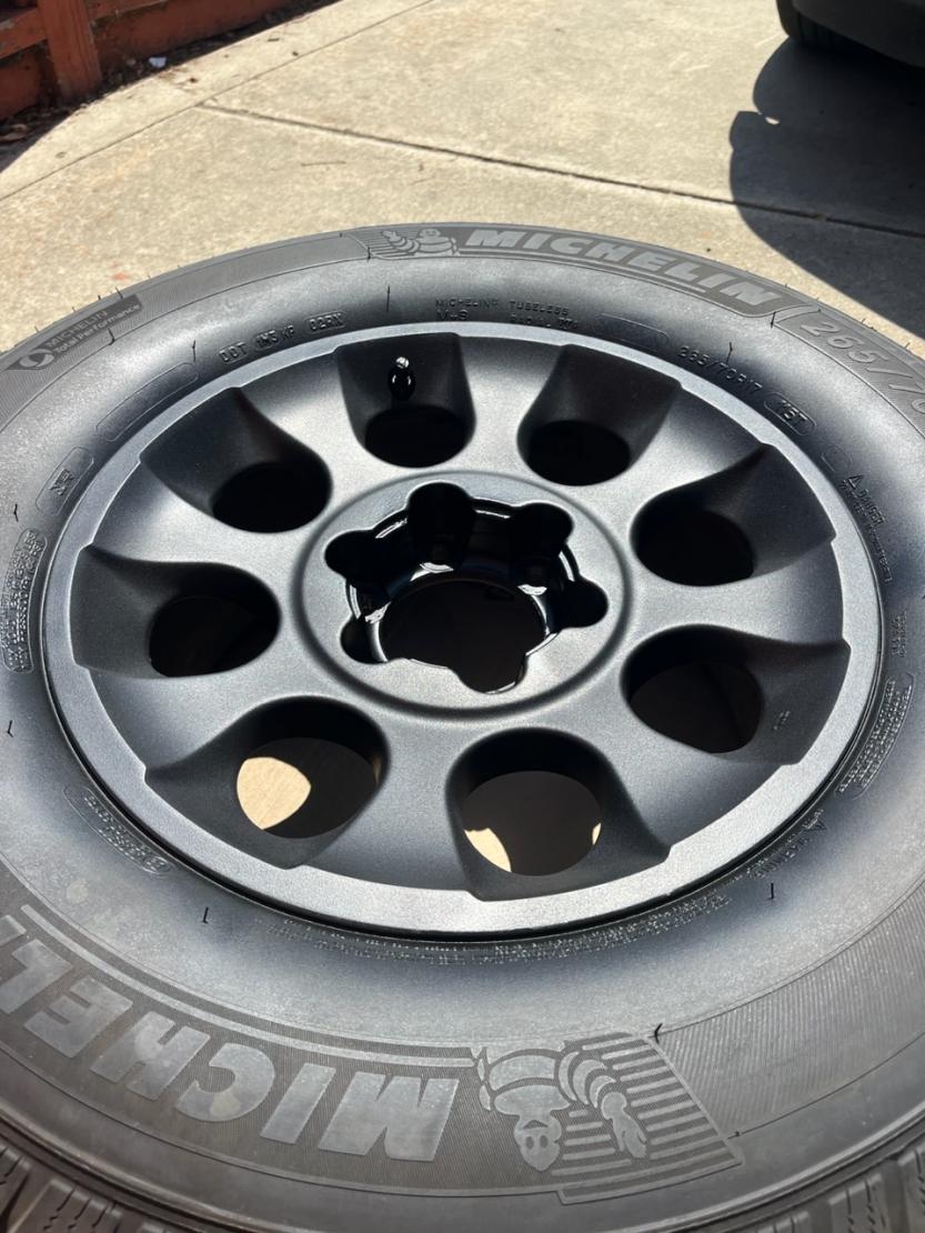

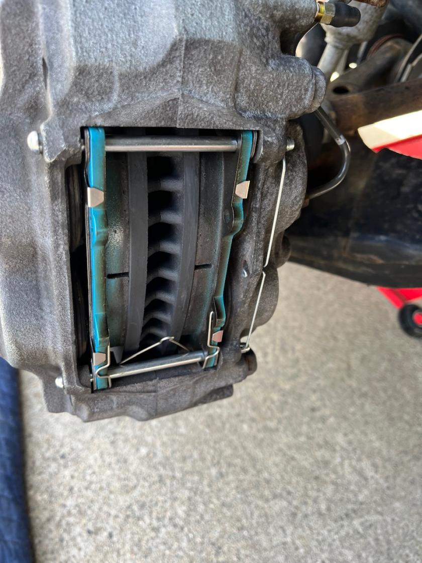

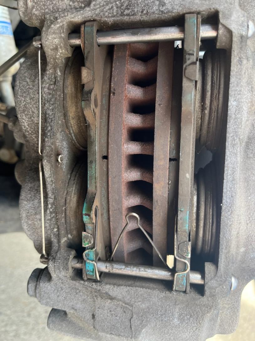

I’m now at 135k miles on my 2010 Trail, time for a tire rotation, wheel bearing check, brake pad check, caliper pin cleaning, and brake fluid flush. I also cleaned and resprayed my plasti-dipped wheels while I was waiting for gravity bleed to do it’s thing.
This time I pulled out my calipers and measured the front pads: 4.95mm for the inboard pads and 5.21mm for the outboards. Front disc minimum allowed thickness is 29mm, I’m seeing 31.95mm on the right front disc. I’ve been heavy on brakes for the past year so I thought they were getting close, but not this year I guess.

Got 130K on mine and still had life left in them.
Unfortunately, my original wheel bearing on the driver side rear wheel went out so I replaced both rear wheel bearings and replaced both rear wheel discs and pads just because.
I still have 3mm left on the front pads after 130K miles on original pads and discs.

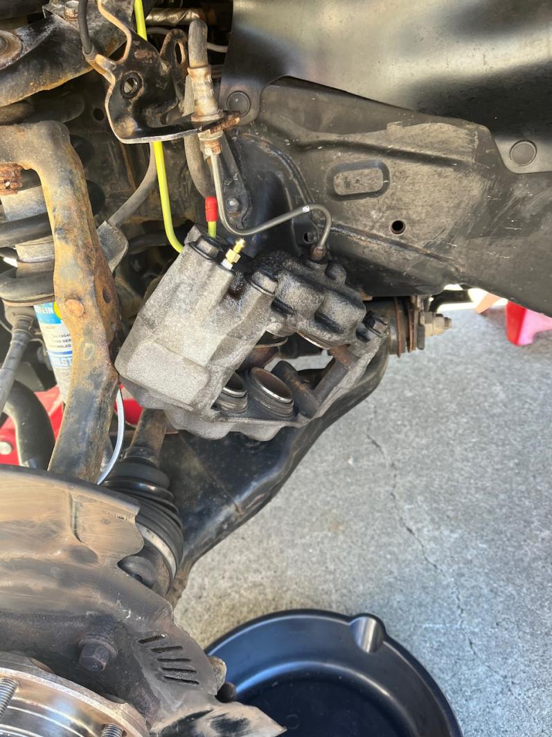

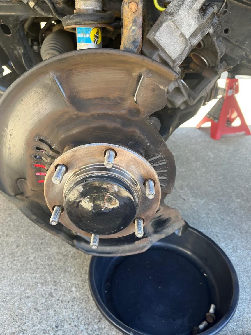

Checked my brakes again today during rotation. 146,434 miles.
Was thinking I would replace this coming summer but probably go another year.
Also thinking I’ll replace all four discs after all.

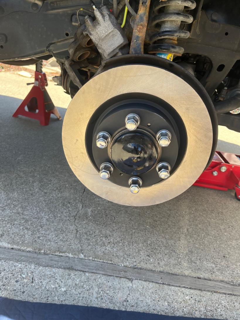

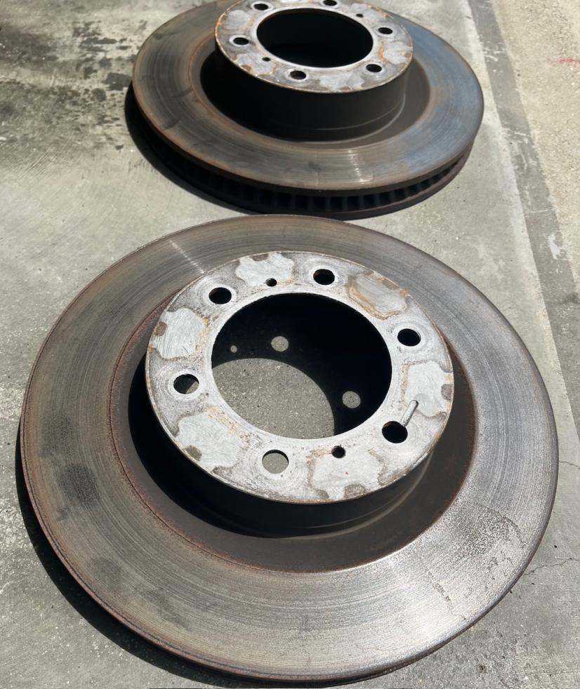

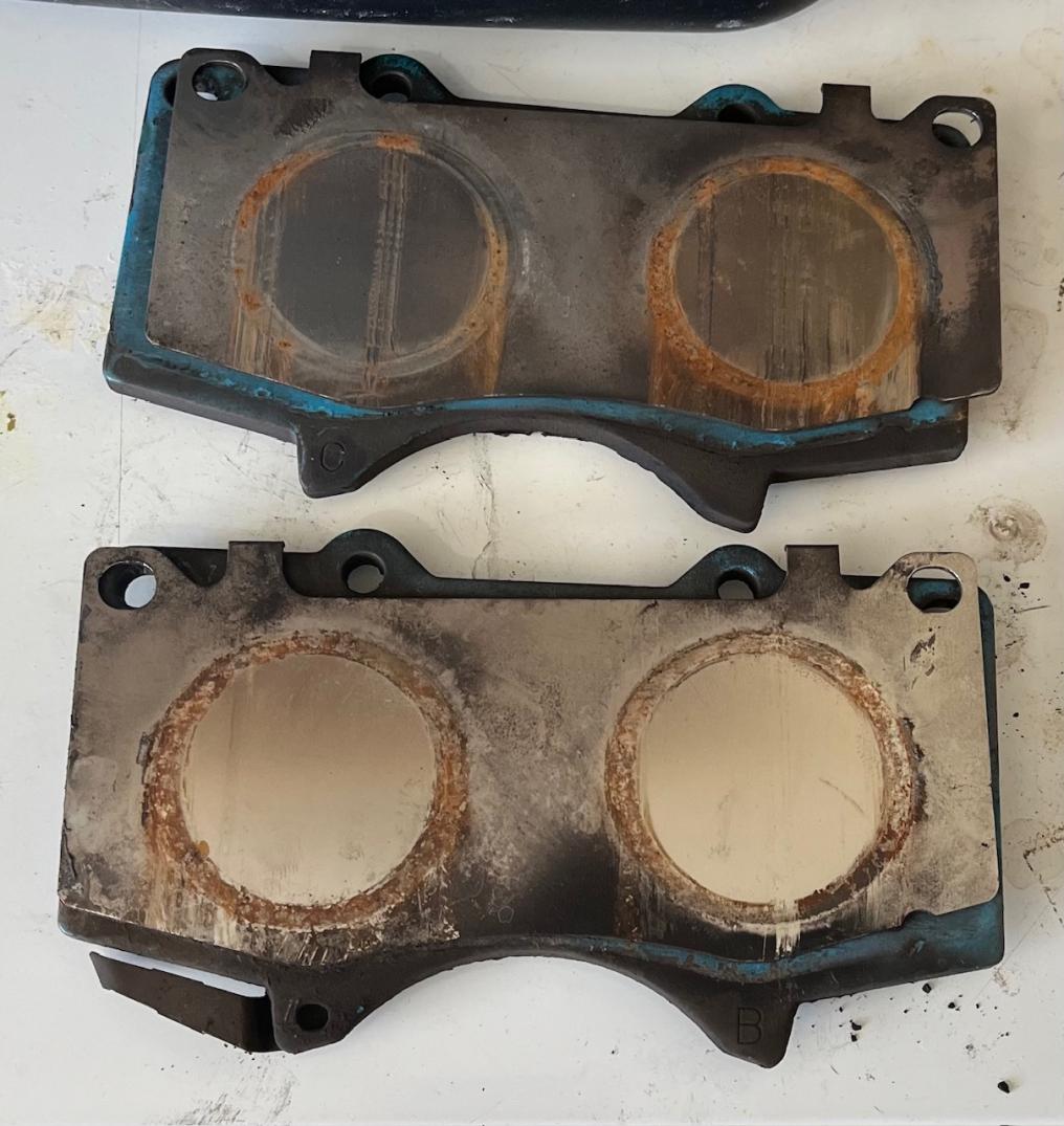

153,600 miles. Today was the day!
Replaced the Front rotors, pads, shims, and pins.

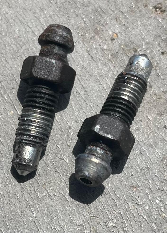

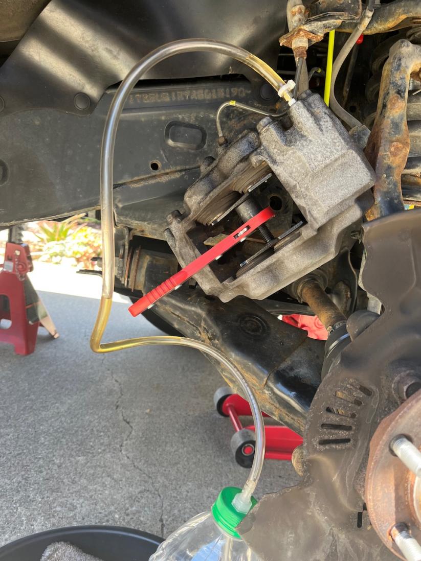

I also replaced the bleeders with speedbleeders.
A little more rust than I would prefer but I had no problems removing the caliper bolts, bracket bolts, or rotors.
Speed Bleeders:
Front: SB7100 (7mm x 1.0)
Rear: SB1010 (10mm x 1.0)

OP [MENTION=53327]1000MPH[/MENTION]:
Colour me inspired!
You achieved phenomenol pad-life, and maintained diligently along the way.
OUTSTANDING!

I put 1000 miles on the new front pads and rotors last week. A couple long downhills where I could get on them hard and one panic stop early on in the trip. Brakes are great. Shoulda replaced them sooner for improved pedal feel and perceivably better performance.

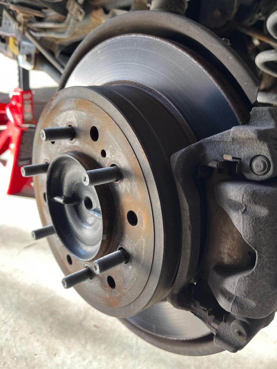

Checked my brakes again during a regular tire rotation.
4,000 miles in the new front pads and rotors. 157,500 on the original rears. Slight discoloration on the new rotors but nothing grooves. Pins move freely, no squealing. The new brakes work great so far.
Will definitely be changing the rear pads and rotors in the next few months.

Our 2018 TRD-ORP needs new REAR brakes only at 130k. I thought it was strange the fronts still have at least 50% left but the rears are done. We do carry a lot of cargo in the back. That must be why. Anybody else seeing this behavoir?
Everybody else sees this.
4Runners go through rear brake pads much (much!) more quickly than fronts. If you have fronts wearing faster, check your rear slide-pins ...
