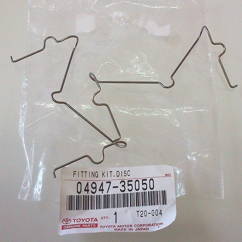

I got this fit kit
Part number 04947-35050
"FITTING KIT" for the front and I'll use the OEM shims on rear brakes after I install new caliper . I'll post up how it goes
they don't have these springs for rear brakes
i guess shims must be enough to fix this annoying noisew

Yea, they're really easy. I'll pickup another set and add them to the top. I tried finding pics on the forums but no luck. I'll post some pics tomorrow or Friday.
Before doing anything to the rear do the front first and see if it fixes the noise. If the rear is rattling you might want to check that the pads didn't require the metal shims. I know the ones i got had them embedded in the pads (similar to picture below). Not only that, the pads were very tight in the rear calipers for me too, so i don't think they'd be making noise.
You can get the springs at advance auto, OReilly, etc for three bucks a pair.
You could, however, the tension provided with the auto store parts does not prevent rattling, however, the Toyota OEM ones will prevent rattling since they provide more tension from the clips. Trust me, I bought both. Go with OEM.
I just replaced these on my front brakes. The noise was really bad, I had never replaced them in 200k miles. Got two sets for the front (top & bottom). The noise is completely gone now.

my front calipers rotors and pads are new . about 130000km on them . They were replaced by previous owner at toyota dealership . they rattling bad so that's i decided to put these springs . I'll post up after this weekend how it goes
I really recommend these anti rattle springs ! my brakes are quiet , no more weird rattling ! I put one on each side . works well .
Also installed new rear calipers on rear . 4runner is smooth and quite again . love it !
