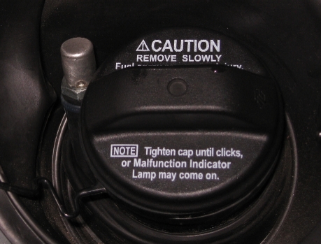

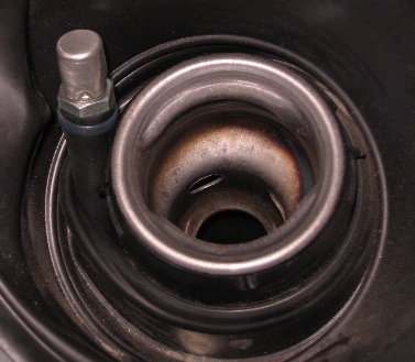

I just did the mod today and there is no worry about gas getting in. Just look at the photos. You can put the breather back in the left corner away from the cap and well above the bottom of the door opening.

I just did my breather mod this morning using both of the parts that have been listed several times. The breather was diff but a breather is a breather right? anyway I just ran mine up to the gas filler but didn't poke it through like some I just secured it to the fuel line running down to the tank. So if I ever trade it in Nobody is asking any crazy questions about the breather sticking through the gas door.

Yup, in my opinion, this is a better location than the typical gas filler location.
I check my cap each time I get gas. I wouldn't be able to do that is it's tucked in my rear light cavity.
But, why do you need to check it so often?? Since either location is away from mud/water, there is no need to check it much at all. Do you check the breathers for your front diff, transfer case, and auto tranny everytime you put gas in your truck?
I just don't like the gas cap location much because one can spill gasoline on the area often (i almost inevitably spill gasoline around the area everytime i put gas in my cars)...although this may not damage anything, but i wonder if the gasoline may rot the plastic tube over the long haul????
