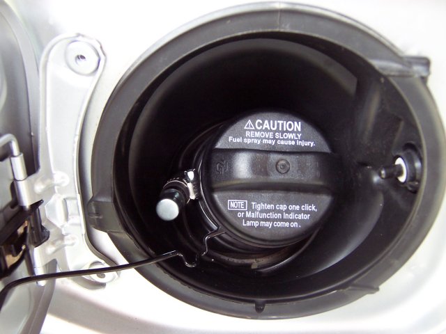

Thanks Thai and Lance. Here's a pic of the new breather location.

I'm going by memory ... See the do-hicky to the left of my gas cap? That's what you're looking for.
Open your hood. Stand on the drivers side mid-span of your fender. Peer in engine bay ... about 1 foot in, between engine and the brake fluid compartment (I think), you should see the same device sticking up.

Still, I don't expect any issues with the location I chose as the cap is higher than the gas tank nozzle so any spillage will go down, and it's mounted in such a way that the cap moves freely and unobstructed. Dirt is also not a concern since inside the gas cover is 100% cleaner that on top of the diff, the original location.
Puzzled and curious full-serve gas attendants are told that it's a sensor for would be gas thieves. :)
