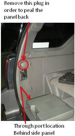

Would you mind posting a picture of the rubber stoppers you went through, I think I know one of the ones underneath but I'm not sure how there are two to go through? I've been wanting to move mine from the gas cap inside like yours.
You need to remove the pad-eye on the driver side, and the plastic panel to gain access to one of the through holes, You will have to remove the rear floor panel and plug for the ability to peel the side panel off. You should see the port on the frame.
If you go below your vehicle and look behind the rear driver wheel well you will see two through ports with soft plastic caps, you may need to look for a little but they are pretty easy to see. check attached photo for plug location, sorry didn't take any photos at time of install :bash:

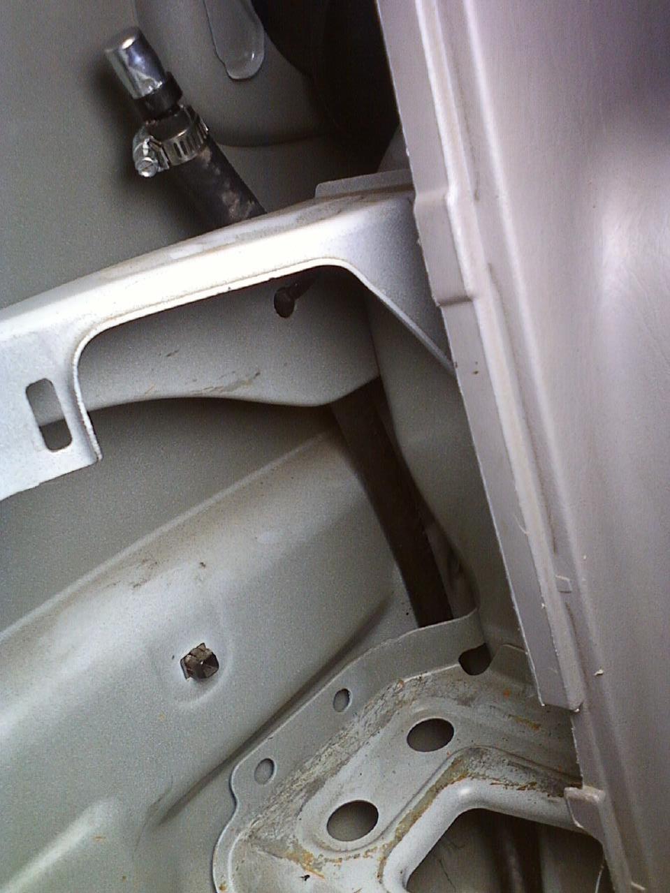

I will replace the breather cap with one of those miniature air filters so air can move freely in an out as needed. I also didn't want to leave a big open hole under the body to accumulate water and grime so I cut holes in the two grommets that I went through and snaked the hose through. Pretty happy with the results.
Hope these pics help anyone who might want to do this. Thanks for all of the tips and info!!
