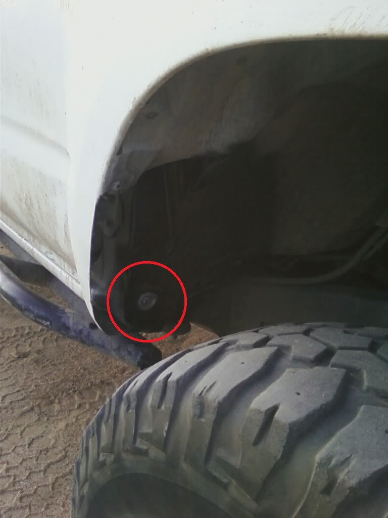

Hey Brian, quick question regarding the pounding you did on your firewall to fit 35s. The circle I have marked below is where I'm getting my rubbing when I stuff and turn the wheel, did you do any pounding on that exact spot or did you do more to the upper right? The area I have marked is where I see most people cut out and weld a new flat piece of metal, but I don't have access to that.
Yes I pounded the holy crap outta that spot with a large sledge (the "circle"/hole in the pic is a plastic plug that I removed and put back in when I was done). I'm a big dude and I hit it many times as hard as I could to get it to cave in enough to the point where I don't rub. I also pounded that whole area in the photo where it's darker (I later shot it with black spray paint afterwards so that's why that area is darker in the pic). All in all, I would say I pounded in that entire area about 1-1.5" in.
One thing to be careful of.. your ABS module is right behind that area on the pass side. You'll want to remove the lower interior trim pieces by your feet (on both drivers' and pass. sides), and then remove the ABS control (pass side behind the trim piece) so you don't damage it. Then you can reinstall it all when you're done pounding. I also had to cut some material off the lower corners of the plastic interior trim pieces on both sides because I pounded it in so much that they didn't fit anymore.
Also the easiest way to check the clearance is to remove the whole strut and put a jack under the front LCA. Remove the tire, pound, put the tire back on (with just one lug), raise the jack so the tire is fully stuffed and cycle the steering wheel. Then repeat as necessary until it doesn't rub when fully stuffed. Once you do the first side, you'll know about what you'll need to do on the other side, so you won't need to keep taking the tire on and off to check it as many times.
Sounds great. I think ill give this a try today. If I did remove the strut I would need to have an alignment done though right?
