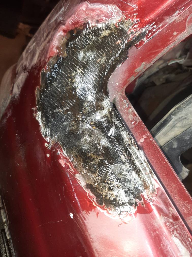

Slowly making progress on my hatch. I decided to try the fiberglass with cloth over the holes. Then do the inside as well. Then filling in the dura glass body filler. As filler can't take water with this being heavy water area I see how it turns out. Can always glaze fill or plastic for a top coat. Then just touch paint on top...:)

Seems like a good call on the repair as should hold up well and look very presentable once completed and painted.
Well done:cheers:
There are additives to add to the resin to make it more sandable.
Interesting... The fiberglass cloth is the base. Then I have dura glass body filler so I see how sandable it is. I believe it sands down very well...:)

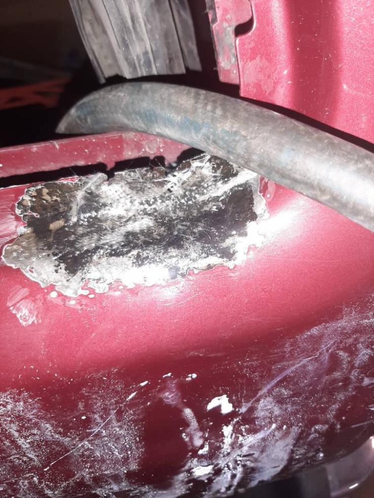

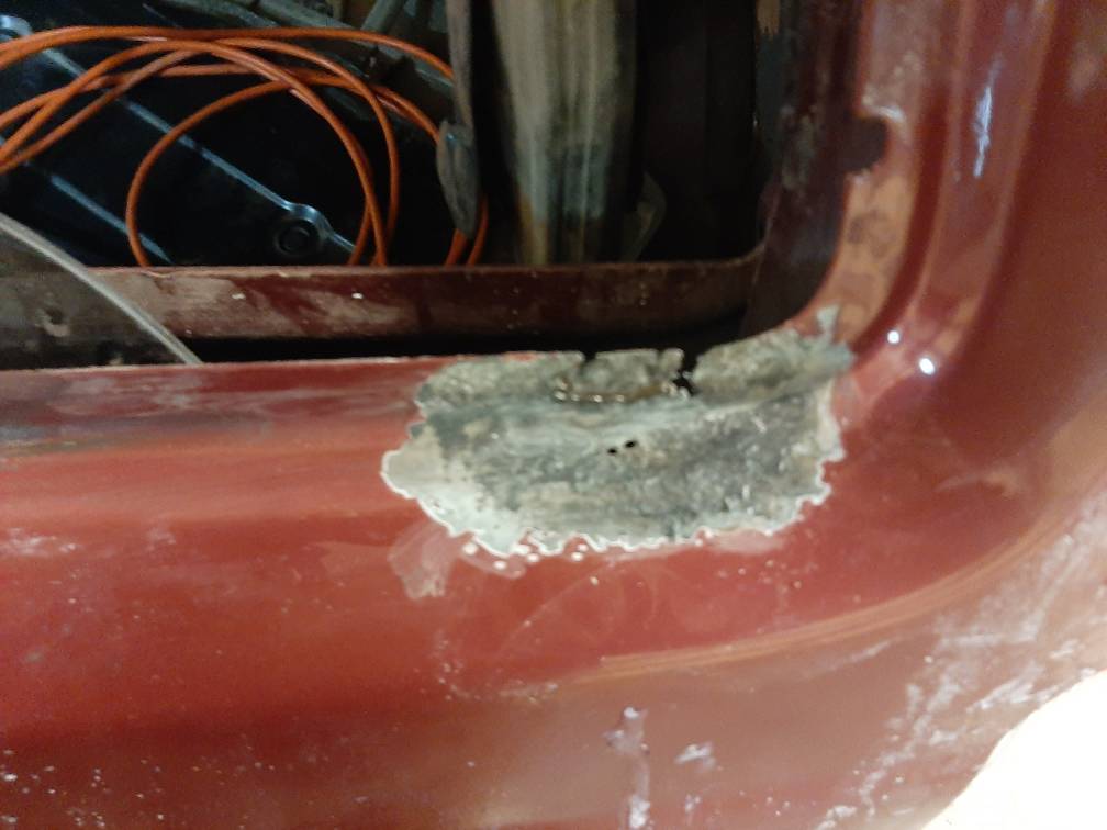

Started sanding the Glass down. Driver side coming nicely. Just a lot more sanding to do. The passenger side. I may just redo. I am not sure if I got it clean enough. So I am debating just to glass it or rip it down and start over.

Unless it's clean/rust free it will just show up again in weeks and piss you off for not taking care of it the first time. My 2 cents. :-)
Well I thought I had it clean. But my instincts are telling me I better do that side again. Granted I am going to patch the inside too. It can't come through the glass.. However, the glass can come off the steel. :)
