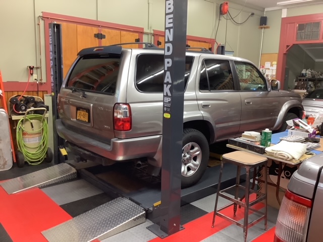

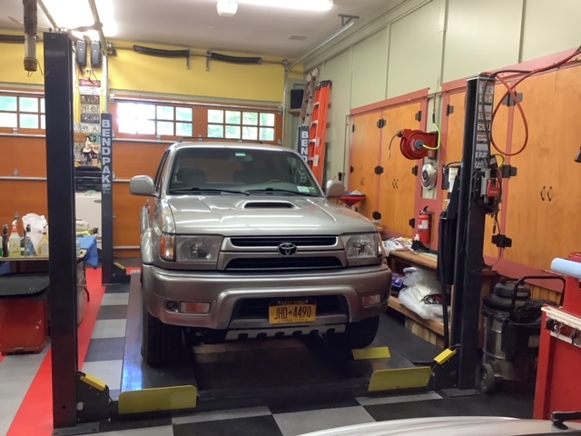

But…….it’s worth all the trouble, love my HD-9!

Whether going 2 post or 4 post, the best part is no more laying on your back on a nasty cold concrete slab!
Having the lift was a game changer for me. The 4post serves me well and with the sliding RJ-45 jack I can pretty much do any needed repairs.
Hoping you get yours soon as it will change your life.
