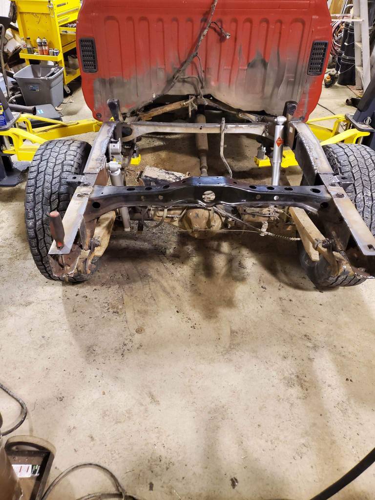

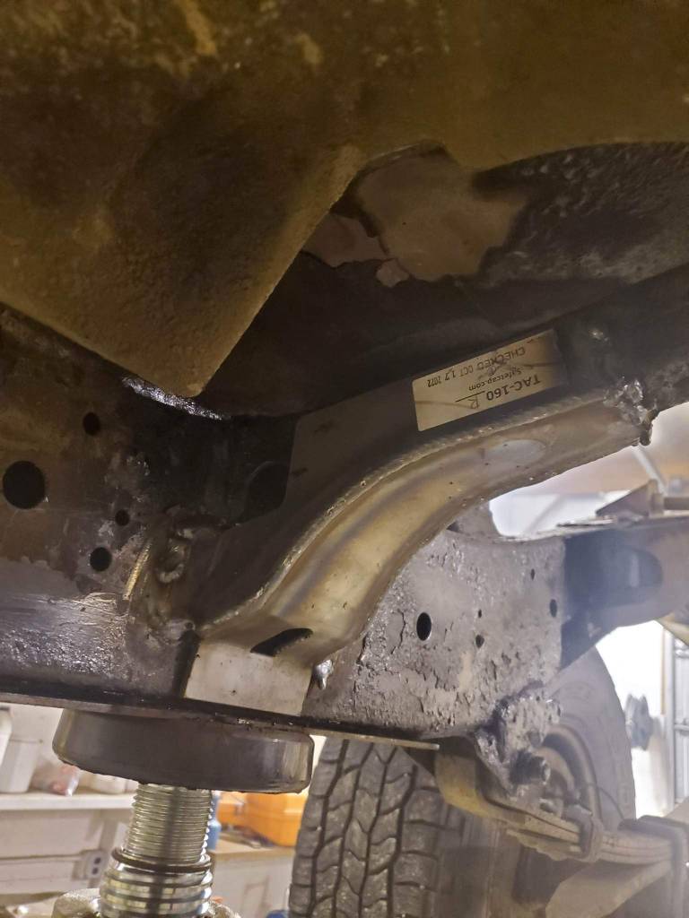

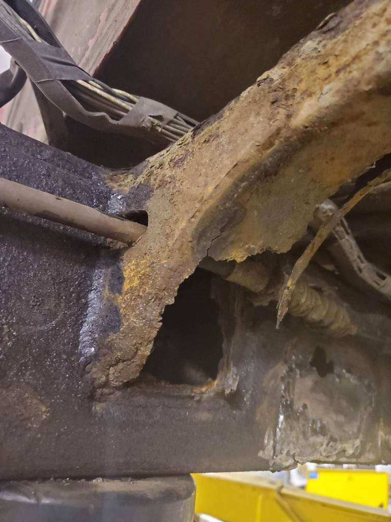

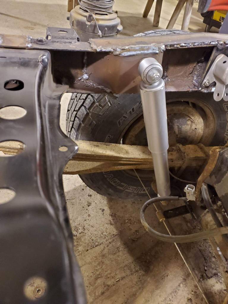

Well, a month later. We got the frame bed section fixed. The first gen Tocuma is the last generation to share frame components with the 3rd gen. The frames are similar, but in the Tocuma, they open to a C channel before the rear arch. We only had 1/2 inch of steel holding both sides. So we couldn't put it on a lift to fix it
Sent from my SM-A536V using Tapatalk
Ended up replacing 2 crossmembers. Safe T caping. The frame to the end of the arch. Rebuilding the 3rd crossmember

Then, finally, the gas tank and evap box going back in. Tank was raptor lined straps painted and greased, and sections of the frame were not only corroseal and kbs sealed to help seal off the steel. This is the first frame rebuild for [MENTION=693474]Yeti2k3[/MENTION]. Teaching him how to weld.
