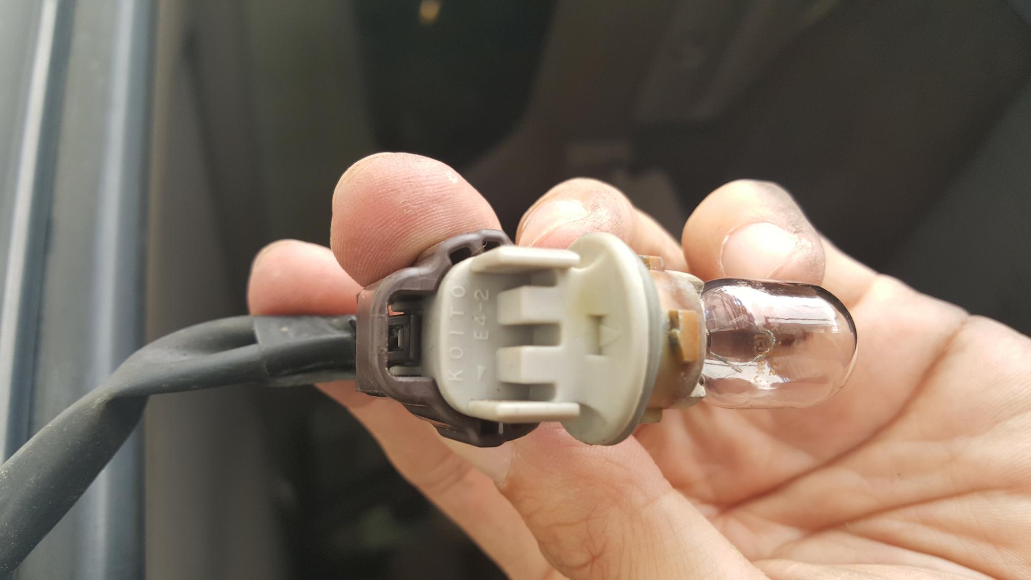

255441d1497129837-tranmission-shifts-weird-but-only-when-only-when-putting-turn-signals-image-5-.jpg
Factory bulb is Koito 18 watt. Just changed my original bulb after 20 years! ANd it was deformed. This bulb being burnt out made my truck shift erratically (triggers torque converter lockup) when puttin the turn signals on in the final drive gear at highway speeds. If this bulb burns out, beware of this.
Bulb

Waking this thread up again. I was testing all lights as of routine maintenance to find the 3rd brake light not working. It seems like mine has been burnt out for years because I have never seen it work so I decided to change the bulb. Following this forum, I put in a 921 Sylvania bulb and it fit..... but was loose and wobbly. I'm going to assume that my connector to the bulb is shot so I will go get one off a scrapped 4Runner for now and see if it works. The old and new bulb is very identical so i'm just confused.
Yes it's a 921 bulb. You may want to try bending the socket contacts with a pick or small screwdriver to tighten up the bulb fit.
I was thinking about doing that but the plastic on mine was all burnt and melted so I headed to the nearest scrapper and scored 2 good connectors. One of them seems to have been replaced at one point which i'm very happy about and overall only paid $1. I did buy the 921 bulb and it's identical.
