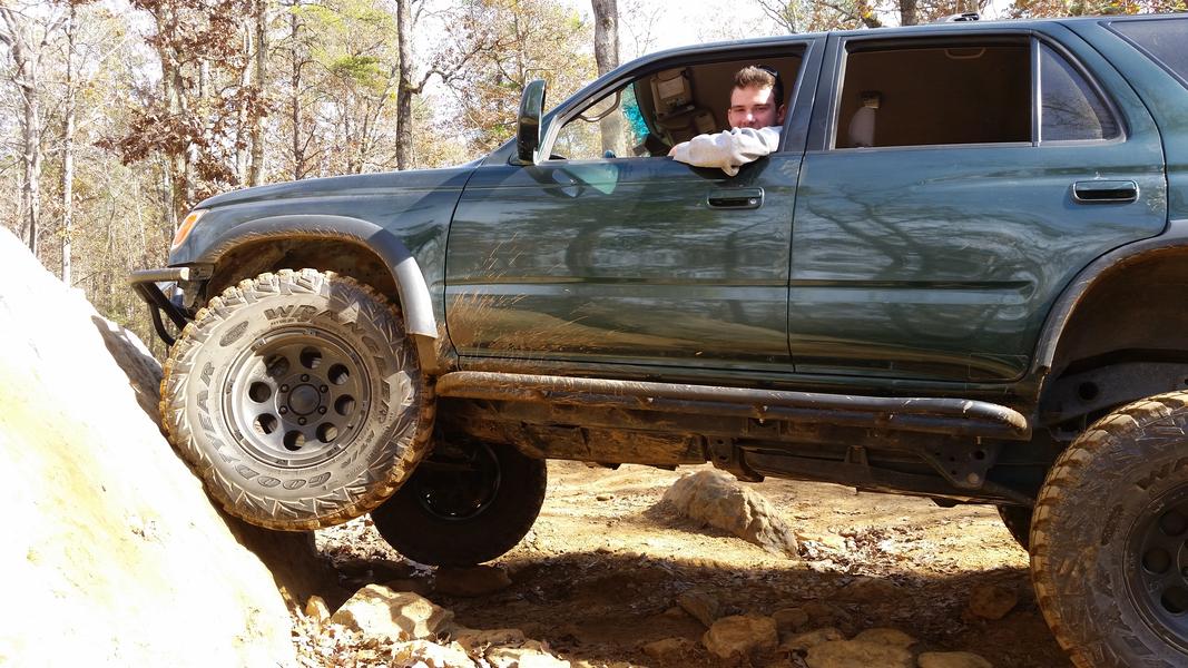

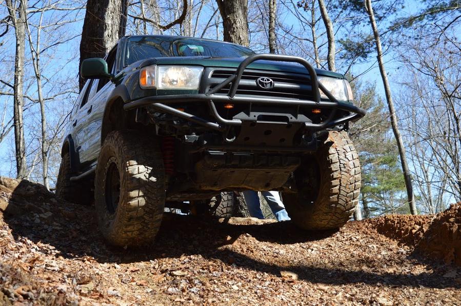

Some pics

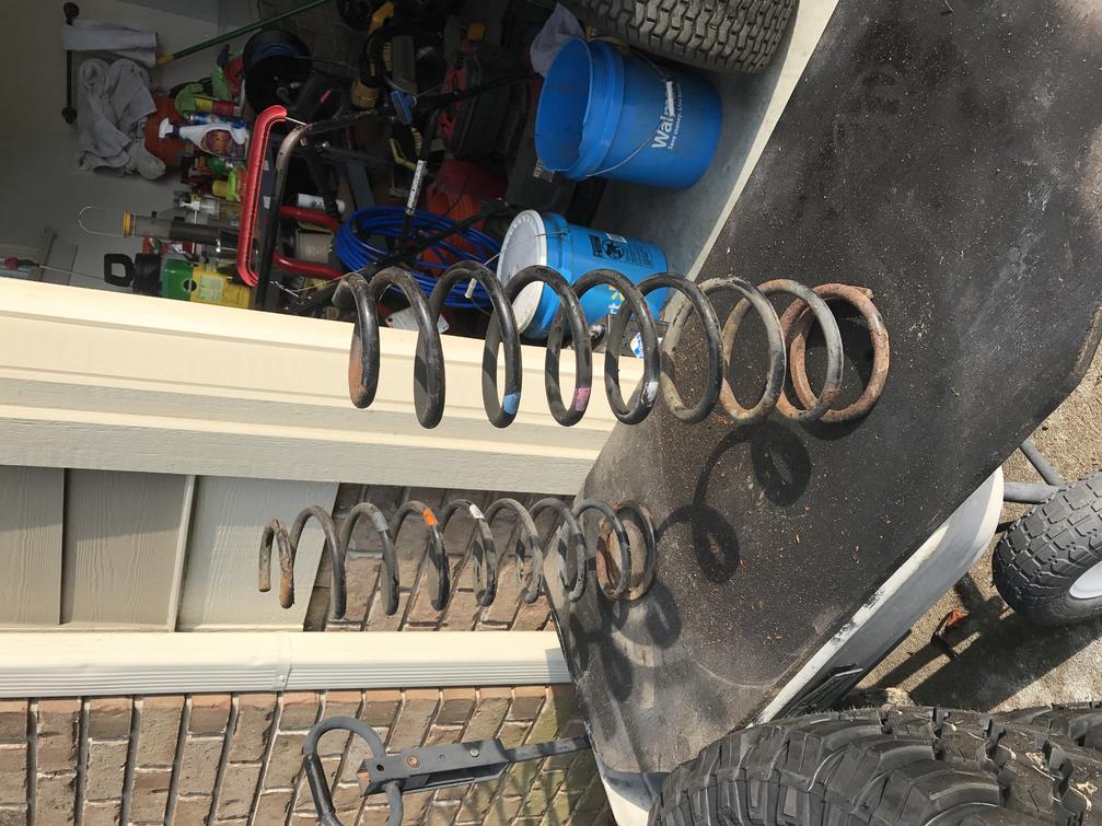

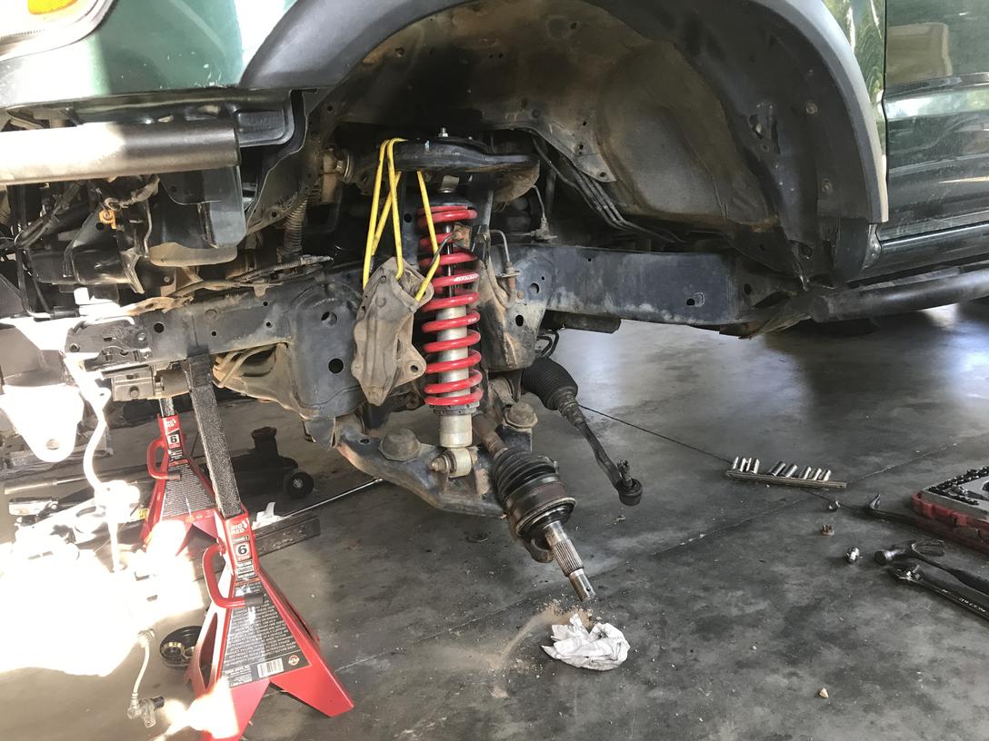

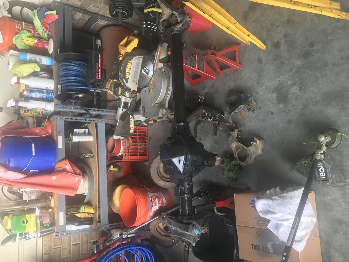

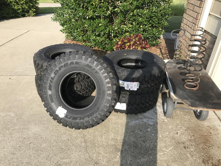

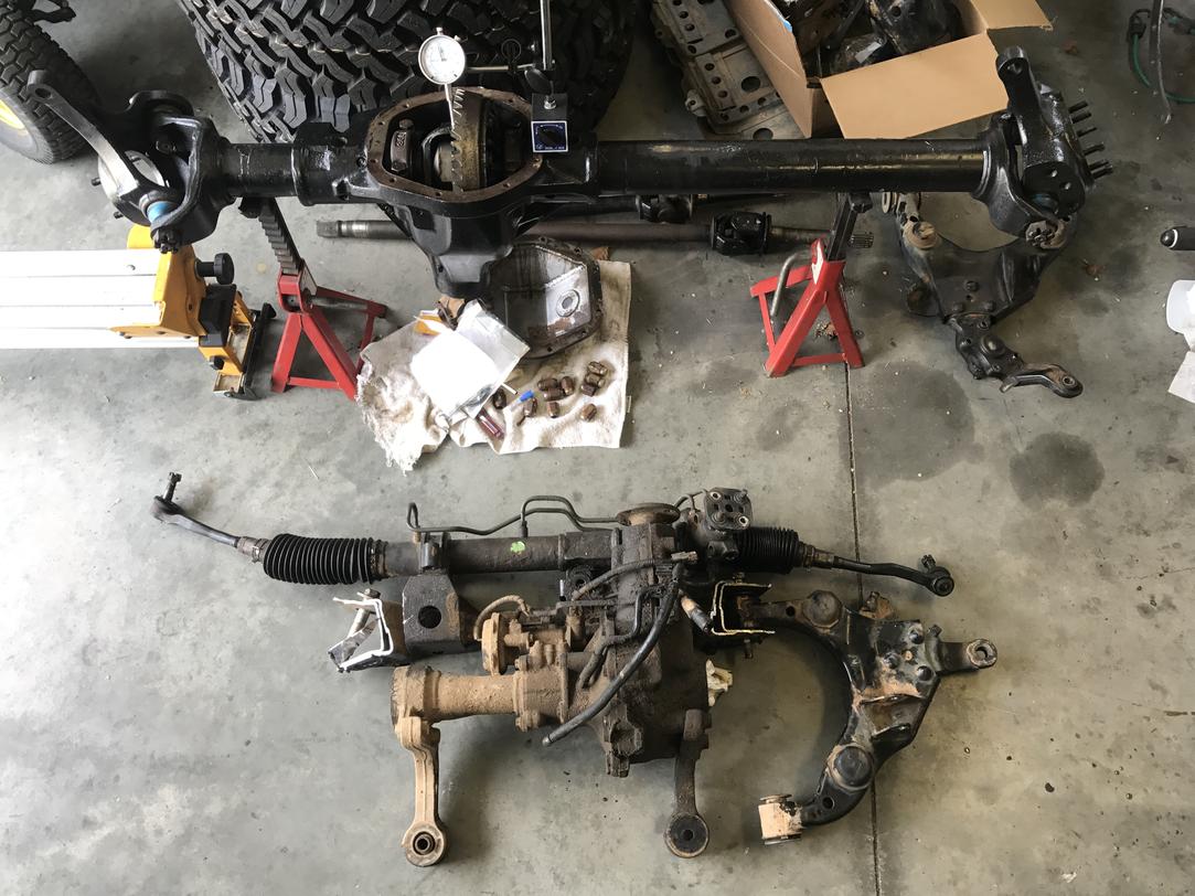

Tires and rear springs are in, just waiting on the SAS kit and new knuckles to show up.

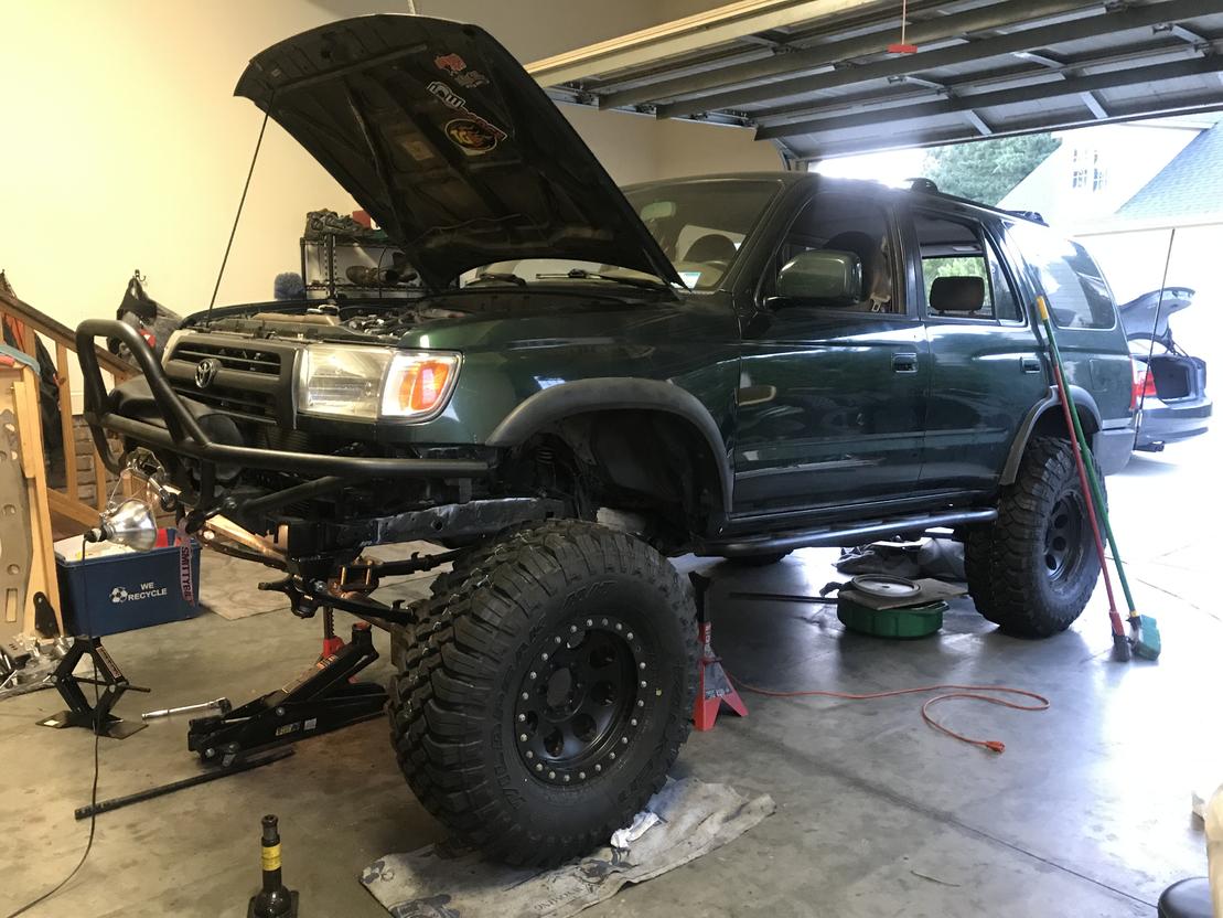

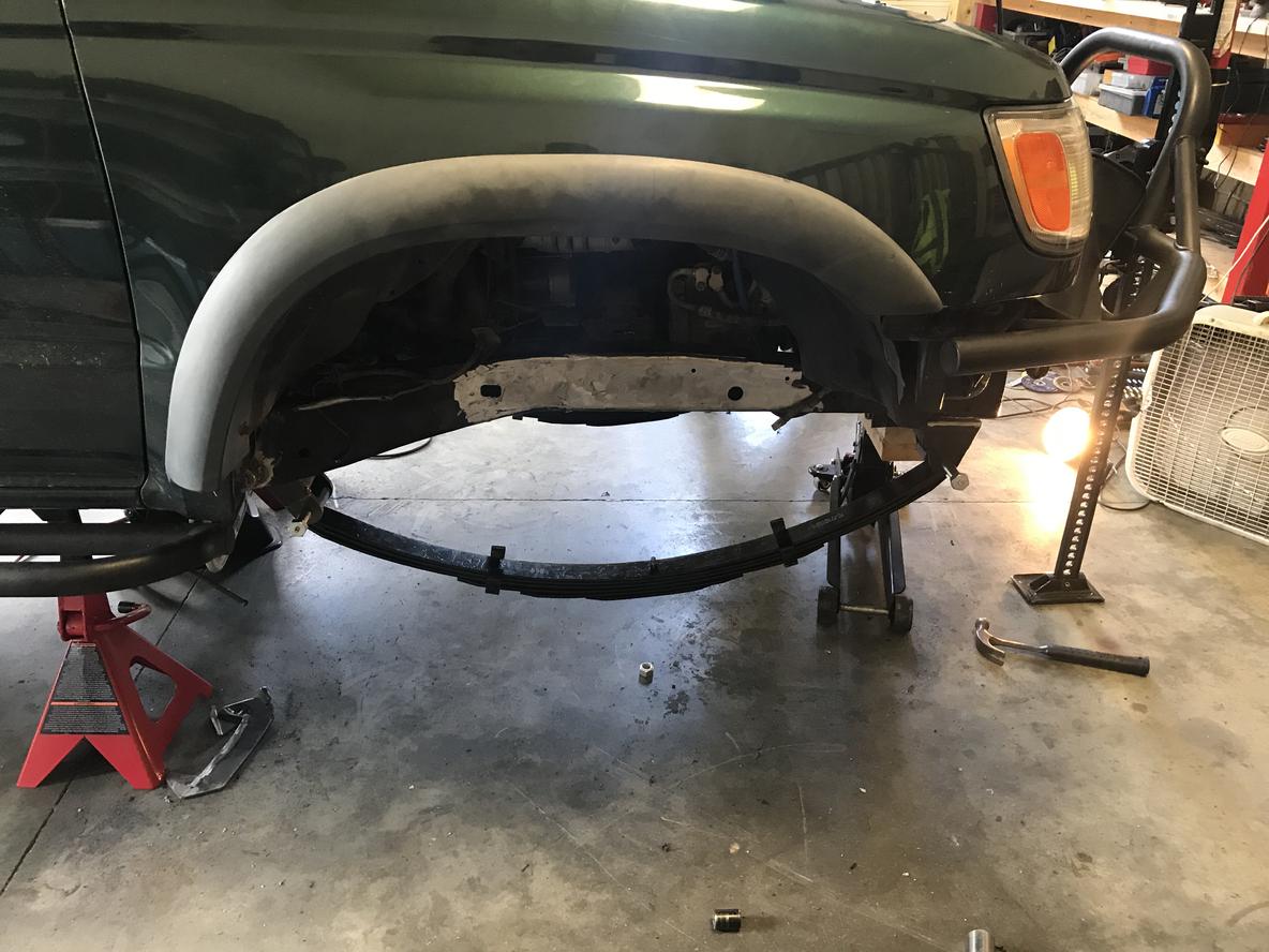

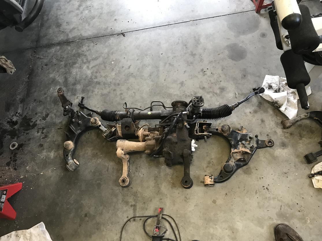

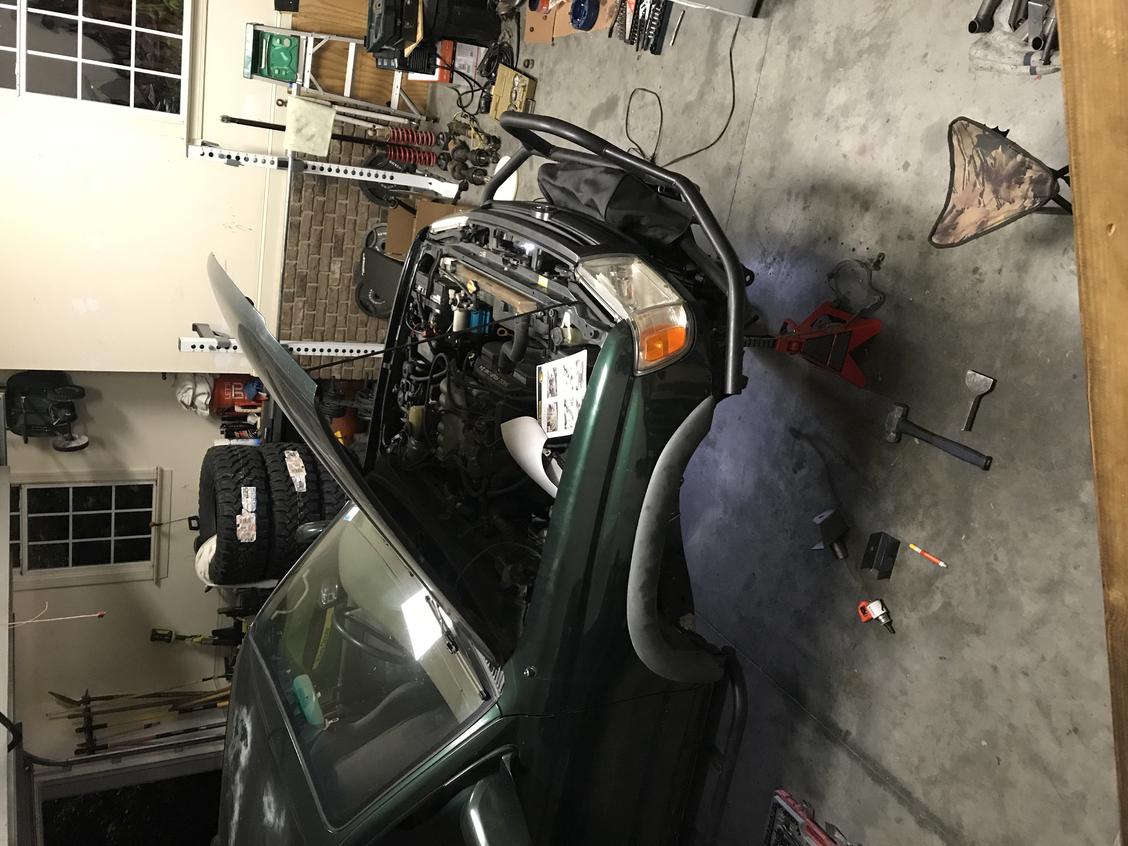

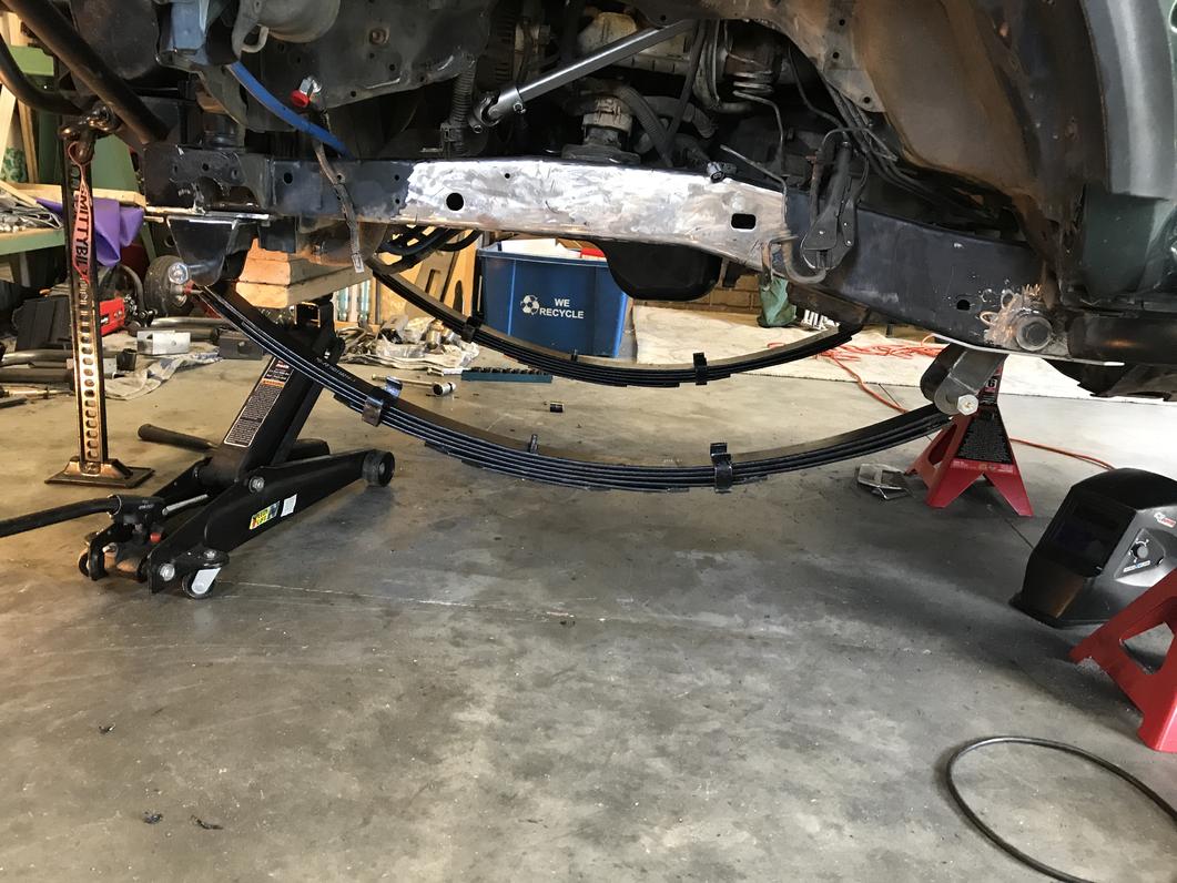

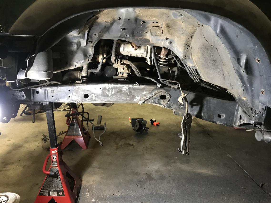

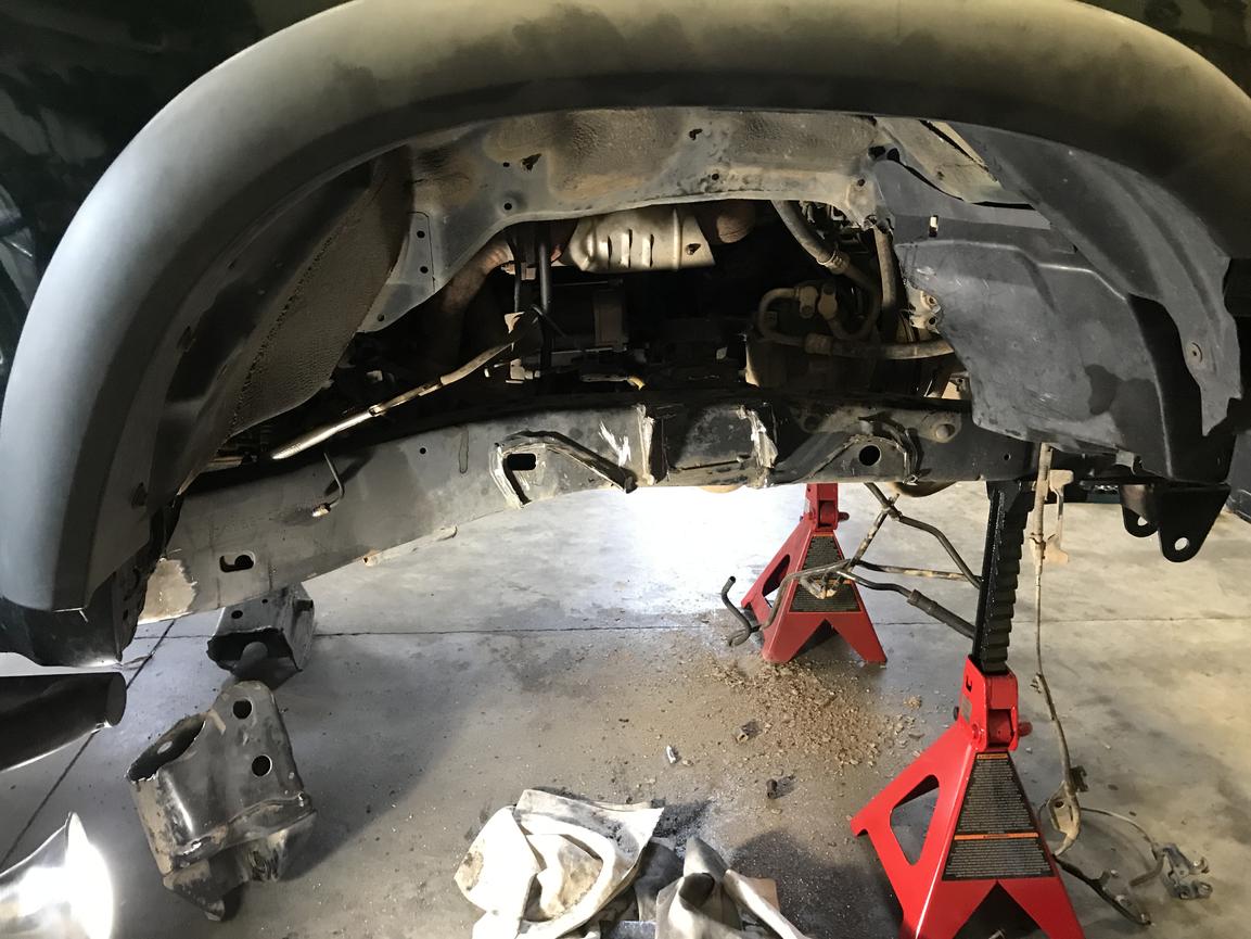

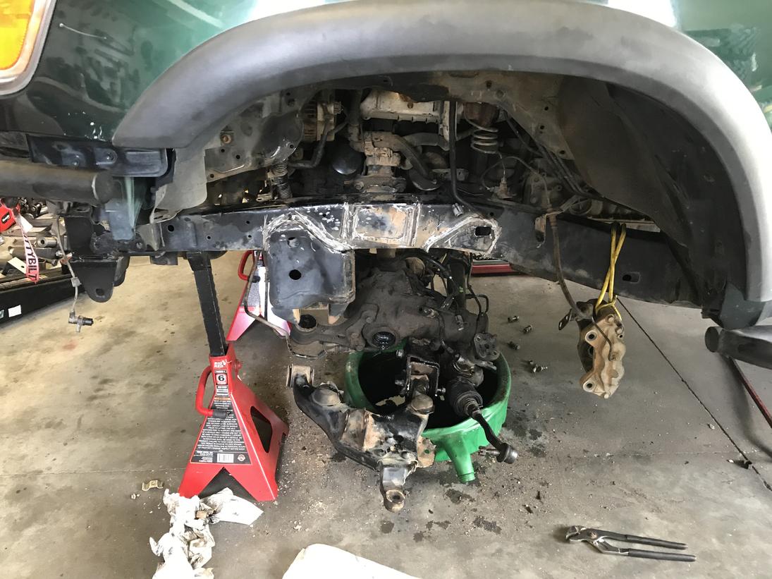

Update:
IFS is gone. Grinding everything smooth and preparing to cut the frame. Up next is welding all the perches/mounts up and then bolting it all in. Also decided to convert the rear to leaf springs so I didnt have to deal with fabing up rear links/messing with rear suspension geometry. Plan is to be done around this time next week.

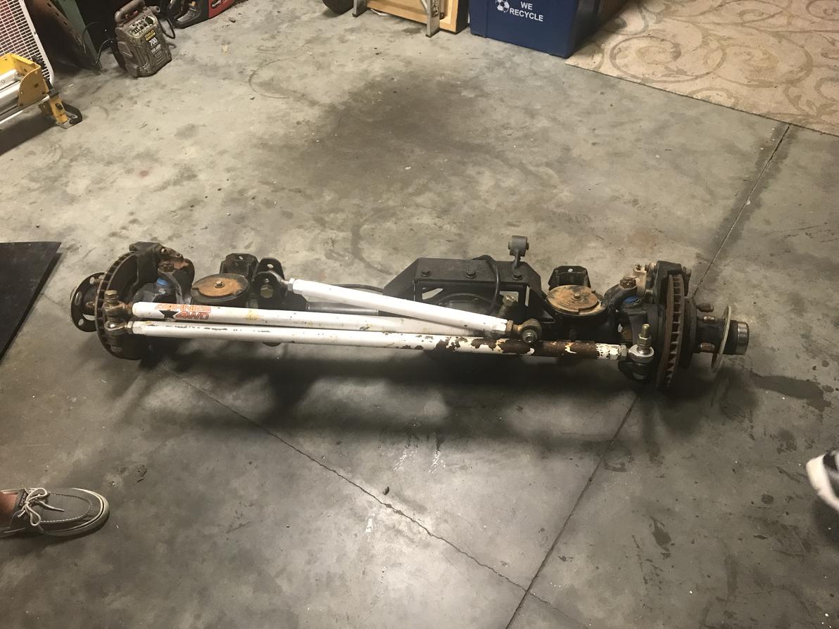

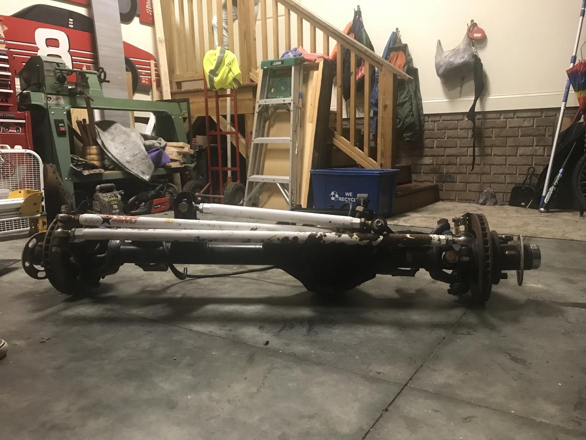

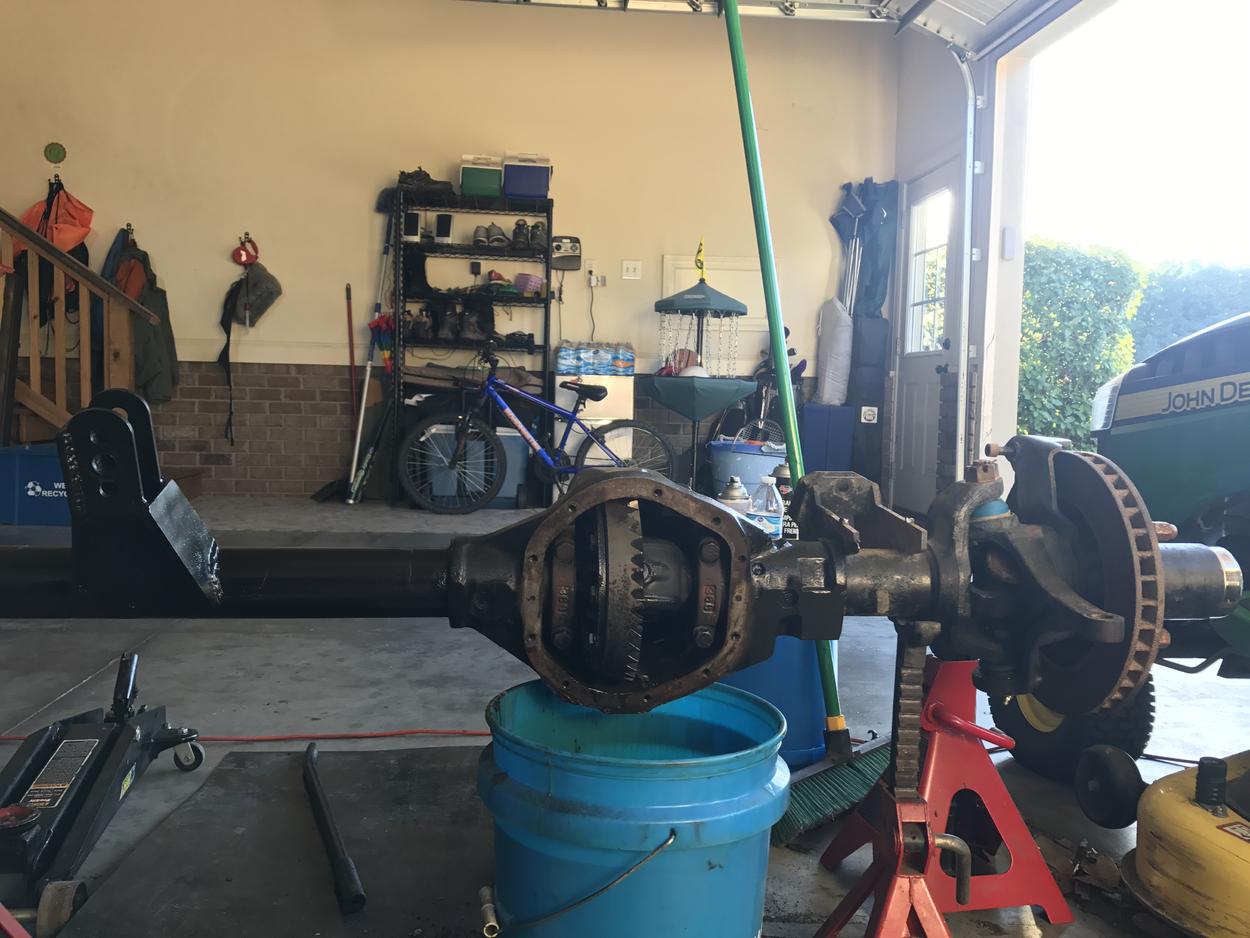

Axle is set, feels like its in the homestretch but still have a lot of work to do. I will be PMing those interested in parts tomorrow!

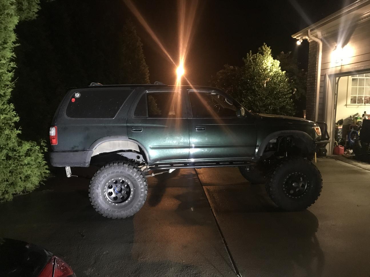

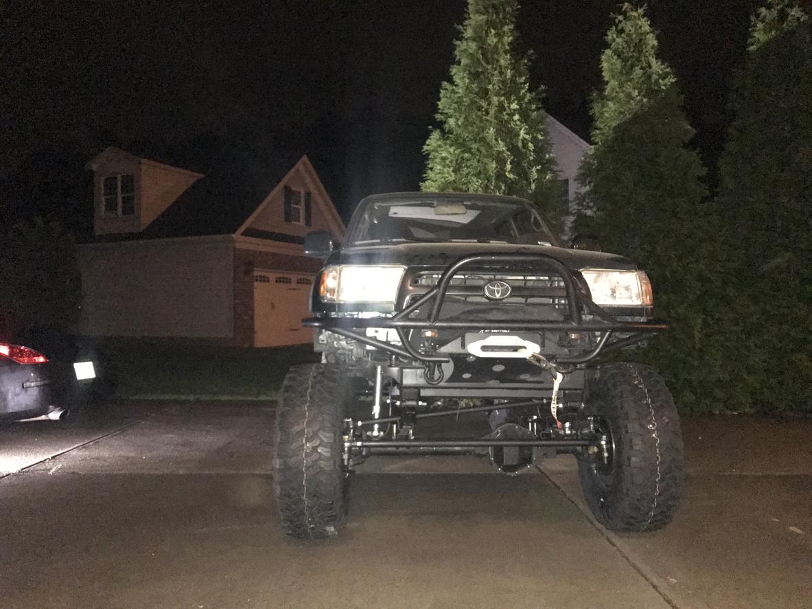

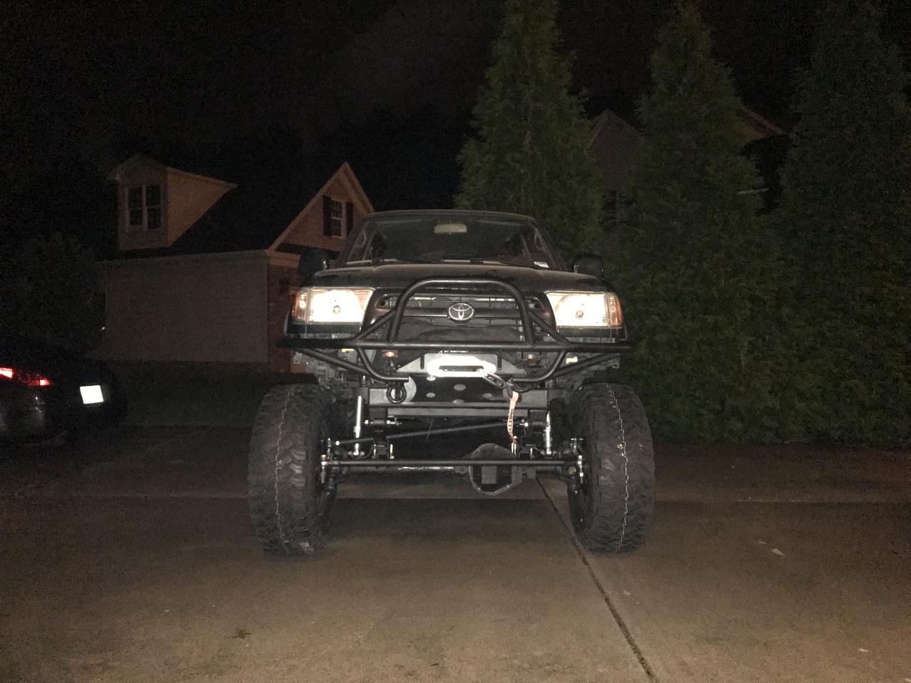

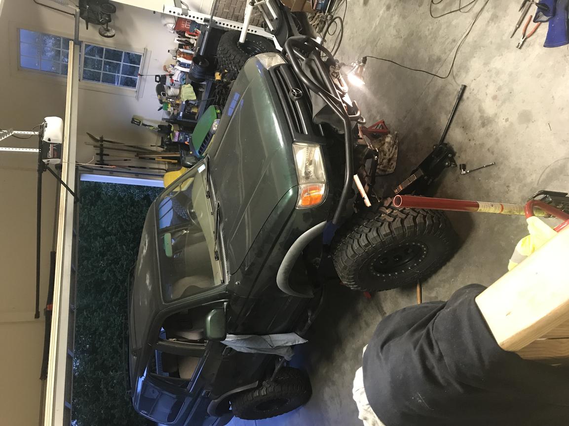

On its own weight now :dancin: just have some minor adjustments to make and she will be ready to drive!
Holy crap that's tall! What's your frame height at the drivers door(from ground to bottom of frame)?
Looking forward to seeing pics of her on the trail stretching her legs! [emoji1598]
That's badass! There is a 3rd gen local here. that has a SAS swap, but using toyota solid axle !
This looks great man!! I remember the first SAS build I saw on a ranger years ago took the dude months to complete. Fast work!
