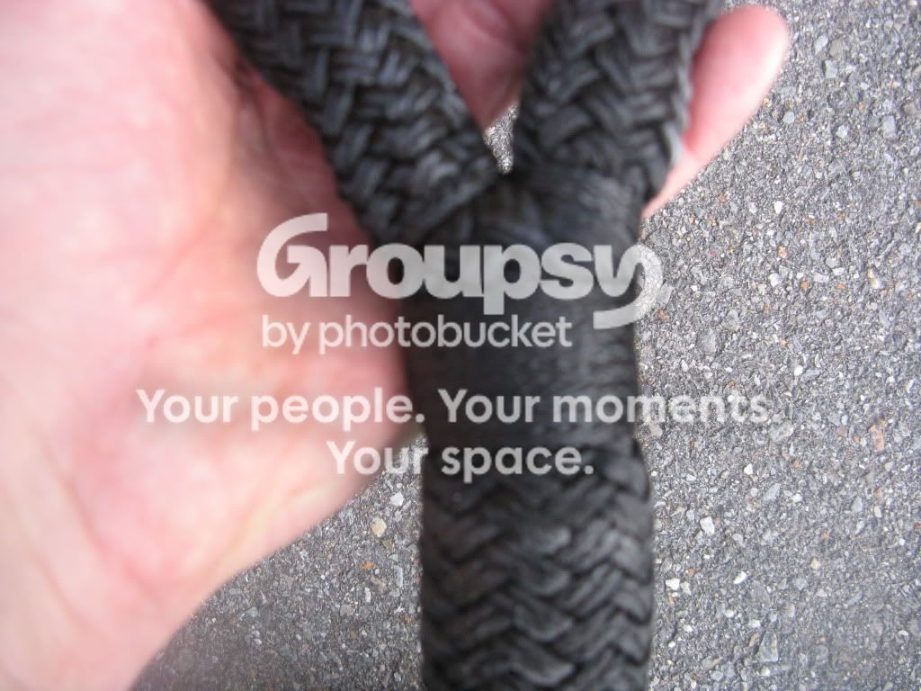

I did a search and didn't see much so I thought I'd share a few pics. This is the Bubba rope 7/8" x 30' breaking strength 28,600 lbs.
Bubba rope comes with a mesh Bubba bag.

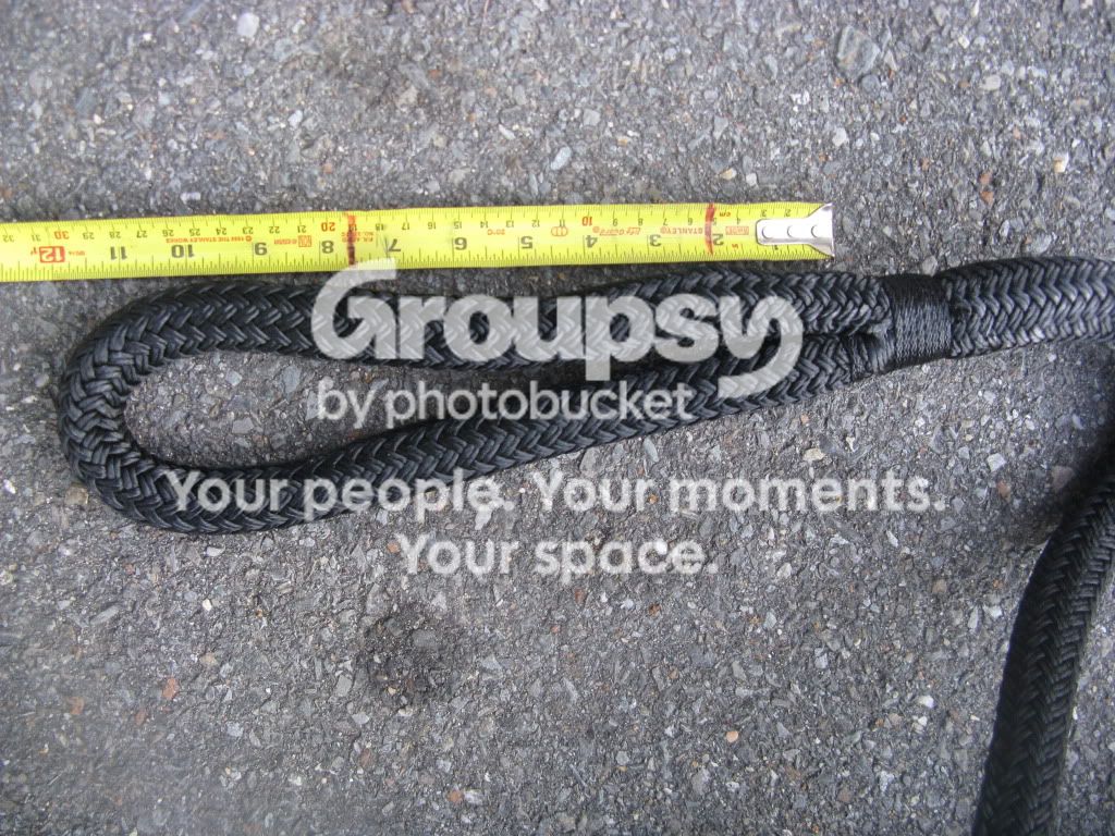

End loops are 12" long, approx 8" round when opened up.

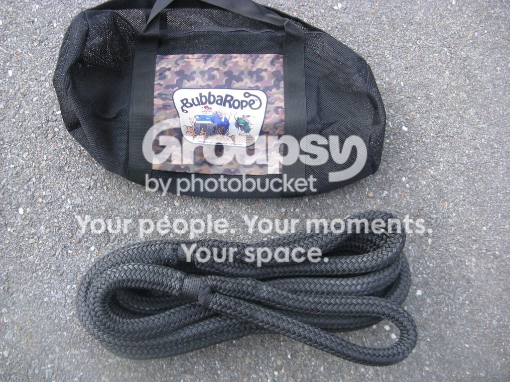

I haven't used it yet but when the time comes we're gonna give it hell.
043.jpg~original
It's a dynamic rope which stores kinetic energy to make it easier to extract a stuck vehicle and makes the recovery safer on both vehicles. More stretchy = less stress on the vehicles and allows a lighter vehicle to recover a heavier vehicle.
Most recovery straps stretch 10-15% while recovery ropes stretch 20-25+%.
