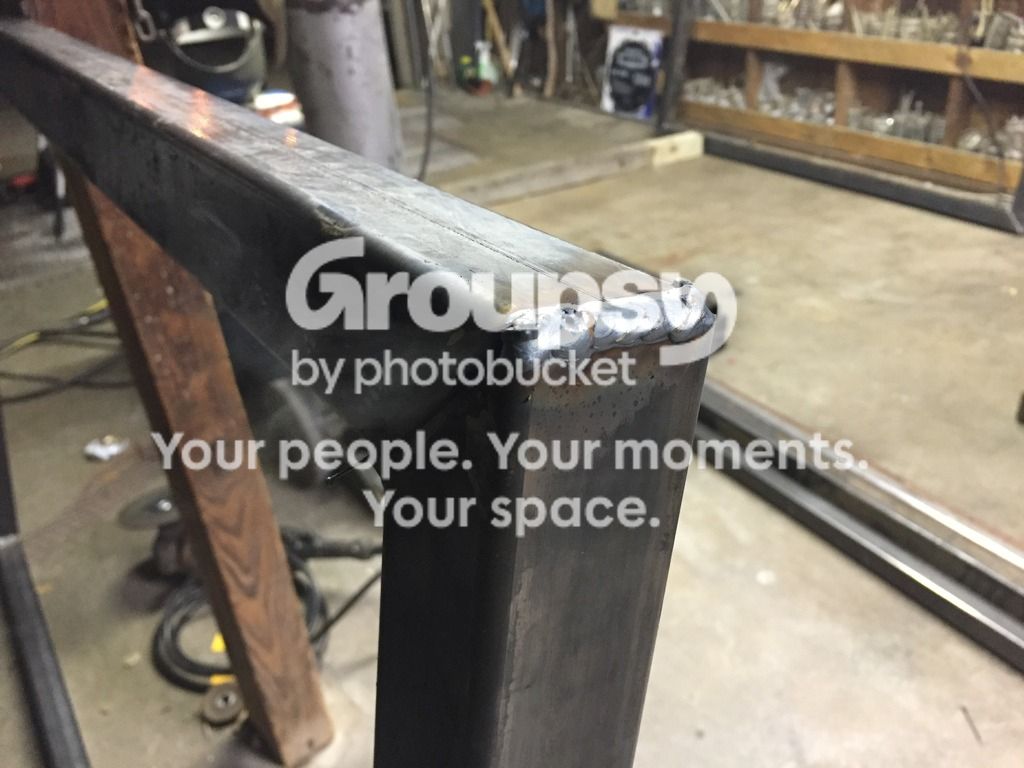

The bottom frame (2.5") is completely welded. Tonight we were able to get the upper box frame (2") cut and tacked together. Tomorrow we will cut and weld the body and the top then hopefully get the spring shackles welded and fitted.
(2/18/16) Today was a light work day. We got the cross members and tongue cut along with all the up-rights for the body. Got the upper box frame fully welded and ground flush on one side where the lid will go.

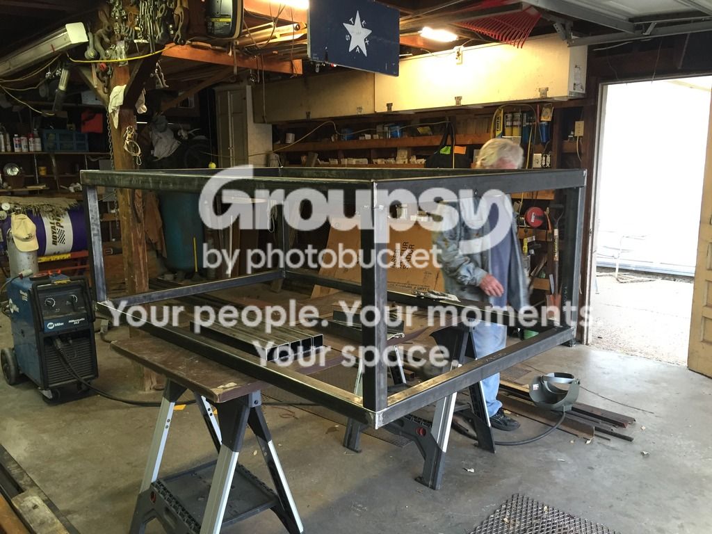

(2/21/16) Well I was supposed to work on the trailer for a bit Saturday, but I got lazy. Today was my birthday but we ended up going out last night instead so today became the work day. We started by test fitting and aligning the up-rights for the body. After we had them align we started tacking them in place and then attached the upper frame. Once everything was squared up, we moved onto completing the welds. We only worked for a few hours but we got quite a bit done. Tomorrow we will be back at it. Pics below for today's progress.

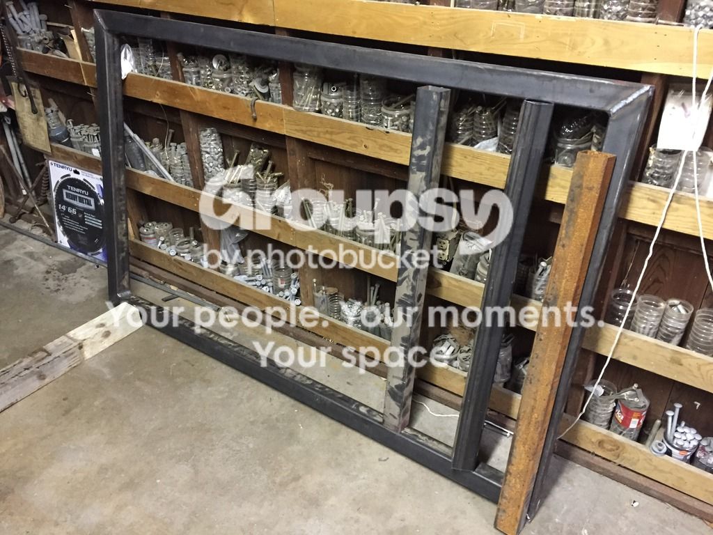

(2/26/16) Worked from about 5-10:30 tonight. Finish welding the cross member. Got the tail gate and lid framed, welded, and ground. Tomorrow we will mount the axle and weld the hinges for the lid and tail gate.
