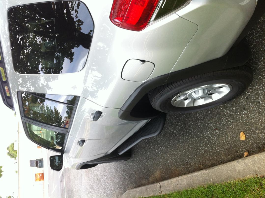

BB on trail last week

Why don't you just read the detailed instructions from Bud.....oh wait, never mind :spy:
Yep pretty straight forward. Bolted right up. Great fit. Look the same as buds but didn't have to pay $300 extra for those detailed instructions.... :)
If you spent the extra $300 bucks and got the authentic BB sliders, you'd realize that wasn't the joke :caked:
