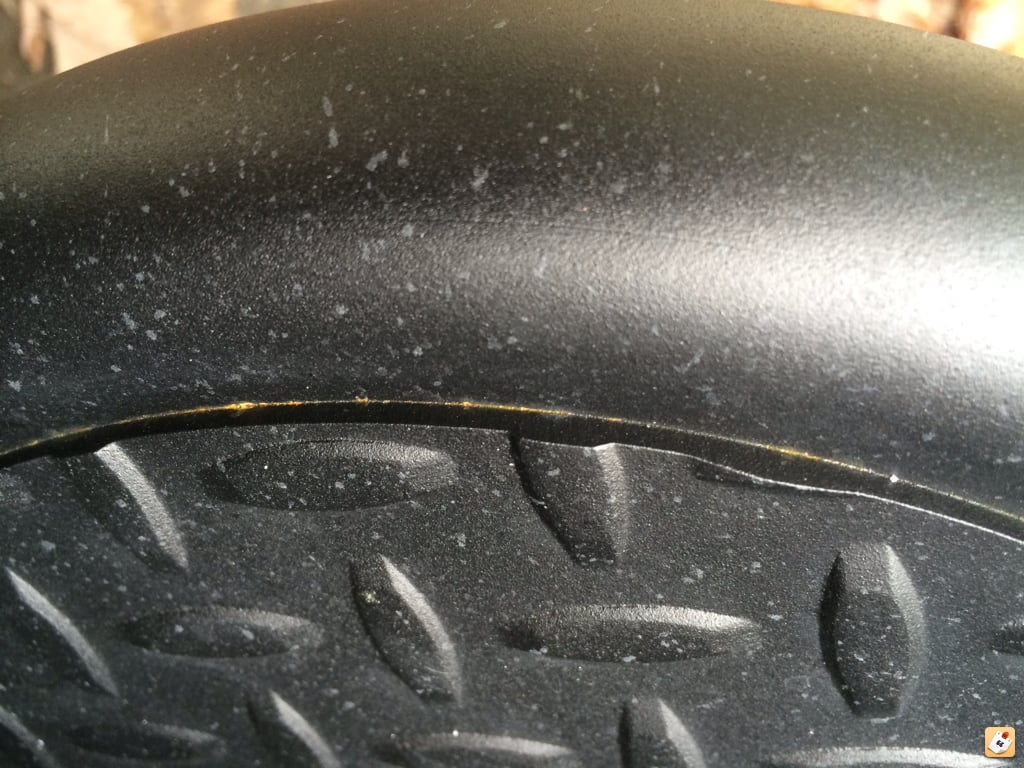

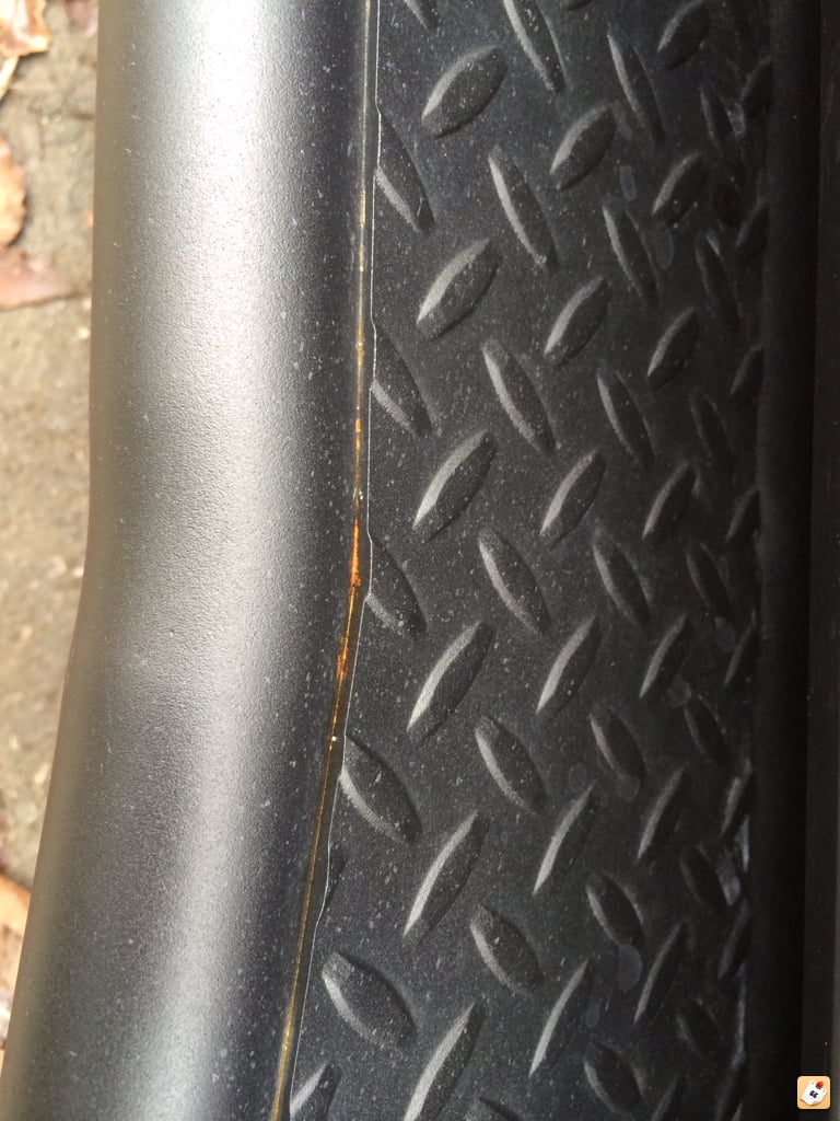

So I got new BudBuilt bump out sliders (regular) with full tread and powder coated from BB. I had these on less than 2 weeks and noticed significant early rust developing along the edge of the tread plate. This really pisses me off and now I wish I would have them Linexed before I installed them. May need to remove them have them done in the spring. I am awaiting an email reply from BudBuilt.
Thoughts and comments on what my options are to fix this minor but annoying rusting issue are appreciated. Thanks in advance.

Probably just spots that didn't get powdercoated properly. You could use some rust converter or sand the rust and use some flat black Tremclad or Rustoleum in those cracks. Way easier than removing them to have them sandblasted and powdercoated again.

Go back and re-read my first post. The powdercoating didn't get scraped off, it just didn't get into that little gap between the slider and the tread plate. Doesn't take much for bare metal to start showing a little rust in the winter with the snow and road salt.

I agree with the powder coating not getting into the gaps. Do you think this can be touched up with a can of rustoleum easily? I assume this will only get worse with Midwest winter weather.

Yes, I'd use the Rustoleum with one of those sponge wedge things. If you aren't using any primer first make sure to try to clean and sand it first and use multiple coats. The good news is that since the powdercoat couldn't reach in there easily not a lot of other things will either so it should hold up pretty decently.
I know that Bud would make things right for you if you called him about it, but honestly this'll be way easier and quicker than removing the sliders and sending them back so he can have them redone then him sending them back to you.

Wondering if it's worth taking them off next spring and having them redone by a local powdercoater. Or, maybe those with those tiny gaps between the tread plate and sliders we are just better off following what westwind77 did himself for better long term protection? Sanding in these gaps would be pretty difficult. Rustoleum does work really well for touchups, but I haven't done anything on the little rust in the gaps.

I have the same thing going on and I live in SoCal. I got some WD-40 and sprayed in all the cracks and seams it looks great and lasts for awhile

Sand the spots and paint them. If you actually use the sliders you'll be doing it after every time you wheel anyway.
