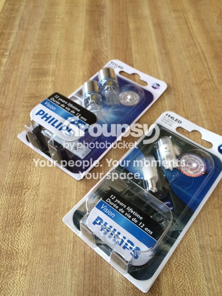

I upgraded the license plate and reverse light bulbs from the stock halogens. Goals were simple:
1. Hopefully increase the illumination and visibility from the reverse lights
2. Change the look of the rear end to better match the awesome LED stop/tail lights
To do this I used LED lights from [MENTION=12905]XenonDepot[/MENTION] :
image_zpsqz4akzit.jpeg~original
- Reverse lights -
921 T16 Philips X-TREME Vision LED
I didn't take a before photo, because you can go in your driveway and look yourself if you don't have the LED's already...

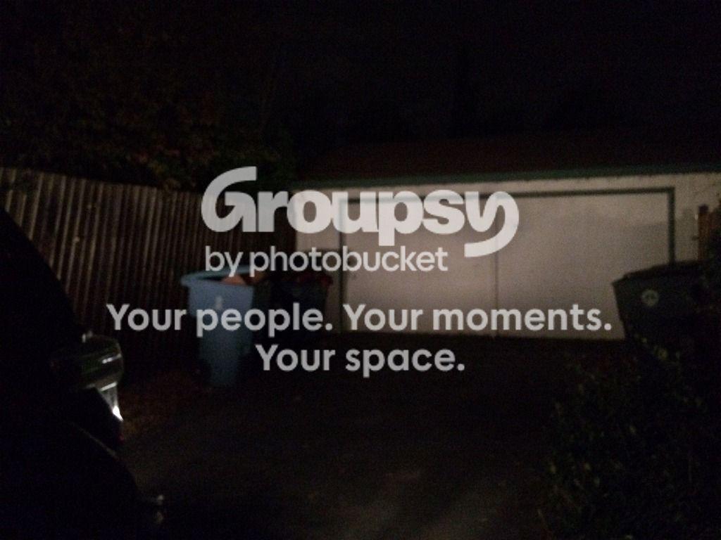

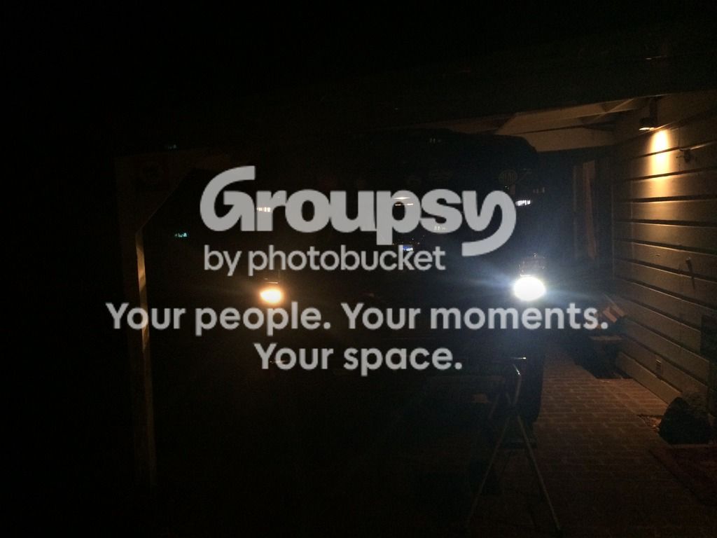

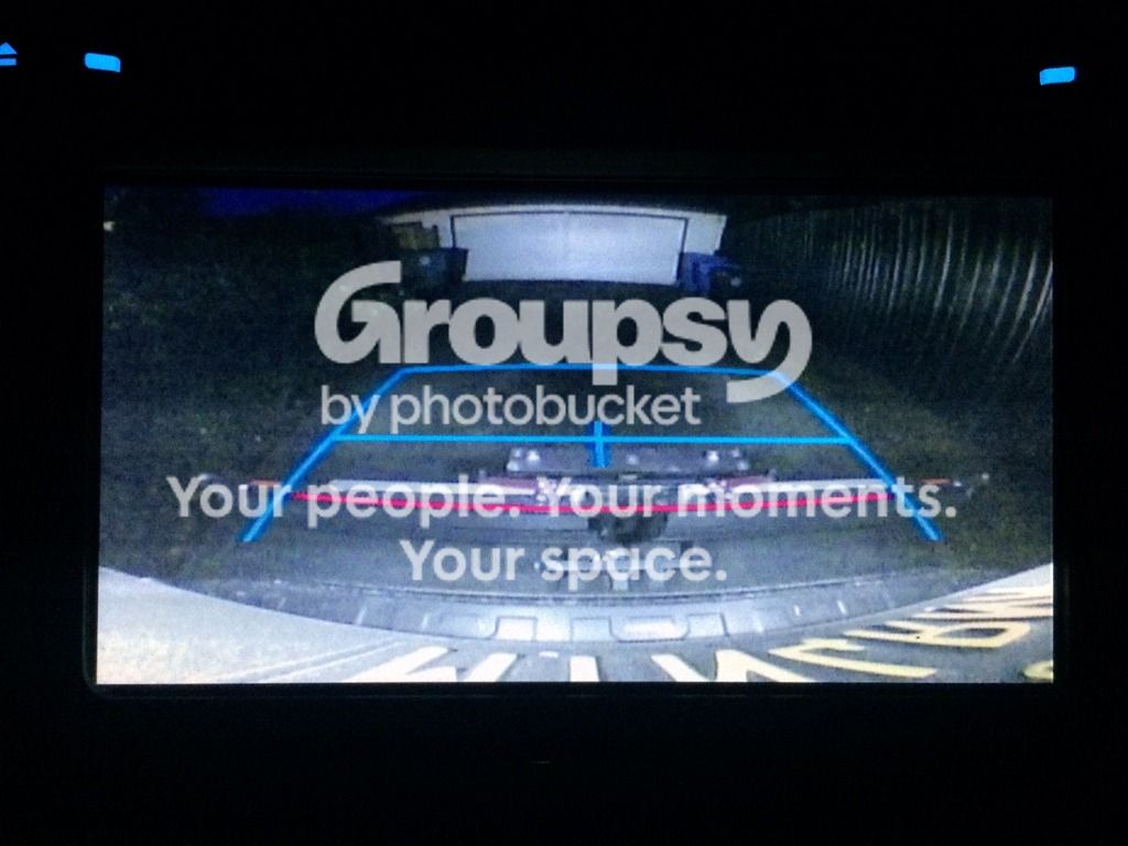

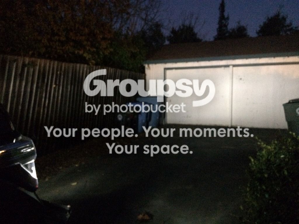

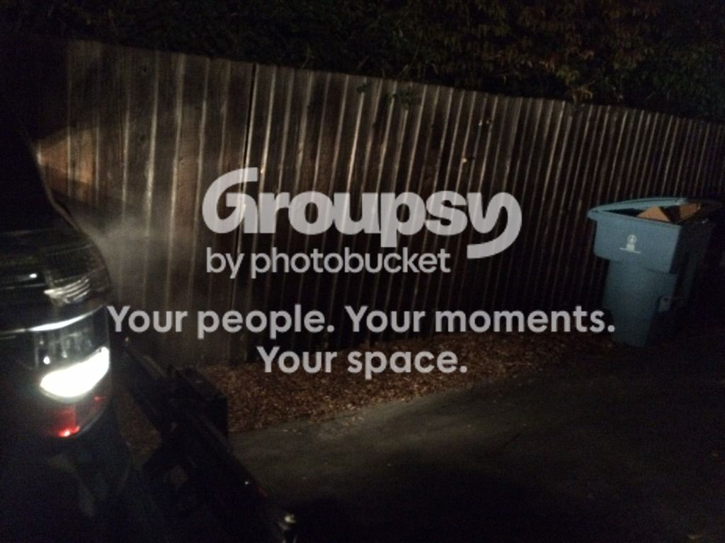

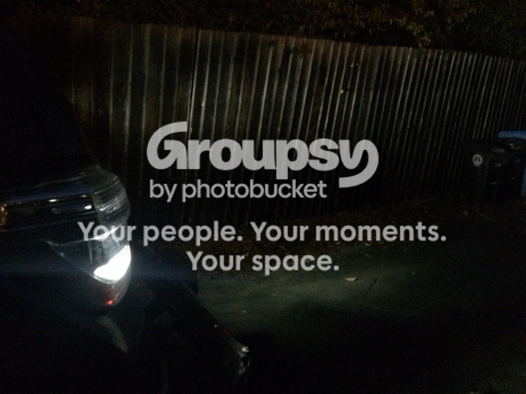

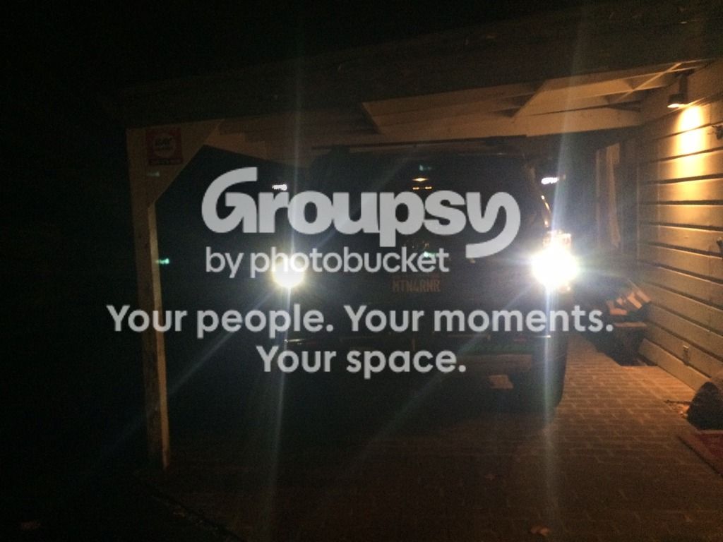

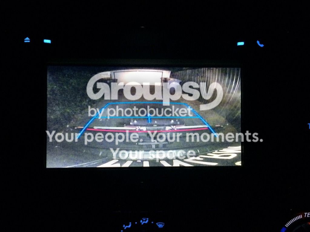

Here are some before and after photos in the same spot of my driveway to show the light dispersal difference between the stocks and the LED's.
Before:
Rear camera
image_zpsdwcug6wu.jpeg~original
Side dispersion
image_zpsi1uot6rr.jpeg~original
Rear dispersion (shotty focus, but you get the picture)
image_zpsmxwbgkxi.jpeg~original
After:
Rear camera
image_zpscmmkvq5p.jpeg~original
Side dispersion
image_zpsajky5il0.jpeg~original
Rear dispersion (same shotty focus)
image_zpsn5imkdlj.jpeg~original

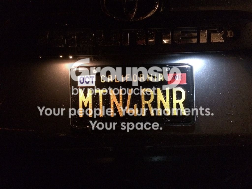

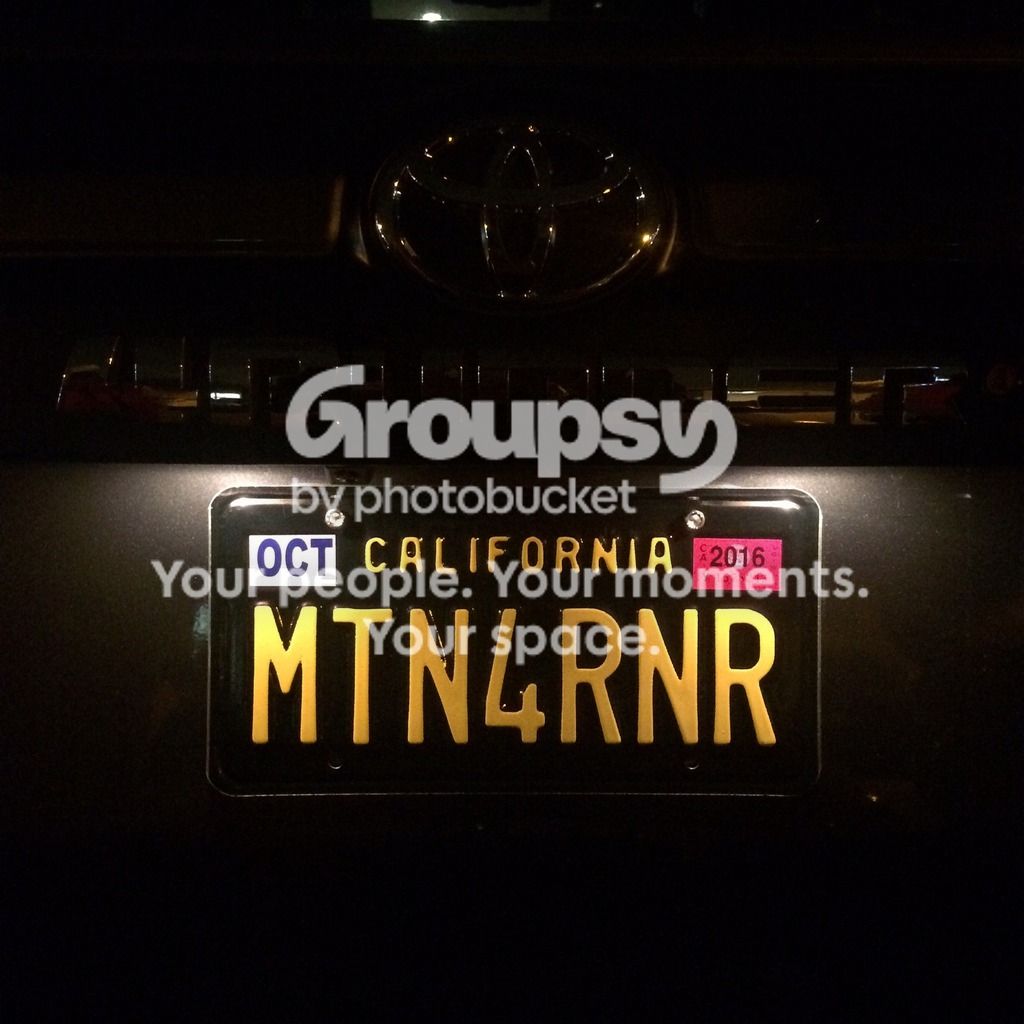

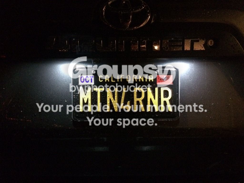

- License plate lights -
194 T10 W5W Philips vision LED
Before
image_zpszzvuh72e.jpeg~original
During
image_zpsiwqmns65.jpeg~original
After
image_zpsr31p4jxq.jpeg~original
Overall impressions are that the reverse lights definitely brighter than the halogens from an illumination standpoint [not just a 'looking at it' standpoint, because we know the LED's will look brighter head-on]. And the license plate lights definitely make the back end look a bit more sophisticated and modern, which is what I was going for. Overall a good upgrade. Now for some HID headlights and LED fogs... [Hear that [MENTION=12905]XenonDepot[/MENTION] ?]

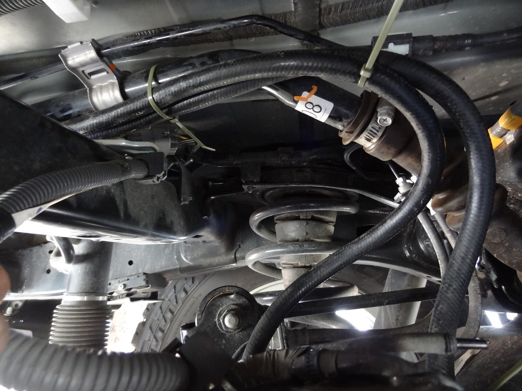

After reading of many members of this forum relocating their differential breathers to avoid inevitable milky gear oil, I decided to give it a go. A little cheap insurance later on down the road can't hurt, and if nothing else, I got some good one on one time with the rig, getting to know a little more about her. I have a trail, and thus a locker. So a separate breather for that as well, because overkill. I decided to use the T4R.org standard OEM Toyota front differential (2-way) breathers. Let's get into it:​
Parts used:
- 14' Transmission oil cooler hose, 3/8"
- Toyota part 90404-51319 (Union)
- Toyota part 90930-03136 (Breathers) (x2)
- Stainless steel hose clamp (x4)
- Enough zip ties to hold it all together

Routed the lines from the fender to the axle along the fuel tank fill line
DSC09019_zpsvvjbvqic.jpg~original
I left some wiggle room to account for suspension travel
DSC09021_zpsvs2d4woz.jpg~original

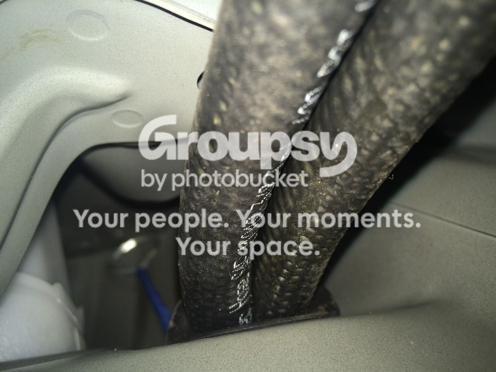

I attached the hose ends to the installed nipple, and the end of the e-locker hose using the hose clamps. The e-locker hose that is attached fits into the new transmission cooler line loosely, but will clamp down with the hose clamp tightly. I used a zip tie on the e-locker line to keep it from moving around too much. Be sure to route away from the exhaust, too close might get a bit toasty.
DSC09023_zpsoggm8dty.jpg~original
I cut the line in the cargo area, and cut the OEM grommet plug to fit around the lines.
DSC09027_zpszcznppm2.jpg~original
DSC09028_zpsn07wqt11.jpg~original
This is where things got a bit sideways. I spent the better part of an hour trying to seat the grommet plug in the hole to no success. I then took the rear fender bumper off to get a better look.
DSC09037_zpsw17v6cug.jpg~original
DSC09041_zpsp5fxpwgf.jpg~original
I decided to install the grommet plug from the outside. I cut the plug along the edge, and fit it around the lines. With a bit of soap, I was able to fit it in for a decently sealed fit. Hind sight, don't cut the plug, just remove the bumper edge first and feed from the outside. Done deal.

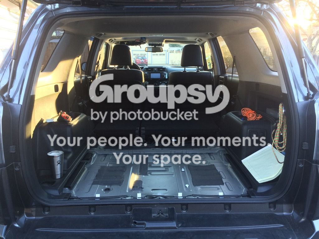

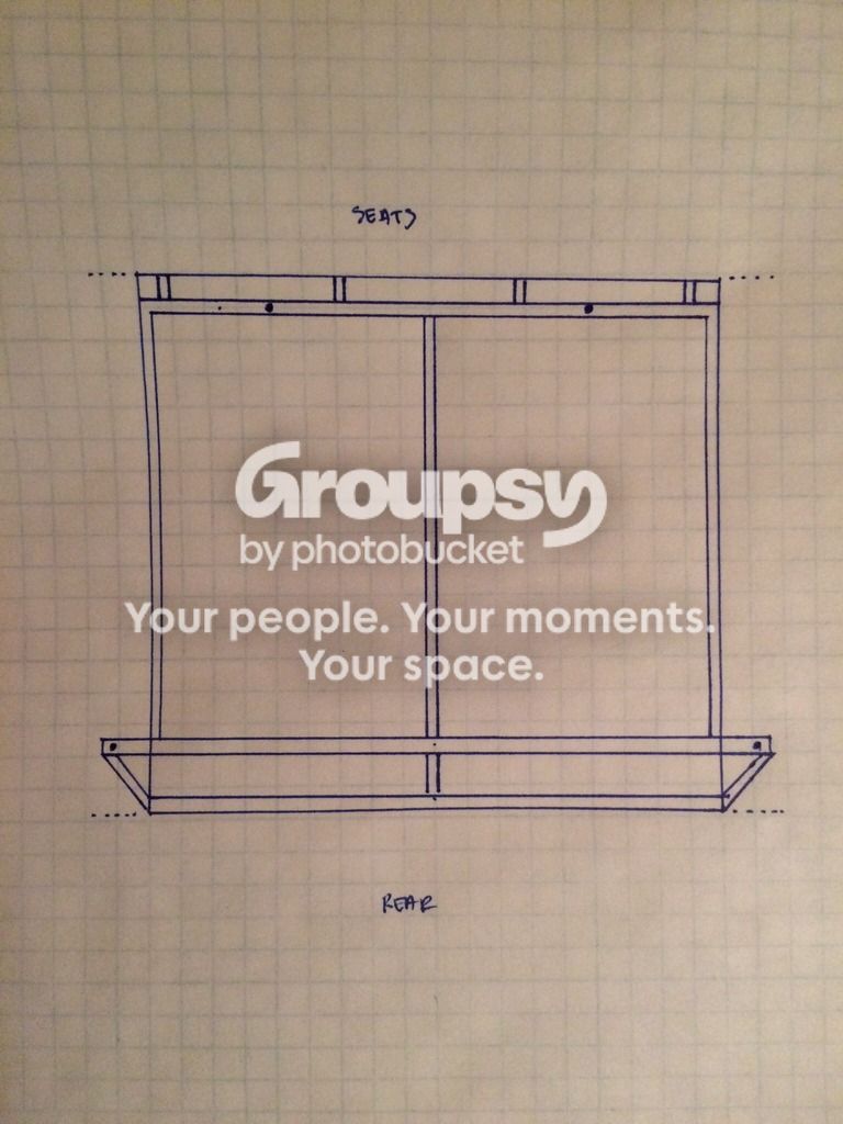

Took apart the cargo area to start taking some measurements for building a rear tie-down platform. Gotta see what's underneath before I start drawing!
image_zpszeeaecm6.jpeg~original
And drawing!
image_zpsutmyca9p.jpg~original
Let's see where this goes...​
