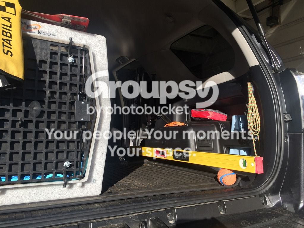

Took apart the cargo area to start taking some measurements for building a rear tie-down platform. Gotta see what's underneath before I start drawing!

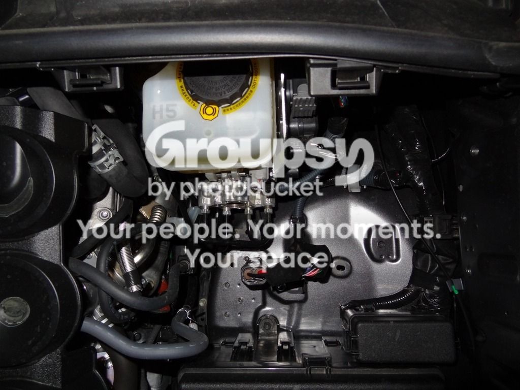

[MENTION=129593]MTN4RNR[/MENTION] What's the correct fuel line to get?
I k,ow you went with 3/8 and have seen others gone with 5/16 and I believe as small as 1/4".
I used a 3/8" transmission cooler line. It fits the Toyota rear axle union. But it's looser on the Toyota 2 way breather. With the hose clamp I was able to tighten the hose on the breather enough to seal. I think that either 3/8" or 5/16" will work, but I cannot confirm the 1/4" from my experience. I would think it would work as well. Might be tighter on the union. Best guess would be to get both the union and the breather and take it to your closest auto parts store to size it yourself.

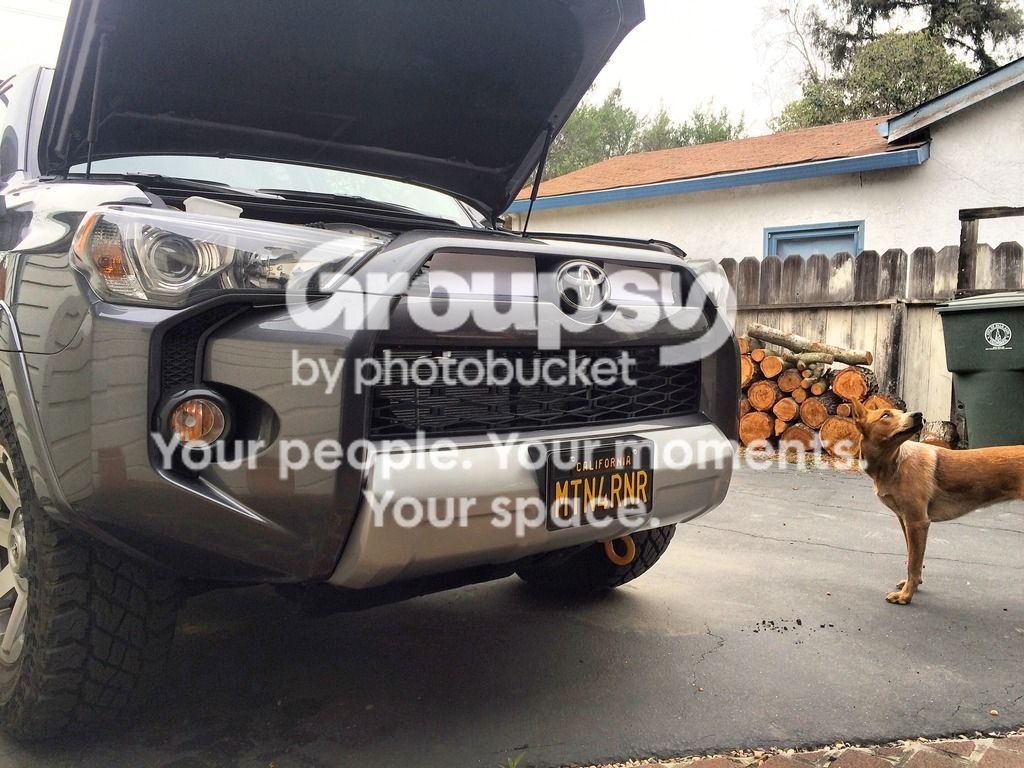

Quick Question, are your HID headlights the Philips 4300K, they seem closer to 5000k based off the pictures but I dont see the Philips bulb's listed with any option other then 4300k?
Lastly, what bulb type are the fog lights?
Thanks in advance.

They are the 4300k Philips bulbs, but according to [MENTION=12905]XenonDepot[/MENTION], after the bulbs break in, they will end up being closer to 5000k.
All of the info on my fog bulbs can be found here.
Good luck!

The Philips 4300K HID bulbs color shift to 4700K after about 100 hours of usage.
