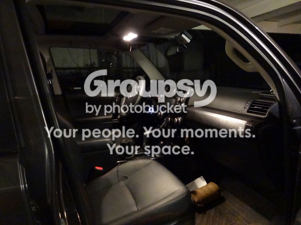

Map lights before
DSC08929_zpsjupjal58.jpg~original
Map lights after
DSC08932_zpspiz9us9v.jpg~original

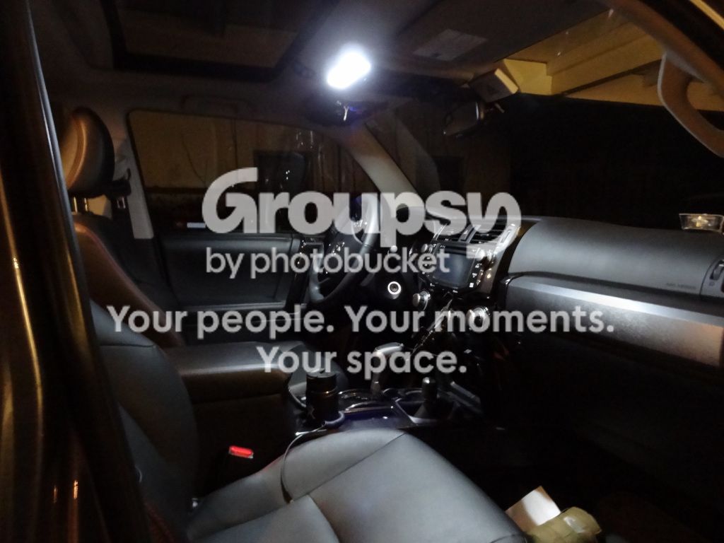

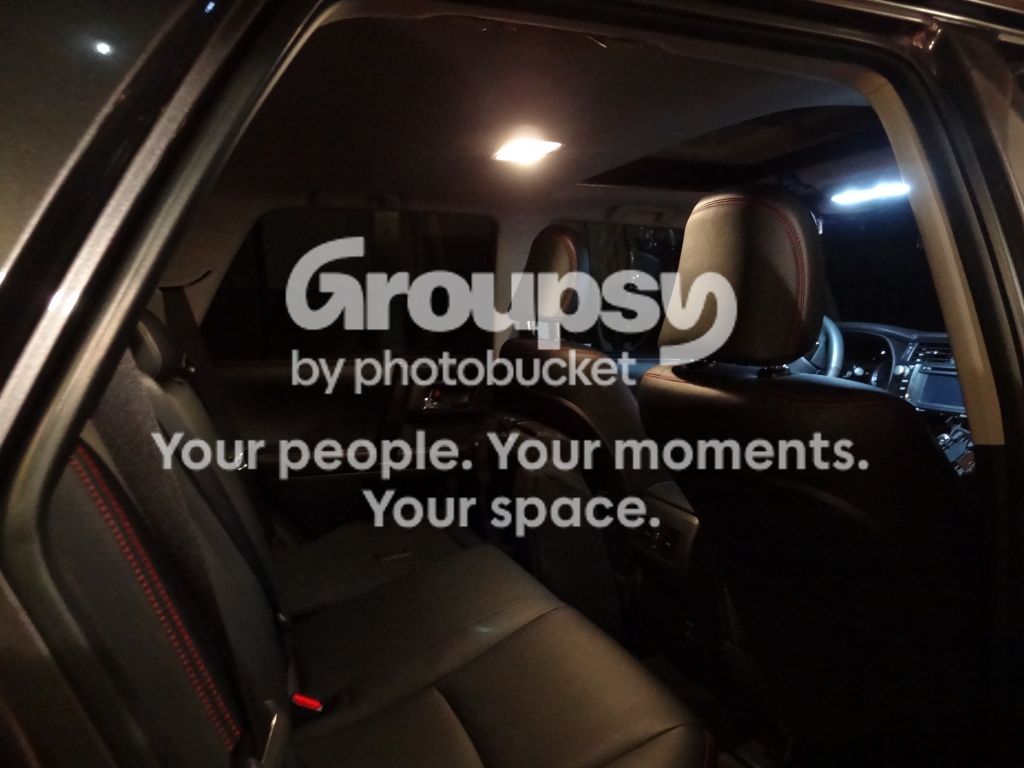

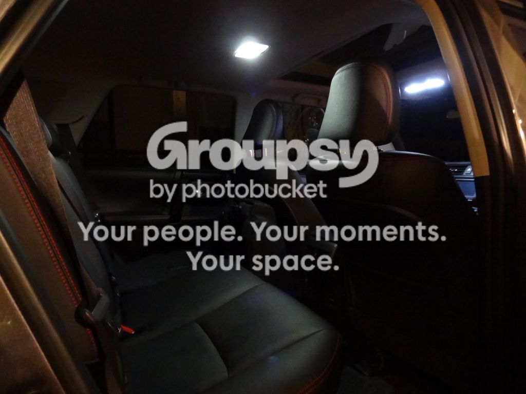

Dome light before
DSC08936_zpsv3vzdlyj.jpg~original
Dome light after
DSC08938_zpsmvsz1ksg.jpg~original

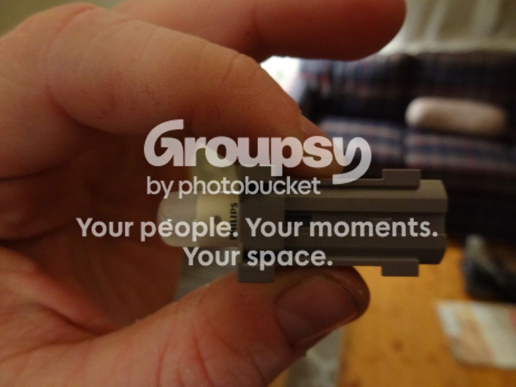

Philips bulb orientation in housing (so that they work)
DSC08950_zpsnsamw6qs.jpg~original

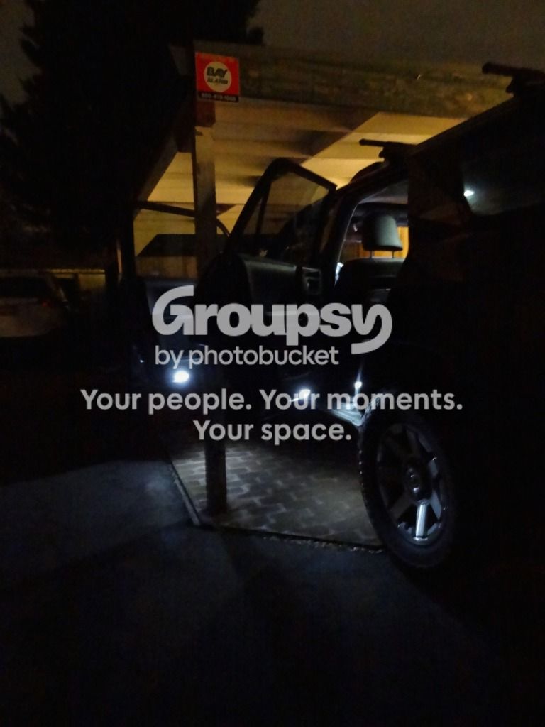

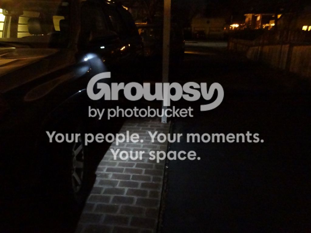

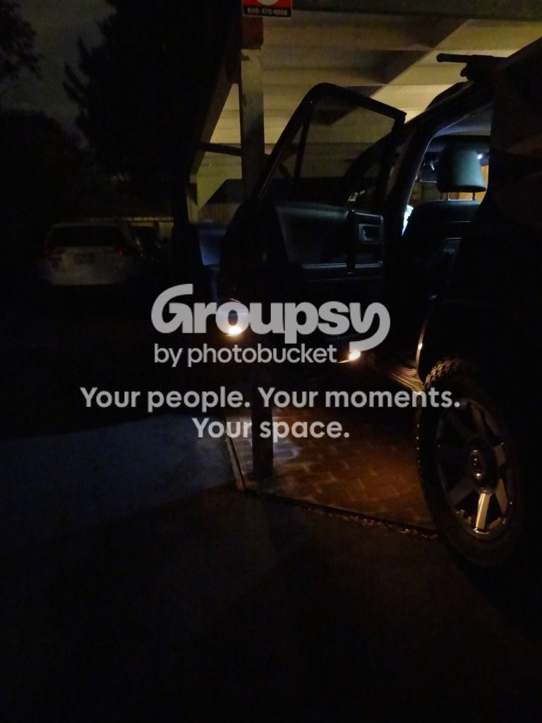

Puddle lights before
DSC08960_zpsoassgsrf.jpg~original
I followed this thread post to get to the puddle lamp bulbs.
Puddle lights after
DSC08963_zpsjf8cmxqz.jpg~original

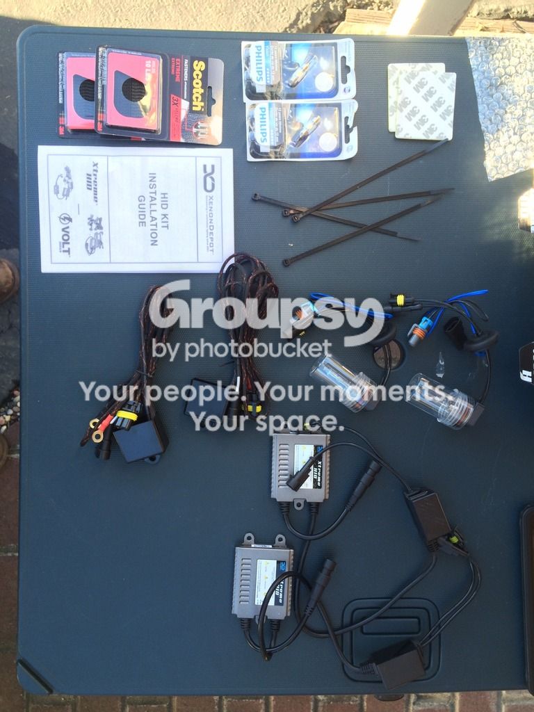

I gifted myself a set of [MENTION=12905]XenonDepot[/MENTION] Xtreme HID's for the low beams on the 4Runner. I really like the ability to see as much as I can on the road, and once I saw the light output from my dad's GX (which is LED, but still much brighter) I knew that an upgrade was in order. After reviewing my options, I settled on the Xtreme HID kit, with the Philips bulbs.​
Parts used:
- Xenon Depot Xtreme HID H11 kit
- Drill of choice
- Milwaukee #9 step drill bit
- Scotch Extreme Fasterners
- Knee Deep Brewing Midnight Hoppyness
Everything laid out (including the fuses, which I didn't use)

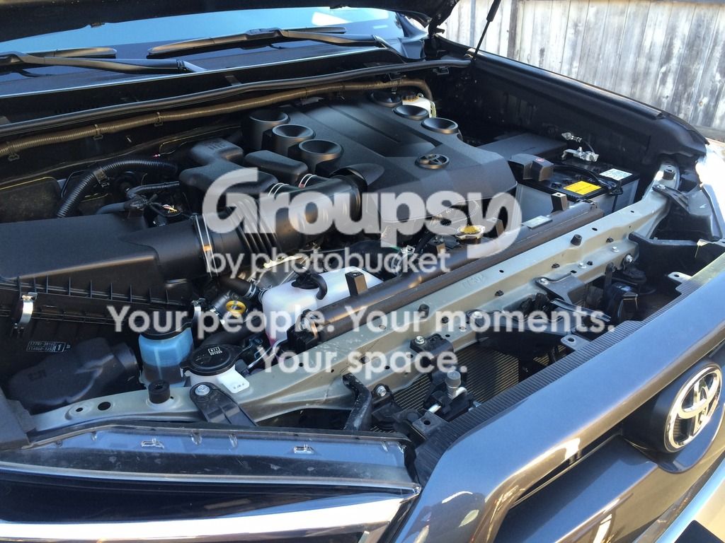

I took off the plastic cover for the radiator, not knowing whether or not I would need to. To install the kit, you do not NEED to pull this piece off, but in the end I used two of the fastener holes on the outside to zip tie the wiring into a secure position.
image_zps8ultq36w.jpeg~original

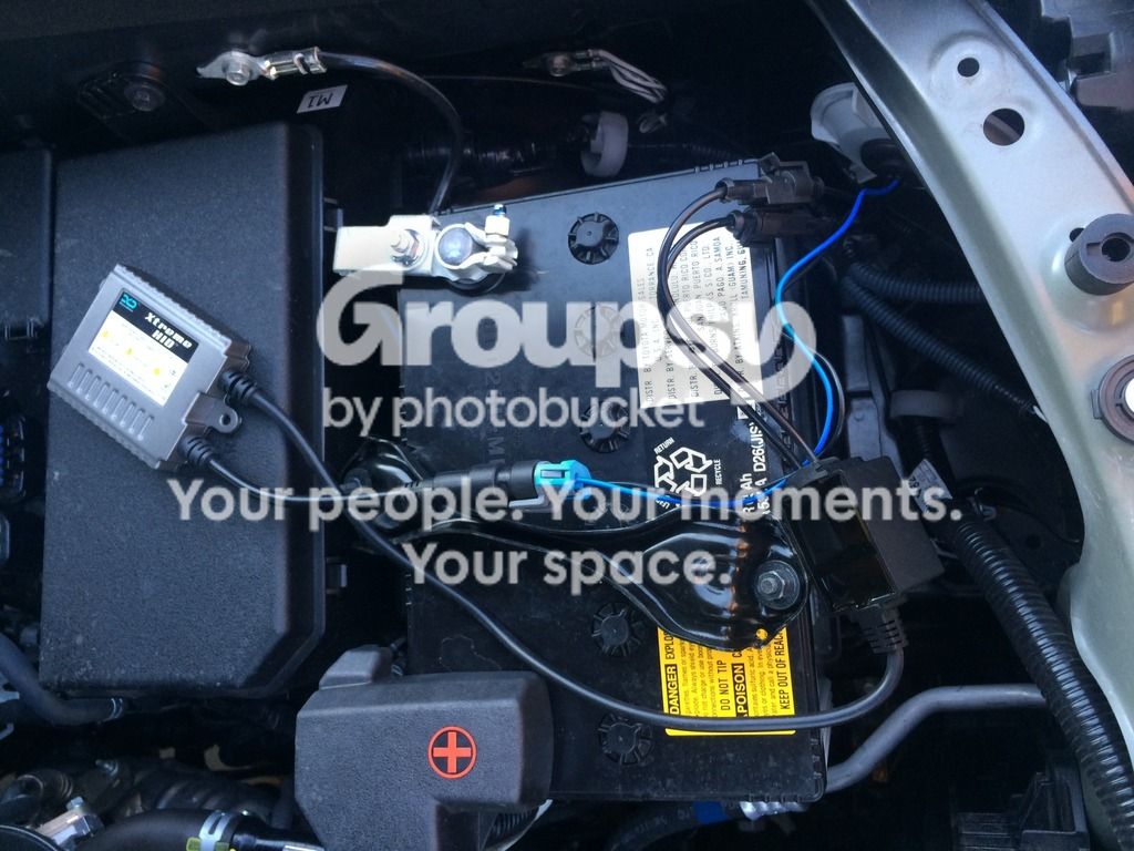

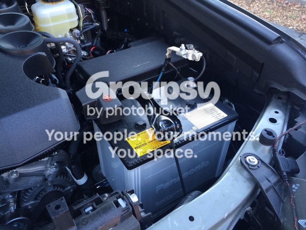

I removed the negative battery terminal, and removed one side of the battery restraint to move it towards the engine, giving me a bit more space to access the light housing
image_zps009gr61v.jpeg~original

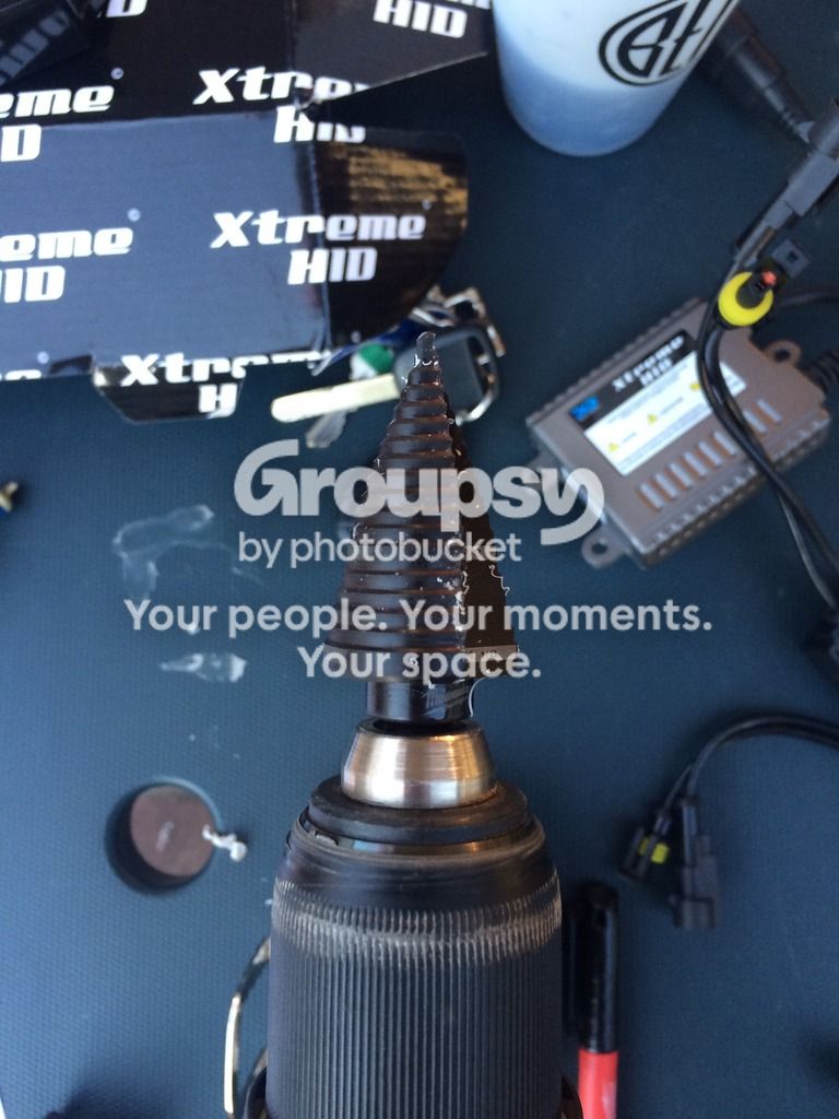

I removed the dust cap covers and drilled two 1-1/16" holes dead center. I used a Milwaukee #9 step drill. I have found that they work very well with plastic materials and producing a very clean hole. It also allows you to start with a slightly smaller hole and make it gradually larger to make sure there is a snug fit. Drilling is always hard to do on a new truck, but that's what the beer is for.
image_zps2gy9supo.jpeg~original

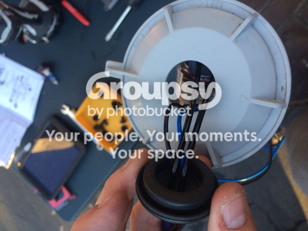

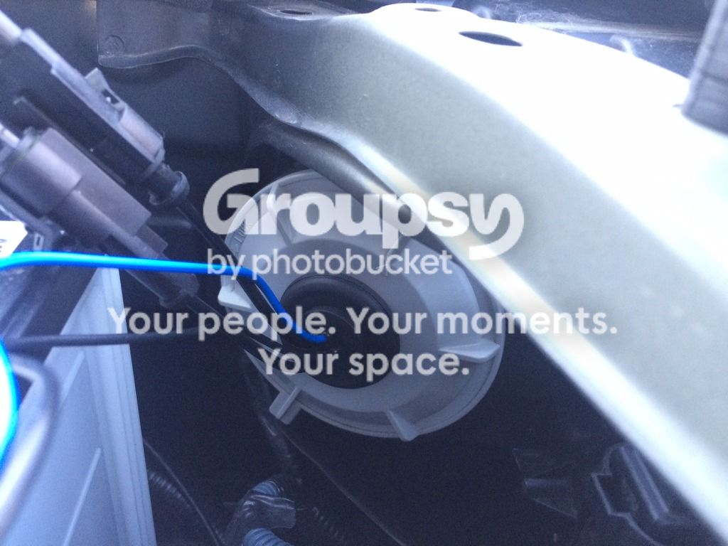

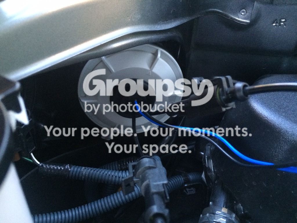

I then fed the wiring through the hole, and secured the grommet. Interestingly, I read many on this forum that didn't like the idea of drilling the hole in the cap because it would compromise the sealing ability of the housing (dust, water, etc.). What I found interesting was that in the bottom of the same housing, Toyota uses the same style grommet boot to bring the factory wiring into the housing. It would seem that this kit would not compromise any of the sealing ability in the housing than what Toyota had already installed. I didn't snap a photo, but I might remove the cap and take one to add later.
image_zpsqz7raqez.jpeg~original

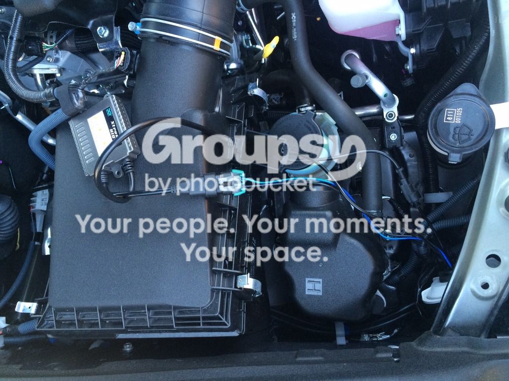

I then installed the bulbs into the housing and hooked everything up to determine if I would need to reverse the polarity on the harness as indicated in the instructions.
image_zps6okn423j.jpeg~original
image_zpsissa5dnk.jpeg~original
image_zpsmcvyjbnl.jpeg~original
image_zpsj8hylxvo.jpeg~original
Turns out the system fired right up with no wire swap needed.

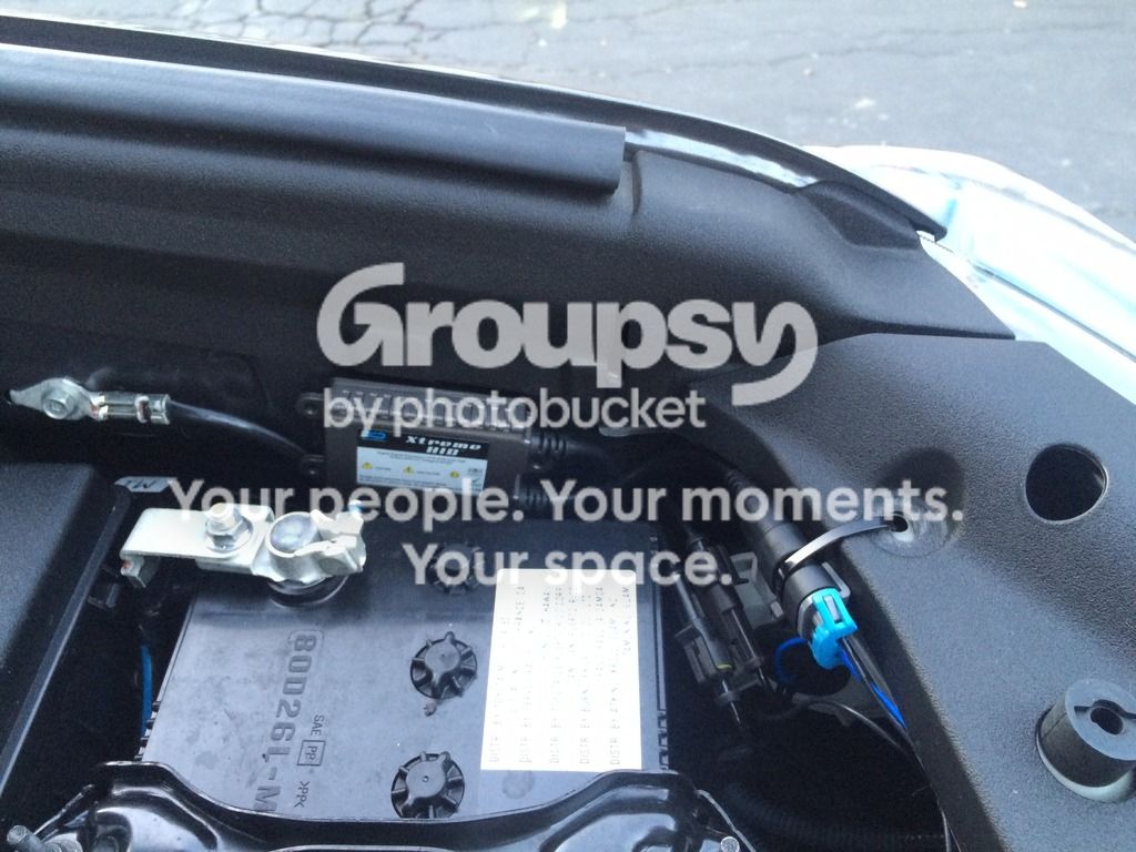

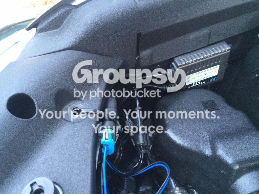

Clean up time. I used Scotch Extreme Fasteners to secure the ballast and harness to the inner fender sheet metal. The kit came with a double sided 3M product, but I like the idea of being able to remove the ballasts easily if needed down the road. They are rated to hold 2lbs/sq. inch and seem to hold very well. After driving around, they show no signs of moving.
image_zpsz1n2mrzh.jpeg~original
Passenger side (note the zip tie holding the harness to the radiator valence/support as mentioned in the beginning)
image_zpskeyqj6i6.jpeg~original
Driver side (note the zip tie holding the harness to the radiator valence/support as mentioned in the beginning)
image_zpsawoza0nf.jpeg~original

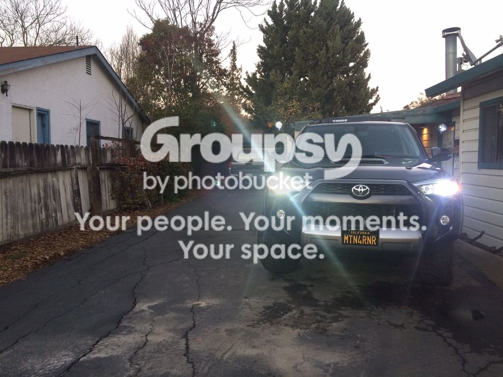

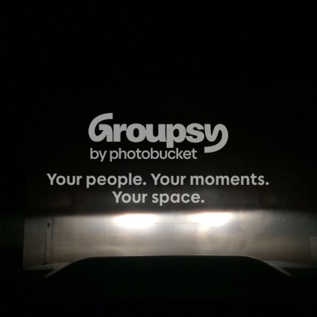

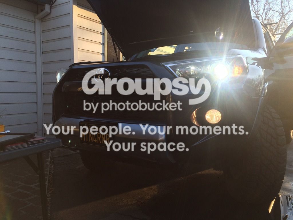

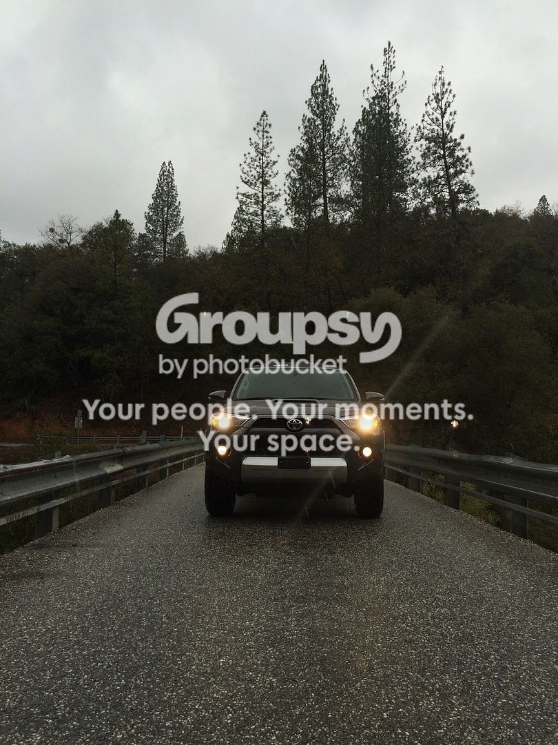

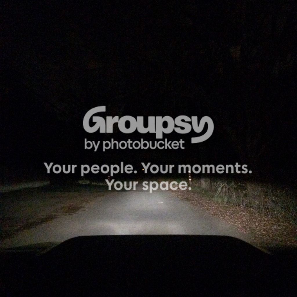

Now for some comparisons
Before (no fogs)
image_zps5hbd1ykl.jpeg~original
After (no fogs)
image_zps1vukulrj.jpeg~original

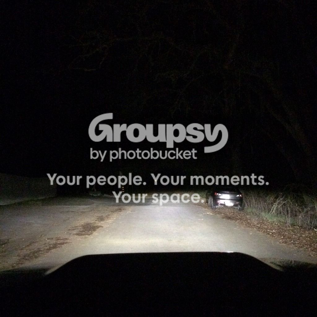

Before (no fogs)
image_zpsblcmhxi6.jpeg~original
After (no fogs)
image_zpswwxnwxbr.jpeg~original
Before (sorry I don't have an identical head-on shot, but this is the best I have)
image_zpsd5pe3d5q.jpeg~original
After
image_zps24dayqc2.jpeg~original
The photos show some of the difference, but don't do enough justice. Driving on the road, this upgrade is something that should have been included from the factory. Night and day difference. I am very happy with the product, and the outcome. Thanks [MENTION=12905]XenonDepot[/MENTION] for the great product!

Quick question, I'm planning on doing it pretty much exactly the way you did as far as the dust cover drilling, but I wanted to ask: you mentioned that Toyota used a similar grommet in the bottom of the dust cover to bring the stock wiring through. Is there a way to bring the HID wires in through that hole instead?
Installing the [MENTION=12905]XenonDepot[/MENTION] Philips HIDs today using your template. Thanks for the writeup and pics.
Yes, you can, but the issue becomes that that if you move the OEM connector outside of the housing, it is not a weatherproof connector. If you felt like cutting the wiring and installing weatherproof connectors on both side you could. I though about it for about 3 seconds, since I have several weatherproof connectors, but I didn't want to bastardize the OEM harness.

Anyway, I just wanted to mention that I went to 4 different hardware stores searching for a step drill bit that wasn't $50- can't justify spending that much on a bit that I only plan to use twice, and on 1/8" thick plastic to boot. I decided to take a risk and try a standard 1" hole drill ($5), and long story short my holes are nowhere near as pretty / clean as yours but the grommet fits flush and snug and the lights look killer.

Yeah, the step drill is pricy, but I figure that if I have to drill holes in my rig, I may as well try to make them as clean as possible so I cry less. Plus they work for metal too, always a plus. Whatever gets the job done at the end of the day though. Plus, with the grommet, you'll never see the difference between yours and mine!
