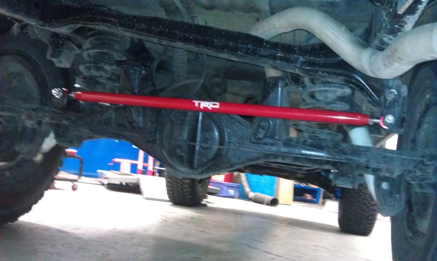

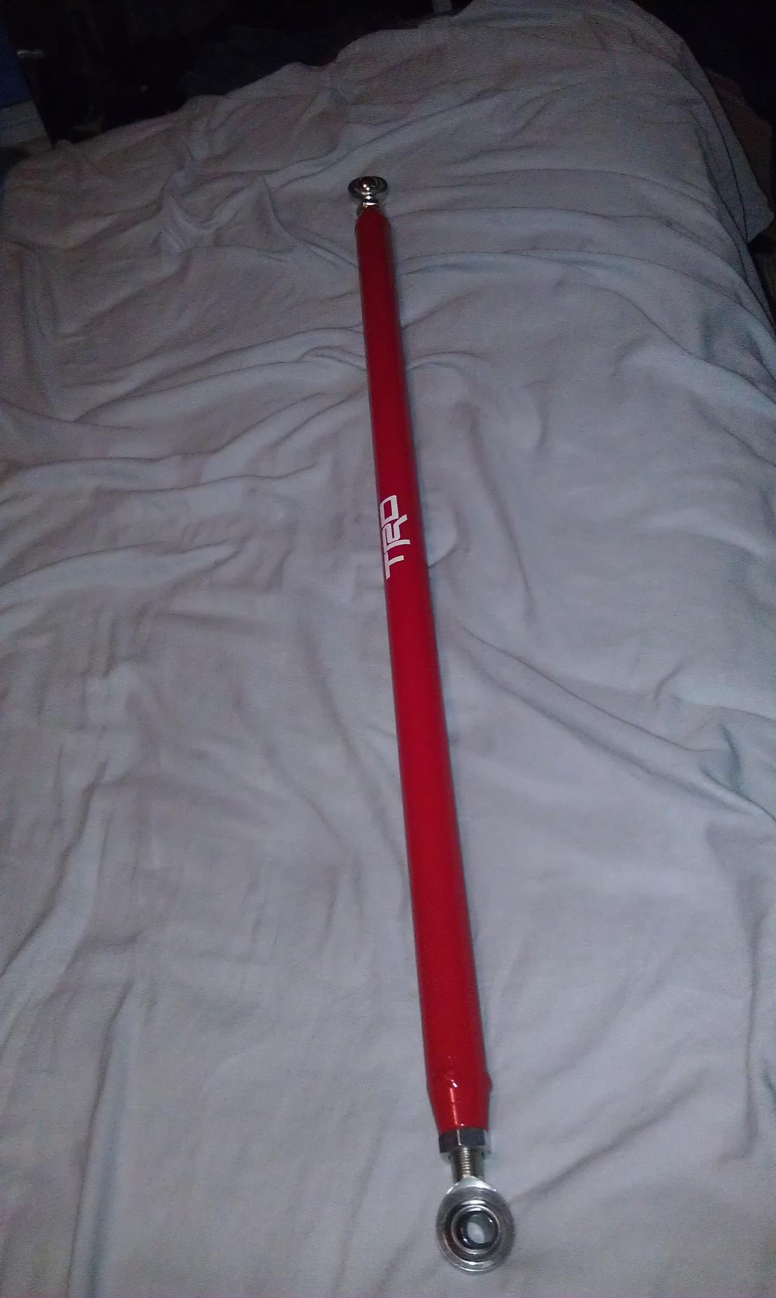

well I built my own custom adj panhard bar, total cost was 62$ Tell me what you guys think!! it was super easy to build, got every thing needed from Q&S components.

I used 1/2x 5/8 -18 pan hard bar kit , it comes with both hiem joint ends with weld in bungs , then ordered a 4ft section of the d.o.m tubing 1"1/4 od .x 1.010 id x .120 wall thickness. Also ordered 4 zinc plated 1/2 cone spacers, ...I had to drill out the bolt holes to 1/2 and put a few 1/2 washers on each side to tighten it all up. Then I powdercoated the bar super mirror red. All parts needed can be purchased from Rockkrawler 4 link kit, bearing, heim joints, heims, joint, jam nut, supply, rod ends
Looks good. couple questions....
Is one of the Heim's reverse thread so its adjustable on the truck? Not a necessity, but if you are trying to fine tune a suspension this can save you a lot of work removing to adjust.
Why give TRD credit for your work? Sign that ______ with a silver sharpie and clear coat it! You did a good job be proud of it. lol
Im not a fan of that because jam nuts come loose... ANd then you get you links growing/shrinking under the truck....
The only think i would say is if your dealing with heim joints buy the expensive ones. They all wear out. and they make one heck of a racket once they get a little play in them.
Dont make that bad boy much longer than stock or else your gas tank will most likely get attacked by the drive shaft
I like seeing others weld stuff up :)
Yes there reverse thread so its adj on the truck, and the jam nuts will be periodically checked, and I made it stock length because I have a panhard drop bracket and it sat level before , so it was made to same length as stock bar, and yes I shoukd have signed it lol overall I'm happy with it ,
