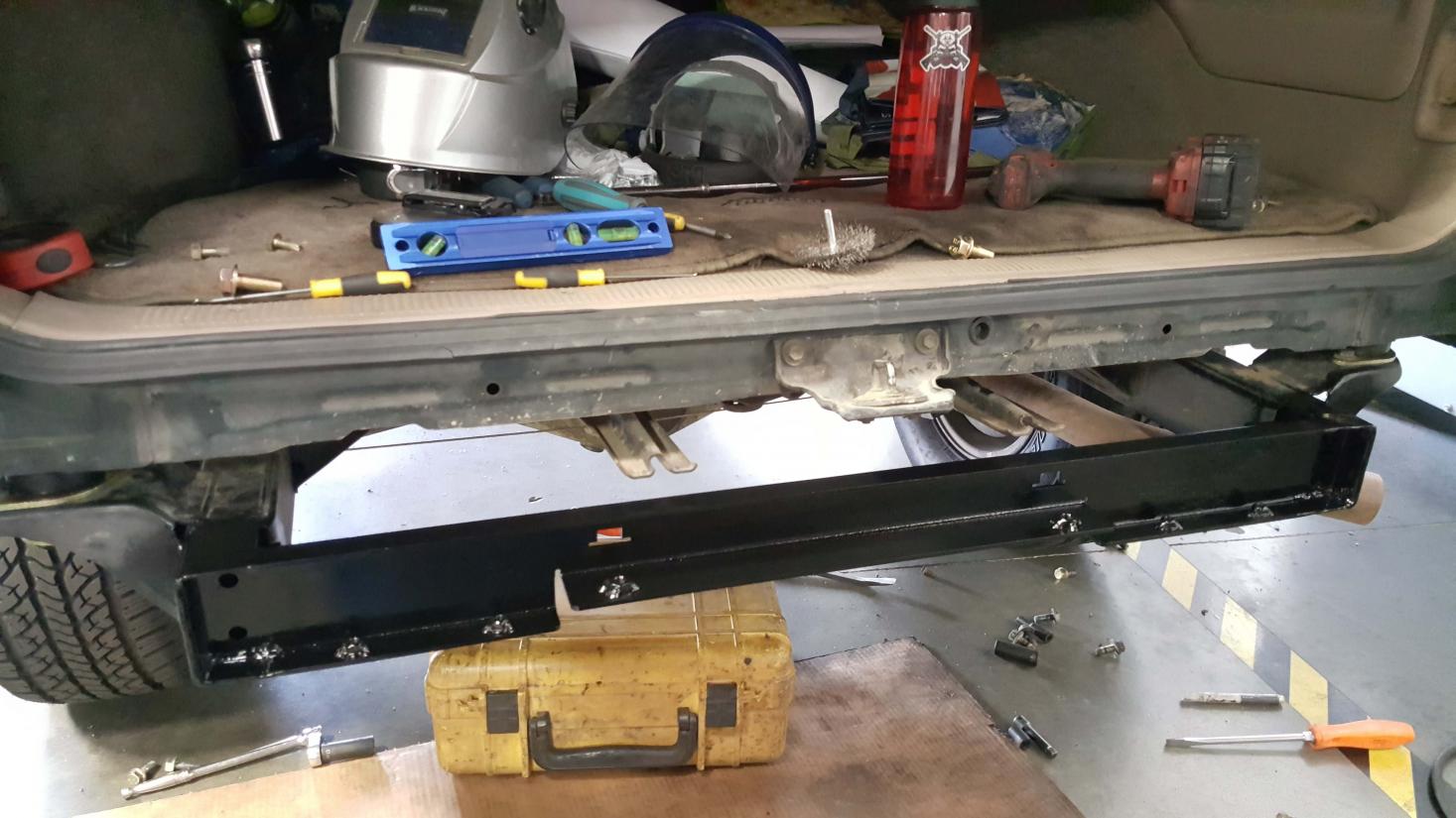

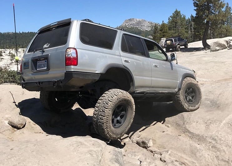

These are finally in production (first run of 10 being made right now) - prototype shown below:
- followed by fronts later this year. :)

I should have the non-BL install kit in production by the time the last of these pre-orders ship.

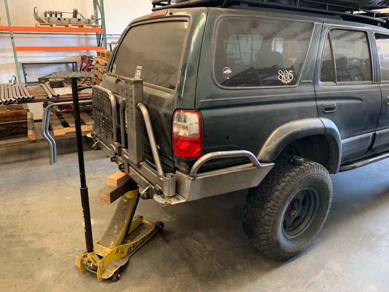

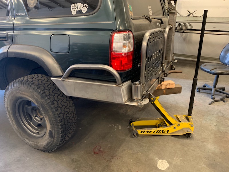

BTW, here’s a completed bumper for the thread:
and it clears 37s!:

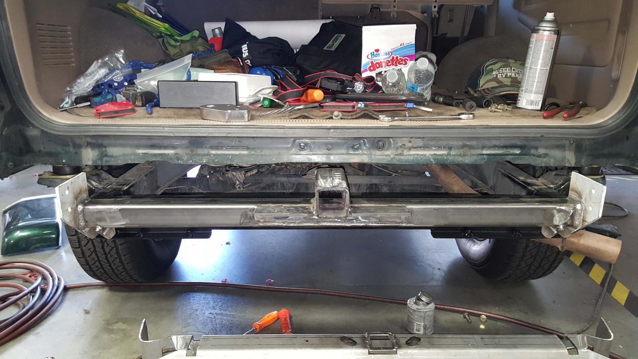

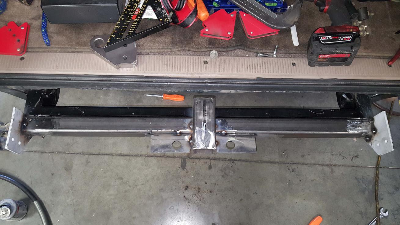

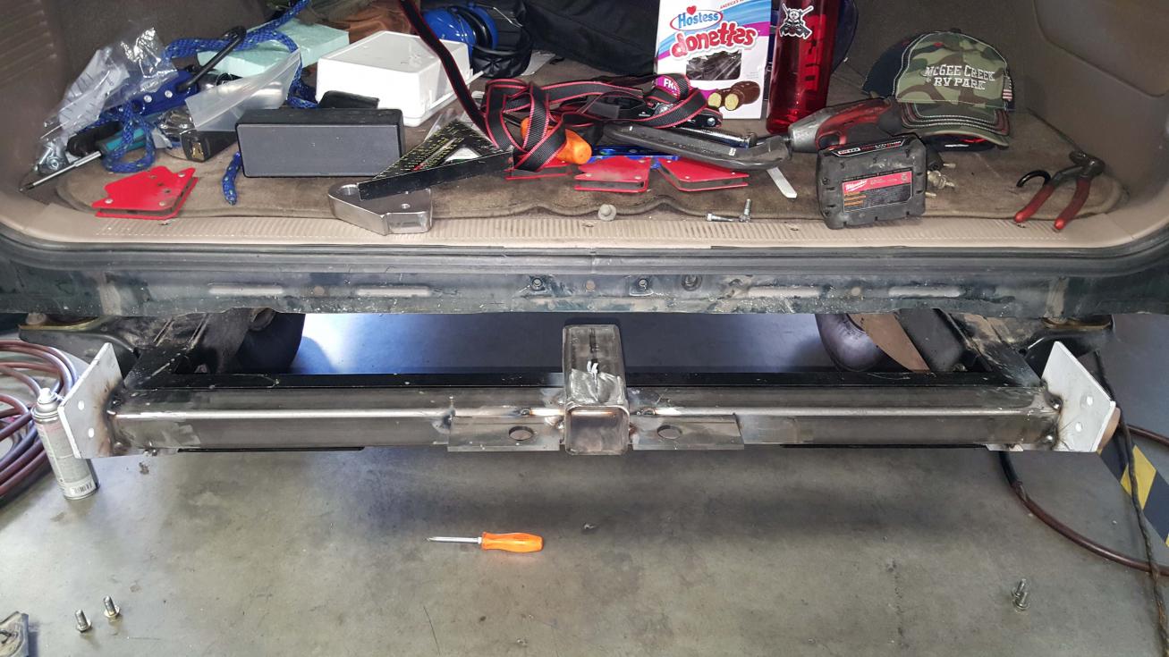

113 pounds fully welded and painted. I have some pics of the hitch bar, give me a sec to upload it.
Edit to add pics. Last pic is the f-150 tank mount.

thank you. although why does it look like the last pic is a completely different setup?
the first 3 pics have a piece of square tubing with a hitch receiver welded on top and two rectangle pieces with holes in them. the last picture shows a piece of metal welded in that has a"C" style extrusion and has a lift or offset in it. it looks like its a completely different setup.
The 40" tube is the hitch mount, that part gets welded into the bumper pieces. The f-150 tank mount has 4 nuts welded into it to mount the bottom half of the bumper to the f150 tank mount and the 4 side bumper bolts. The bumper itself is completely independent from the f150 mount minus the 4 horizontal bolts and 4 vertical bolts.
The 40" (don't cut the tube to 40" measure your distance first!) Tube is internal structural strength to the bumper. I was cornfused at first and had to figure it out while I was welding it all together. I don't know if I have better pics but I'll check. When I uploaded the pics they were in order but once uploaded they jumbled the pics.
That last pic with the raised center section is the f150 tank mount. I don't have any more pics. Had to finish vs stopping to take pics.
The bumper primary mounts (what the 2x2" tube is welded between) bolt through the rear crossmember after it is welded in place between the factory frame rails (the C channel in the last photo with the 2 vertical holes on either end)
- plus the 4 smaller horizontal holes along the bottom, as mentioned previously.
The 40" tube is actually 1020mm ;)
