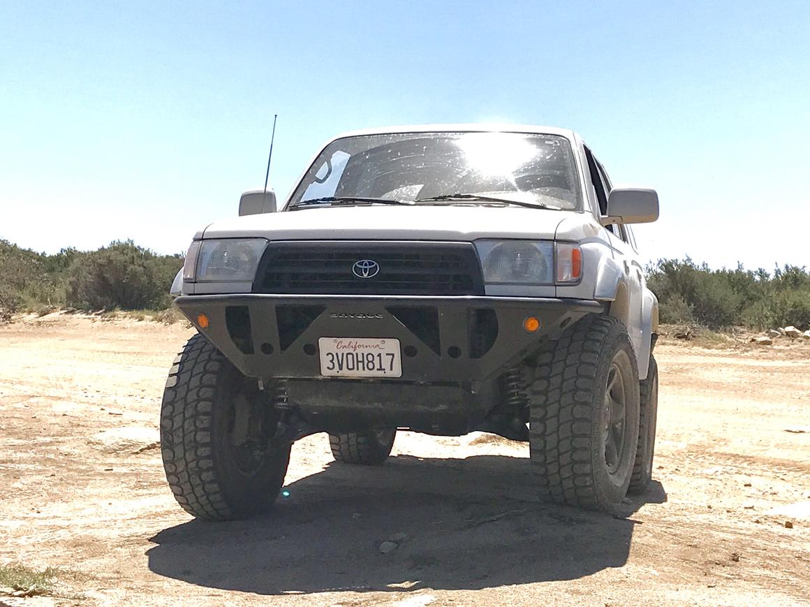

FWIW, I make weld-together bumpers specifically for the 3rd gen 4runners. The pricing is about the same after exchange rate:
https://www.coastaloffroad.com/3rd-gen-4runner/3rd-gen-4runner-high-clearance-plate-bumper-1

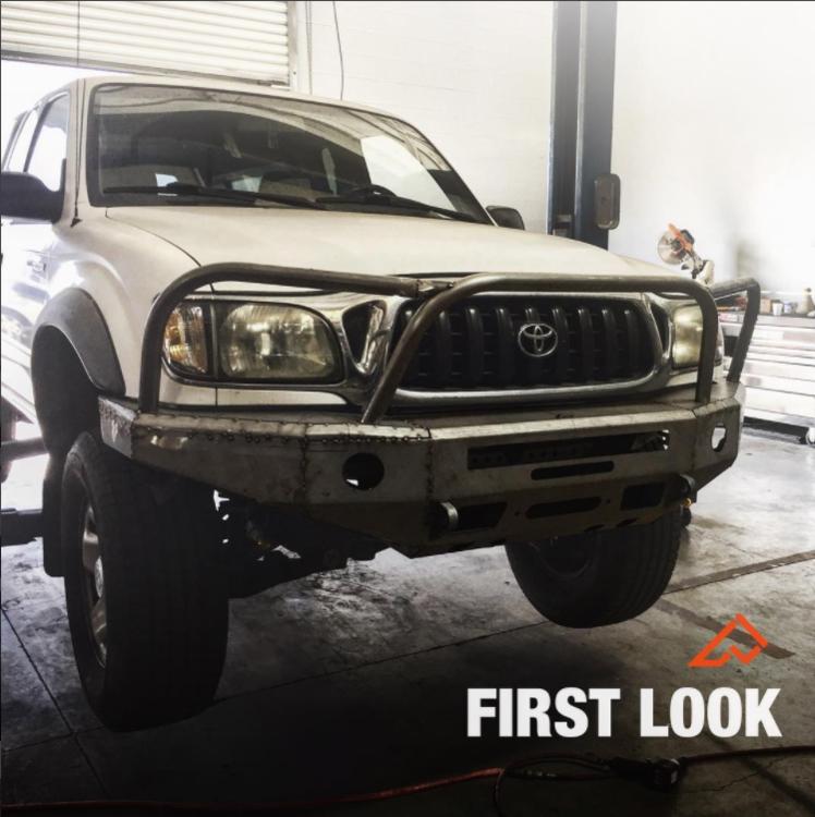

Just saw this on the Pelfreybilt Instagram page.
I've always loved their bumpers and wished they made ones for our 3rd gens, so it makes me excited to see we'll probably get bumpers from them soon!
