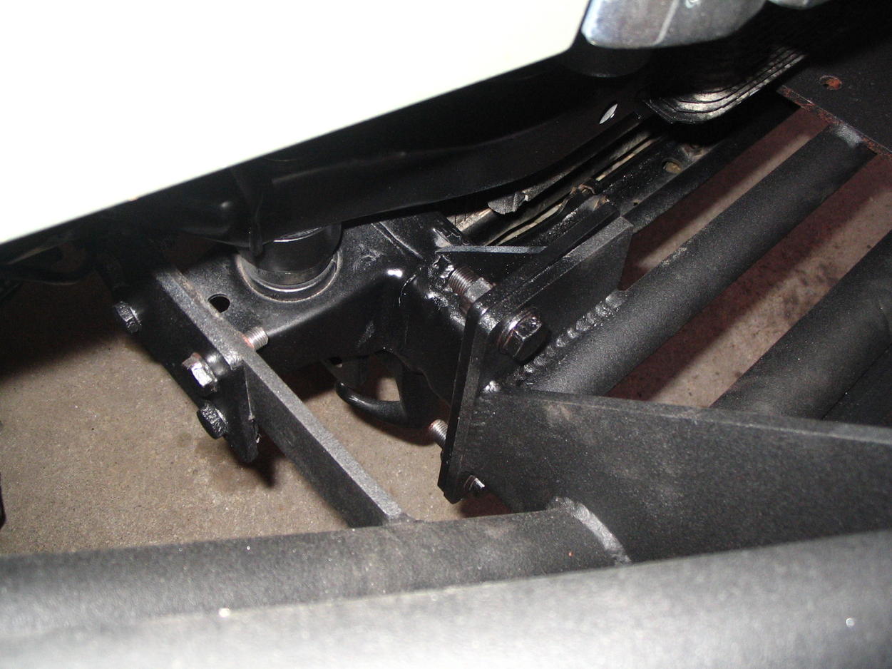

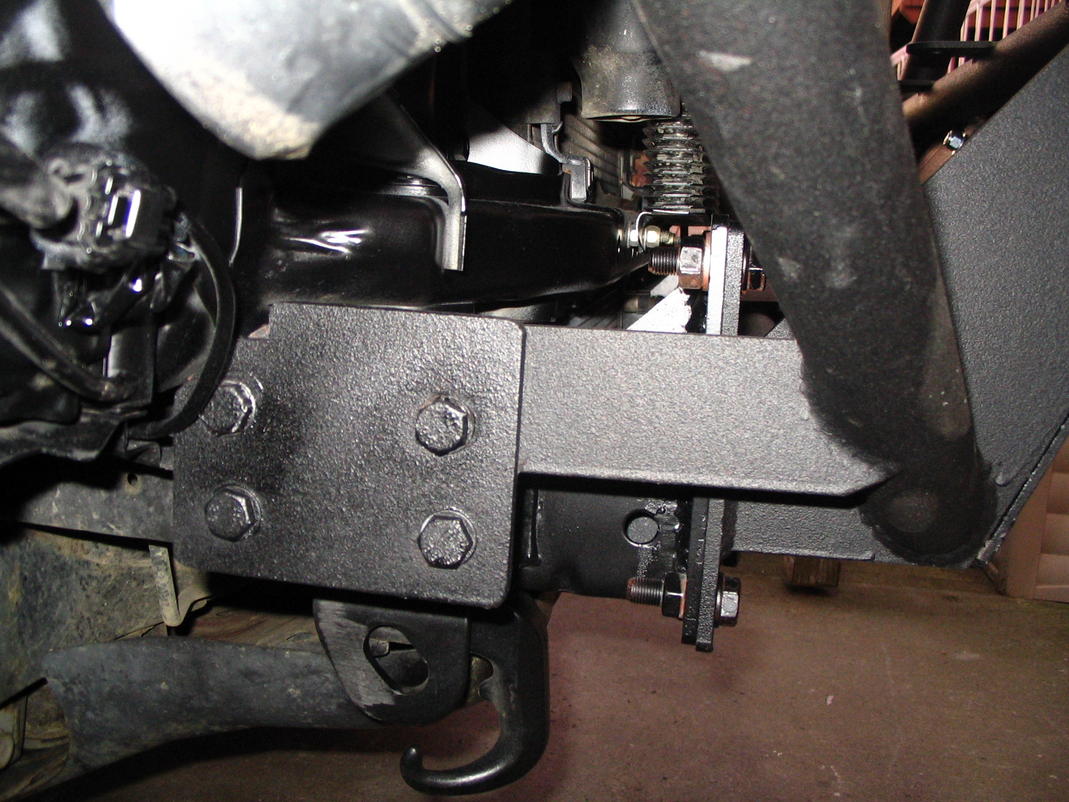

Any recommendations for the install
Buy a sawzall and fine tooth metal blades if you don't have one and attack the frame end flanges from head on. I was able to retain the part of the flange that caps the frame this way.
You can disregard that if you are doing the end cap mod. I have not done this but for winching it is recommended:
Frame Endcap Mod for Winch Bumpers | Northwest Toys
After installing the brackets- to position it thread in all three bolts on each side but leave them loose and then use a jack and wood blocks to get it where you want it.
