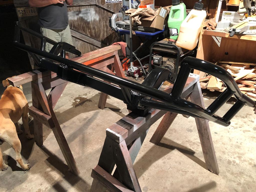

Bumper is done... For now. I'll install it when I get back from a work trip later this week. I also ordered some 3/4" led lights to install in the parking lights for blinkers.

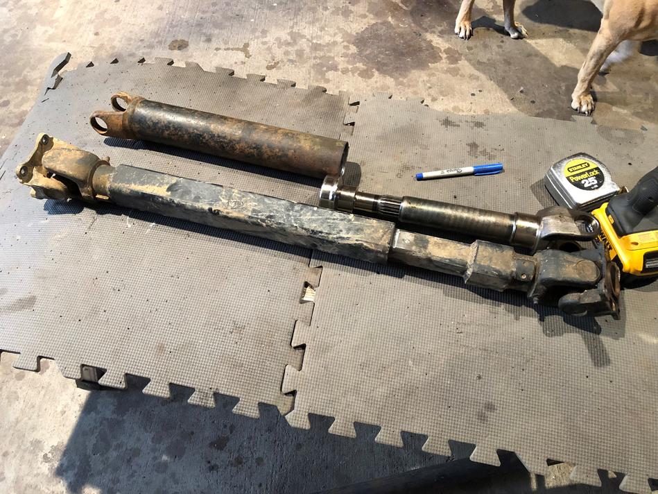

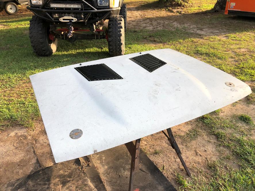

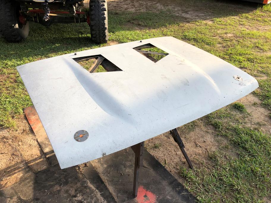

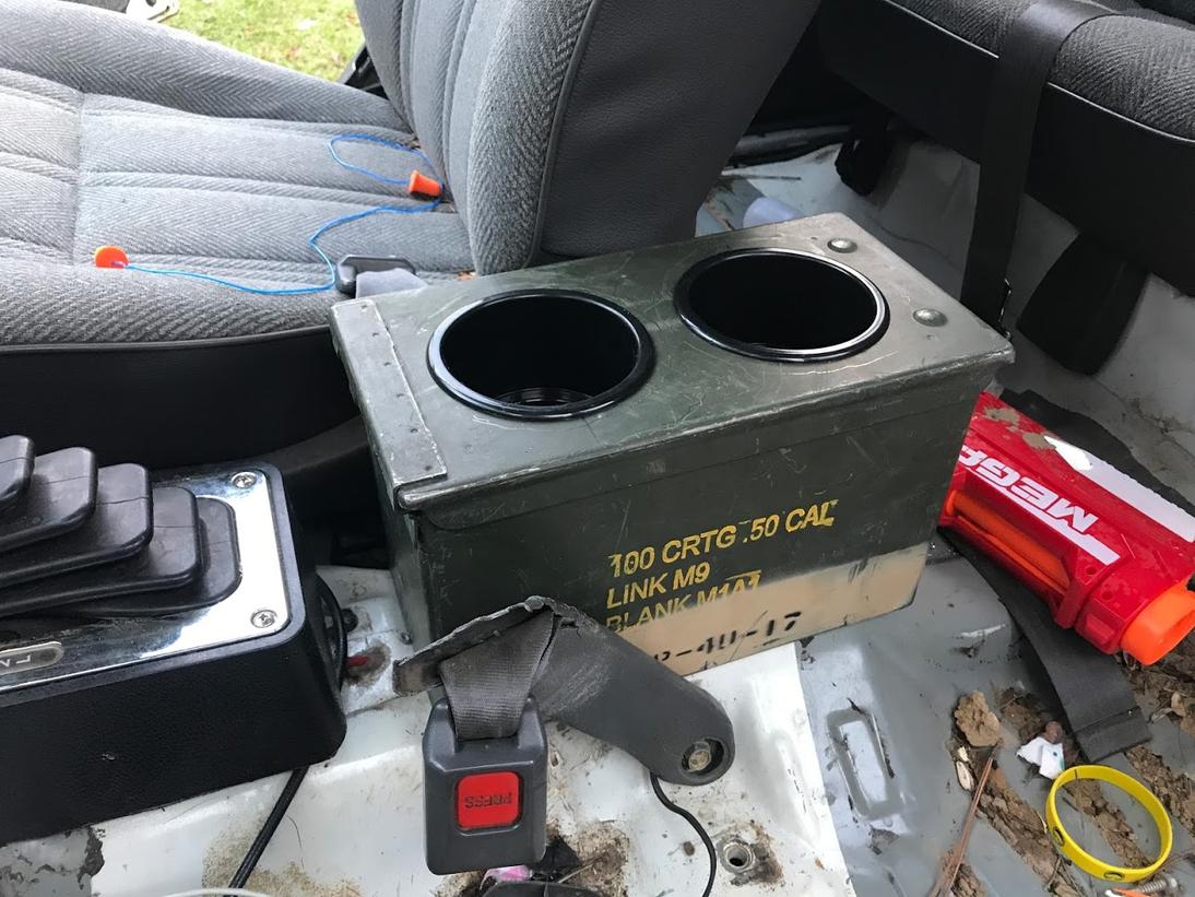

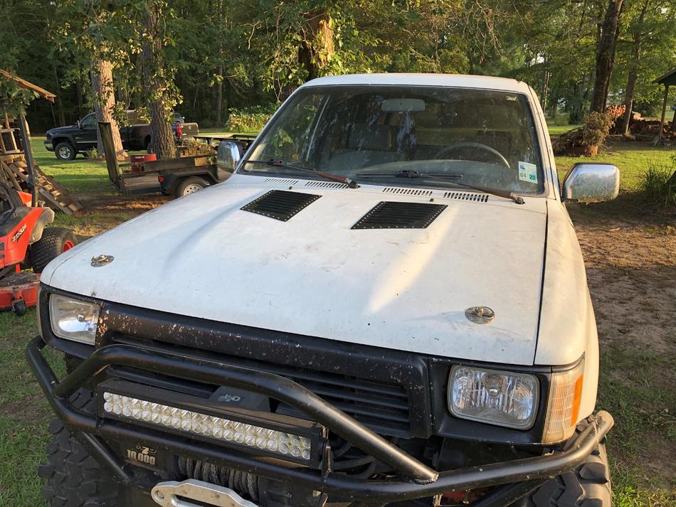

Its been a little while since an update. Im currently getting this thing ready to go to Colorado for the trail riding next week. Ive built a rear bumper, added hood louvers, added an army can center console, and started working on a new front driveshaft using a marlin long slip.

Question on your hood vents, obviously rain would get through them but how much other crap gets in.
I have a set I bought for my last project I was debating about installing on my 94 to help vent heat.
Great build!
Thanks. I haven't noticed anything else getting in other than rain.
