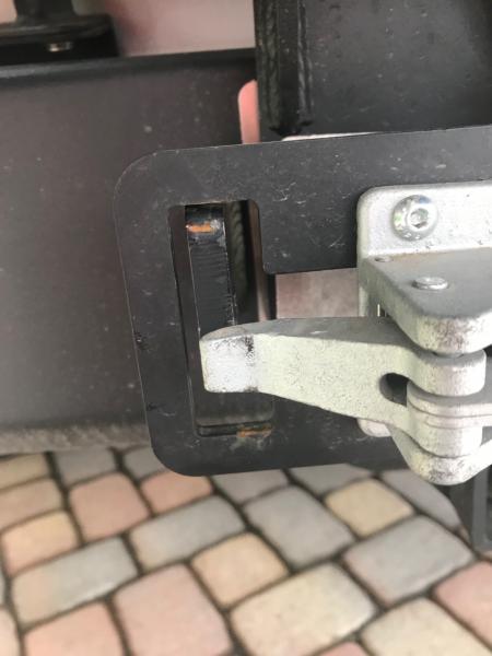

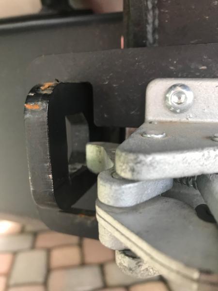

Got my C4 rear dual swing bumper/tire carrier installed this winter and due to a VERY active ski season and an unexpected problem with one of my pups, haven't gotten around to messing with this much. Bottomline, my tire carrier arm sits about 3/16" low and requires me to literally lift the entire arm to get the latch to engage the opening. My install shop took it all apart and reinstalled it to verify they didn't mess anything up, and suggested I contact C4 about it. Picts sent, but no help so far.
Anyone else have this issue? I have 2 bad shoulders, with 1 ready for a total replacement and the other scheduled for major repair, so lifting the swing arm with my spare SUCKS (and broke the handle/latch mechanism - roll pin fell out and now held in place with gaffers tape)! Between this, the general lack of engine power in the mountains, and the constant creaks from the rear bumper and suspension - has me wondering if my T4R is better suited for trail use and not a DD with 4 hrs drives back and forth from Tahoe 2 times a month...
Help or suggestions appreciated.

Cut off the loop plate welded to the bumper and weld it 1/4" lower. Or use a die grinder to trim the inside and angle grinder to trim the top.
That's the two options I see.
I don’t know, maybe temporarily but if the swingout used to be aligned then something is giving-way. I’d hunt down what’s sagging, my guess is it’s the spindle tabs...
The spindle is double sheared but, from what I can tell, those tabs aren’t fully gusseted, at least not externally. I’d seek out a fab shop to assess... if it is the tabs they may be able to press them back, realigning the swingout, and then add some extra gussets to try and prevent it from occurring again. If that’s what it is. Maybe try opening it up and rocking the swingout to see where there’s play.
Reading your first post it sounds like this was a problem from the start. Has it always been aligned wrong?
If so, when they welded the mount to the bumper the alignment would be off causing this issues. Could be a QC issue. That mount is easy to align wrong. The fix would be to cut off the mount and get it welded properly aligned with the latch.
I would have to agree it's a QC issue. The latch tab was off when I picked the truck up with the stock spare on it, and didn't get any worse when I mounted my oversized spare on a much heavier rim. The unit seems stout and well built - just misaligned.
I guess it's off to a fab shop. Didn't realize my fancy bolt on rear bumper had "some cutting, welding, and fabrication required" to get the install correct. :rolleyes:
