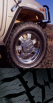

I guess it would be better to call it an aggressive all terrain although it looks alot like a mudterrain....
still looking for some help with the lifting...
Lee

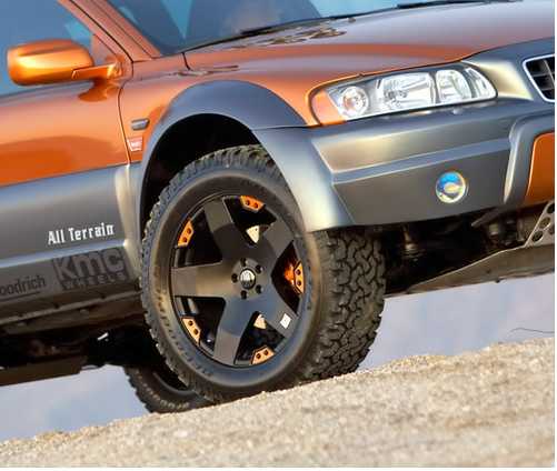

These aren't mud terrains, but I think this is what he's talking about. Here is a pic of 20" BFG A/T KO's. BFG actually makes the All-Terrain T/A in a 285/55SR20, 325/60SR20, and 37x12.5SR20.
