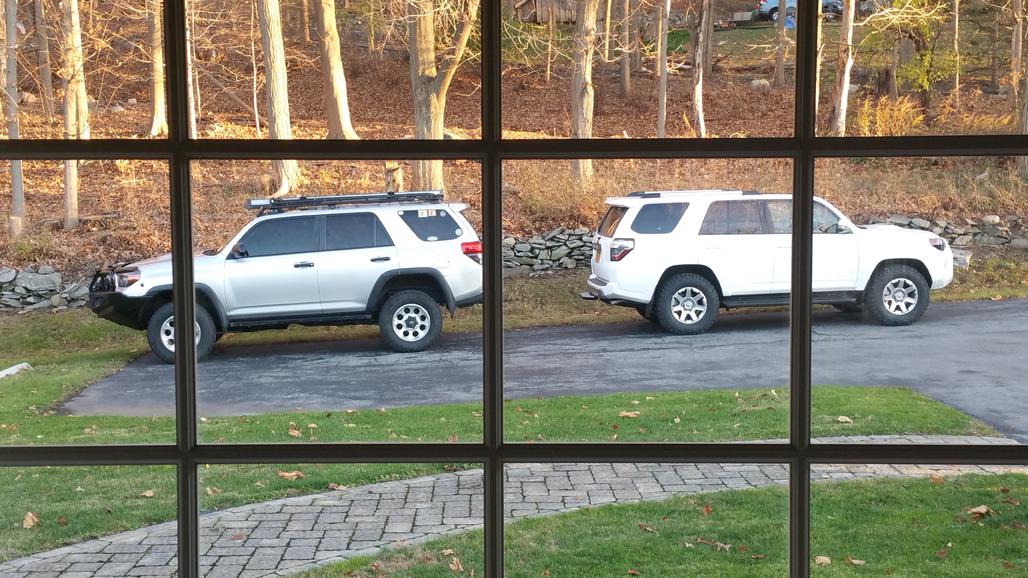

Thought this might be an interesting take looking outside. ...265 Revo II's on the 10'..... compared to the 275 KO2'so on the 16'......
Personally, I see a huge difference without whipping out a tape measure...

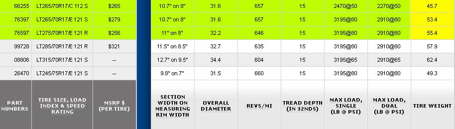

You need to compare apple to apple. The weight difference is between C rated 265 and E rated 275. The weight difference between E rated 265 and 275 is only 3 lb. Now can't find a source of number of "plys" in each version of KO2. But if the design of E rated 265 is the same as 275 you can put E rated 265 to have the same size as stock Dueler and toughness of KO2 275.

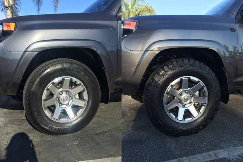

Found another picture on the forum showing the difference between brand new stock Dueler and KO2 265. It's not only size that matters :reddance:
I think you are wrong, I looked this up on the BFG site. 9-10 lbs difference on the KO2s.

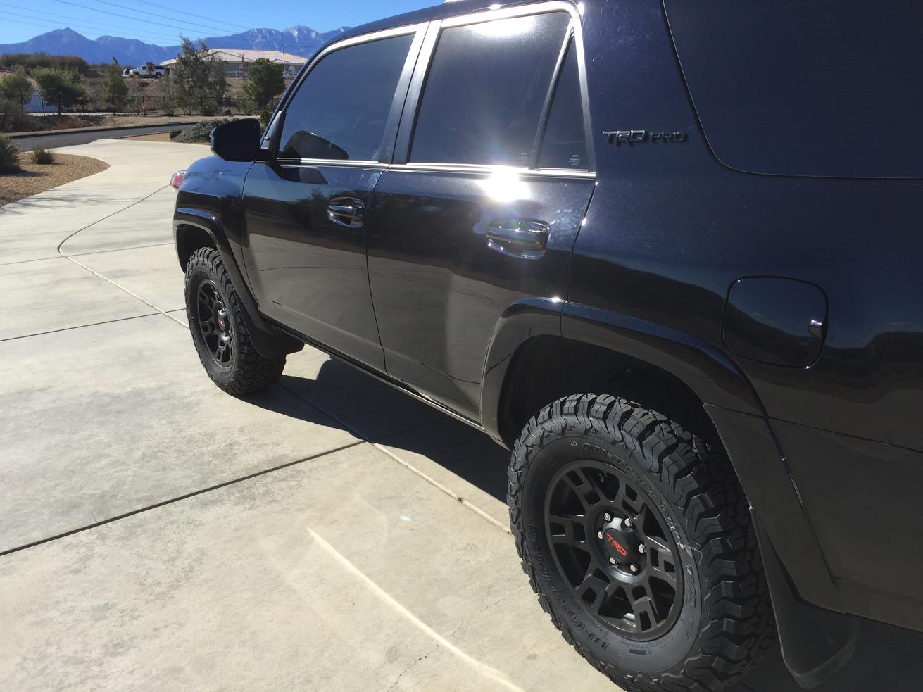

I went with 265’s for various reasons:
Did not want issues with rubbing at any position.
I may need to run with chains on all four tires and the extra clearance is needed.
Did not want to deal with variation in speed and mileage data.
I’m pretty much running the stock TRD suspension, these tires are heavy enough, I don’t want any more increase in mass that will stress suspension components, I’m hard enough on it already.
……Ya, they look small
Everyone has their own set of needs/constraints when making decisions like these. It really comes down to defining your personal needs and situation. For some, 275 or bigger is great and fits their particular set of circumstances.

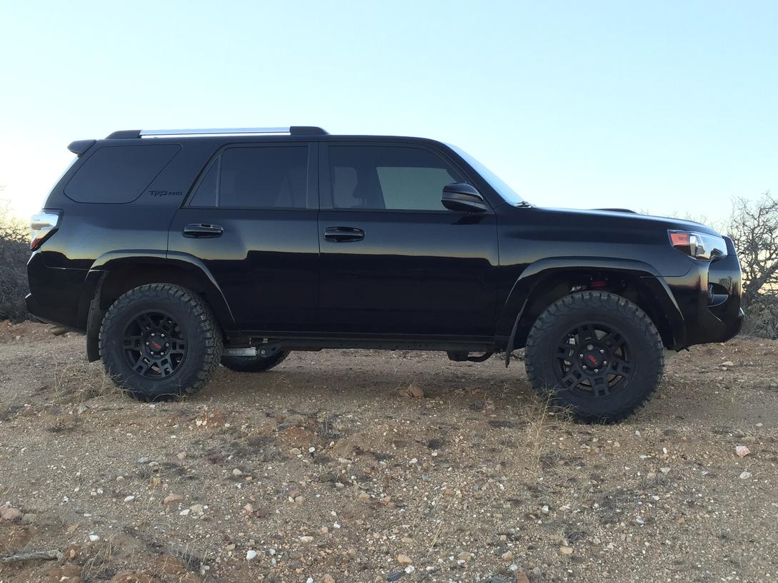

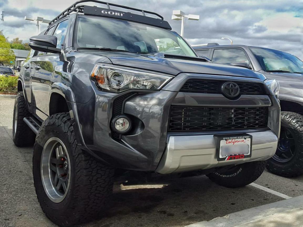

Okay, time to bury this thread.
They look lovely. Your pictures are convincing me for staying with 265.:yo:
