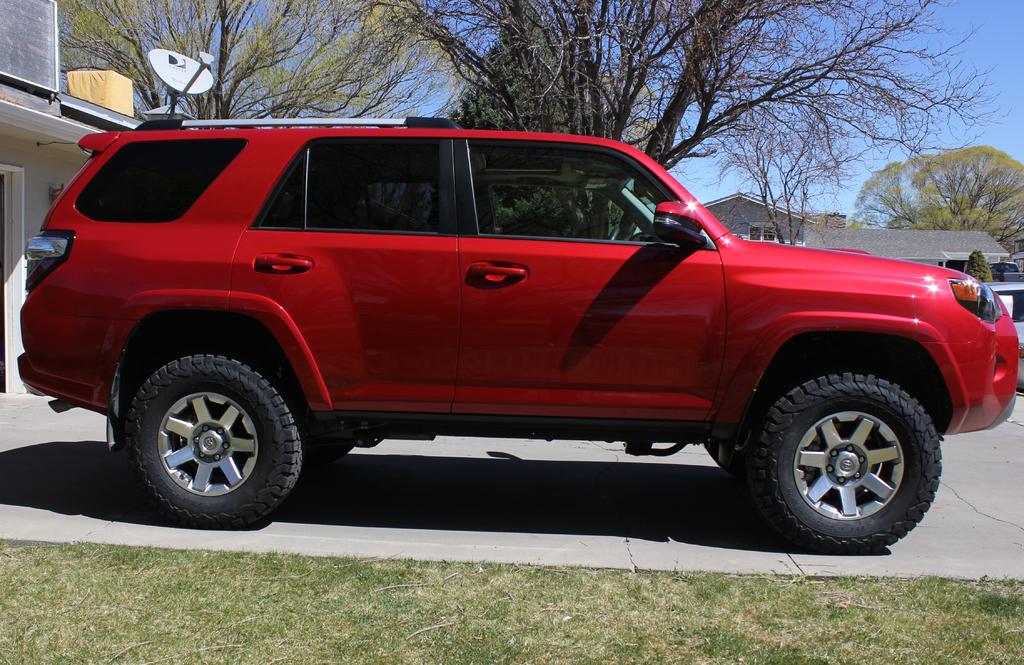

I went with the 275's....
The tire dealer gave me $250 for my stock tires with 5500 miles on them. I might have been able to get more from them selling them on my own, but didn't want to deal with the hassle of Craigslist, etc..
The first thing I bought after my new 4Runner was Bilstein 5100 series shocks. I HATED the stock shocks (nose dive, etc.)!! They sat in the garage for about 3 months, until I could afford the new tires. A couple weeks ago I had everything installed. I think the 4Runner looks better and I know it rides WAY BETTER!! I noticed about a 1gpm drop in mileage. I can live with that!!

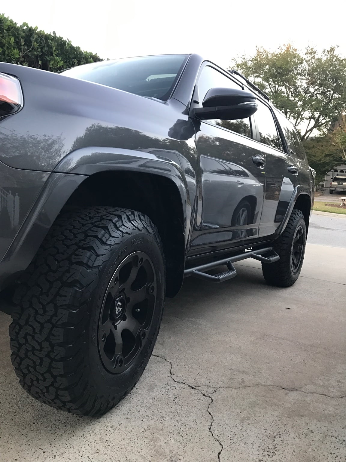

I put 275's on the second day i owned my 16 TEP and I don't regret it at all. Would i likely have liked the 265's just as much? Probably. Doesn't mean i don't like the 275's I can say when you put them next to the 265's there is a difference.
Even my wife looks at her truck and said she needs bigger tires, haha. We will probably upsize the next time around.
I struggled with the same decision and must have read about a million threads to realize how dumb I was haha 6 months later and I havent thought about it since. I went 265 and love them. I get compliments all the time on my "big tires" ha. They do give the truck an entirely new look. I didnt think the drop in mileage, acceleration, or performance was worth it to ME. But to each his own, get the ones you want and dont think about it again.
