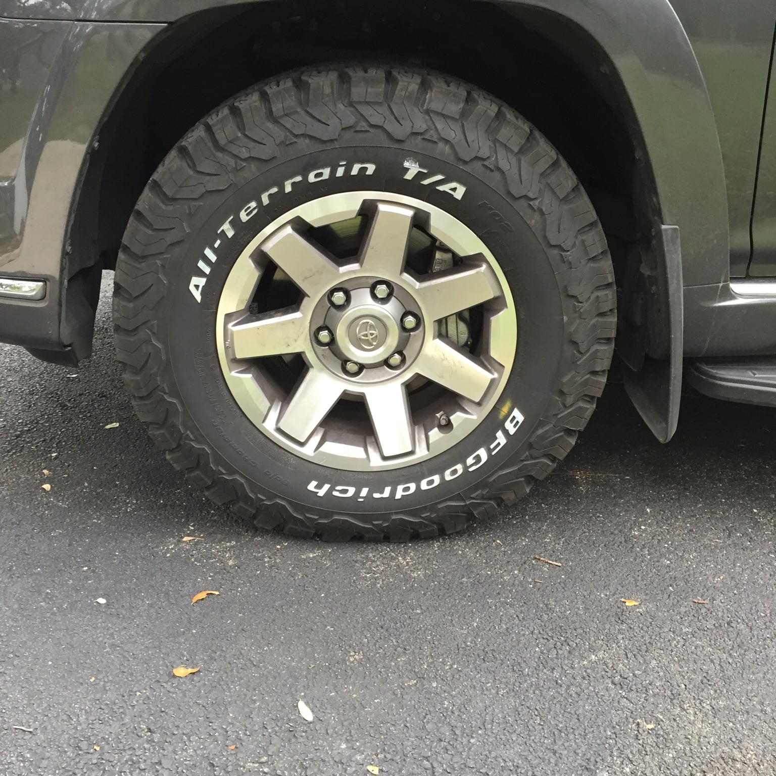

So do you have side by side picture of your truck with KO2 265/70/17 and KO2 275/70/17? I'd love to see this "big diff" myself.:hurt: In pictures above the only difference I see is black and white letters, and I guess the black one is 275 only because you posted a picture with white letters before, which I guess was taken when you had 265 installed.

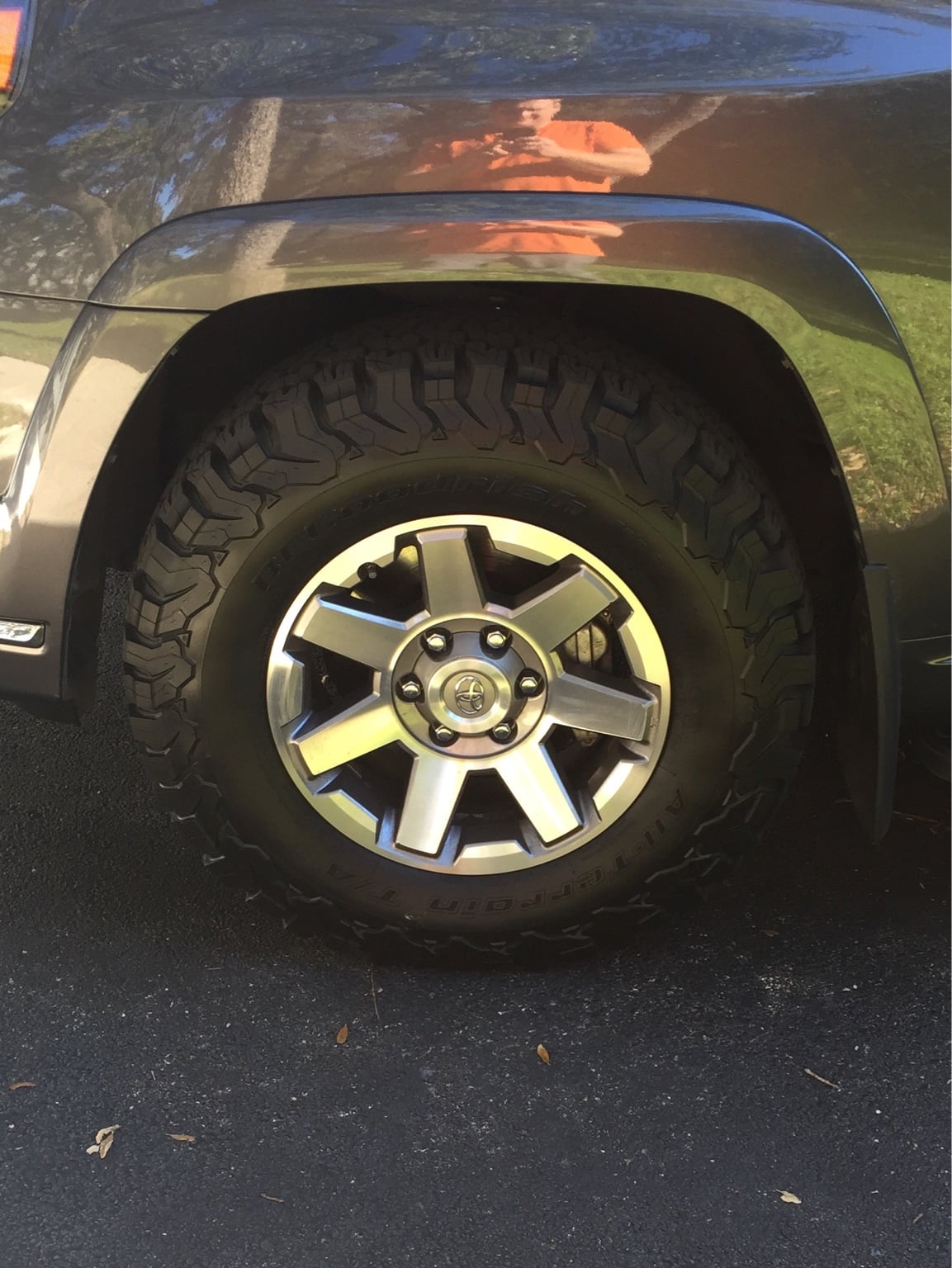

since the white lettered tires are 265's and is an old pic, why not take a picture from a similar distance and angle so we can all see the difference, posting them side by side. it's a bit hard to compare when the 2 pics are different sizes, angles, distances...just a suggestion. whenever it's time to replace my stock tires, i'll be looking at the ko2's so this will help. thanks.

on the truck the 275s look just a little bit bigger. - my wife even noticed , she said looks way bigger ,she could care less .

Little rubbing at full lock yesterday ,on the stock trail wheels . You can feel the heavier tire just a little but it's not even enough for my wife to notice when she drives . Gas is a little worse maybe 1mpg less but is a limited with a Roof basket but it's never been great.- not a hybrid lol . I have some after market wheels on the way to offset the extra 9 lbs difference and take it down to only 3-4lbs heavier than stock 20" so we'll see how that goes .
Also where I believe where you see the difference is how tall the tire is on the truck due to side wall bulge 265s 30.25 inches tall @ 50psi
275s 31.5 inches tall @ 40 psi

I hope this helps everyone with there decisions

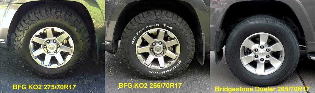

Thanks buddy for these pictures. They made this thread the best on the forum regarding KO2 265 vs 275 discussion. Really, I mean that.:bravo:

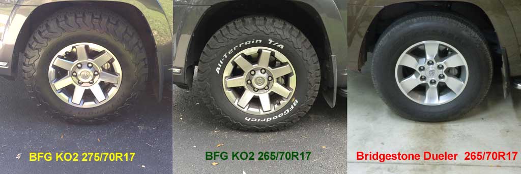

So the only way I can top it off is to add the third picture showing the stock Dueler on SR5 (not limited) I took this morning. I tried to show the tire at the same angle as your photos. To make the comparison easier I photoshoped the color of my truck (mine is burgundy) so it matches yours. I also photoshoped the color saturation on you pictures so colors and contrast not play a significant role for the comparison.
In my mind there is a slight visible difference in overall look of KO2 275 vs 265 but when I look at details (like the tire fills up the wheel well or the thread shape) they look almost identical. For some that "overall look" may be worth that extra 10 bucks per tire (at 4Wheel) but for me your comment about the weight and rubbing makes it no-no decision. On the other hand any KO2 size will look absolutely better than my stock Dueler. I love Toyota technology and reliability but some guys in the sale department should be fired for their idea of destroying the awesomeness of the truck by putting Bridgestone tires.
The last note, when you compare the gas mileage from 275 tires to 265, you need to increase the value shown by on-board computer by about 2% to compensate for diameter bigger than the on-board computer was calibrated. So if your truck is showing 18.5 it is really 18.85mpg
EDIT: Fixed image (Wrong tire size in center image description)

Is that middle picture actually 265?
Sorry, thanks for pointing it out. The description was wrong - I just fixed it.
Now I realized the KO2 pictures show front tires and my tire is the rear one - To have compared apples to apples I will have to fix my picture again :doh:
Here are three front tires for comparison:
