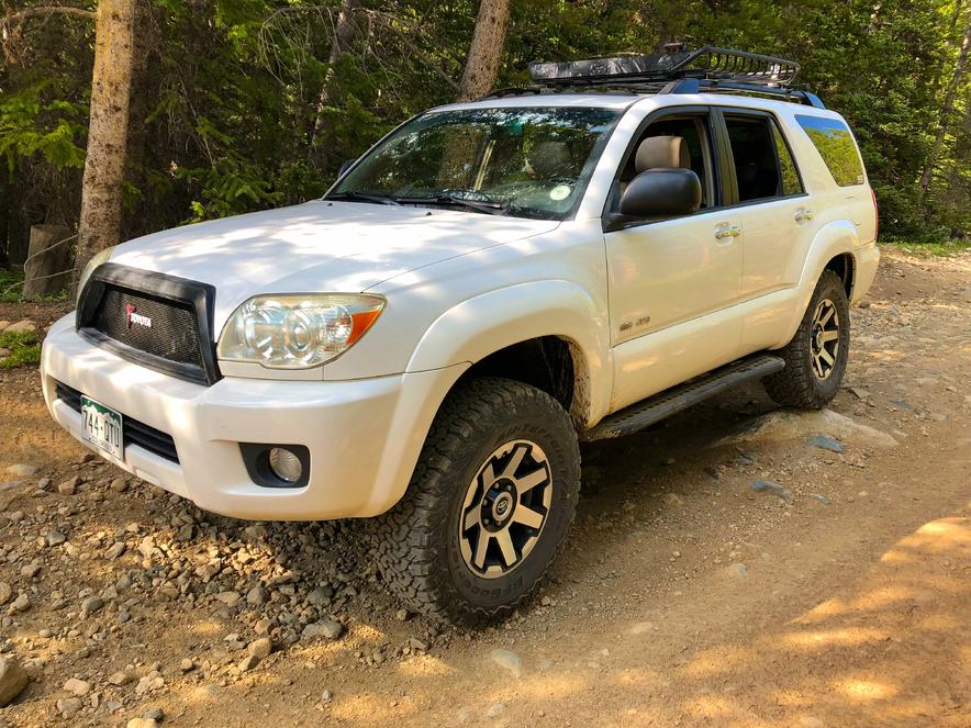

I have the FJ wheels on mine, which I believe are the same as the 5th gen TE wheels. I run 285/70/17 Cooper ATP tires, with ~2.5" lift. I did have the stock bumper on with the lift/tires previously, and did the fender liner trim for clearance. Didn't have to do the body mount chop for daily driving, haven't done any high articulation offroad to know if I need to chop the body mount. No rubbing at all.

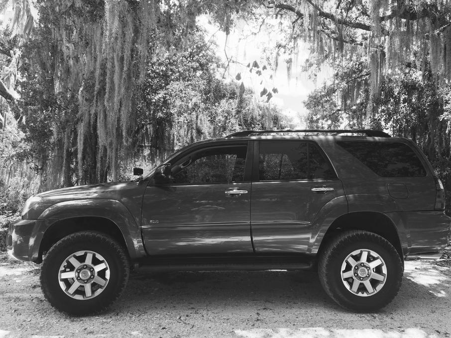

285/70/17 on my 2007 SR5. They rub, even with 3 inches of lift and a 1.5" body lift. But they look awesome, so it's worth it.

Where do yours rub? Curious since I have same size tires, with same wheels, and didn't have any problems after trimming the fender liner, even on less lift.
I'm assuming FJ Trail Team vs 4Runner Trail Edition wheels are the same width/offset, but I don't know if that is accurate.
Mostly the liners, which I've already pushed forward and the frame, which I've also trimmed. The difference probably has to do with the fact that I am running Spidertrax. They push the tires out another 1.25" and that creates more rubbing when turning the wheel.

Just installed these 5th gen TRD Pros today. I already had the small suspension lift, wheel spacers, and trimming completed prior to doing this.
Did these wheels come with the TPMS sensors and did the new sensors program to the 4th gen TPMS? Or did you have to use your old TPMS sensors?
