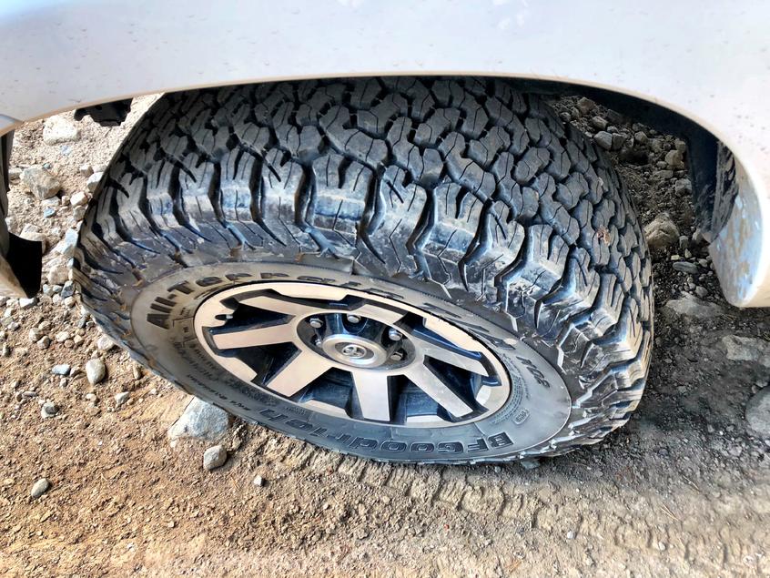

I paid $500 in Denver for brand new take offs, $575 isn’t a bad deal. My 285 KO2s fit without rubbing (without wheel spacers)after I pushed the wheel liner forward and slight trimming on the lower edge of the front bumper.

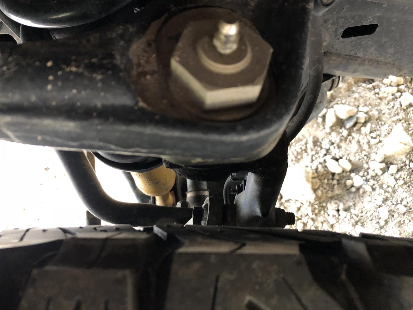

Also plenty of UCA clearance, at least with LR SPC upper arms

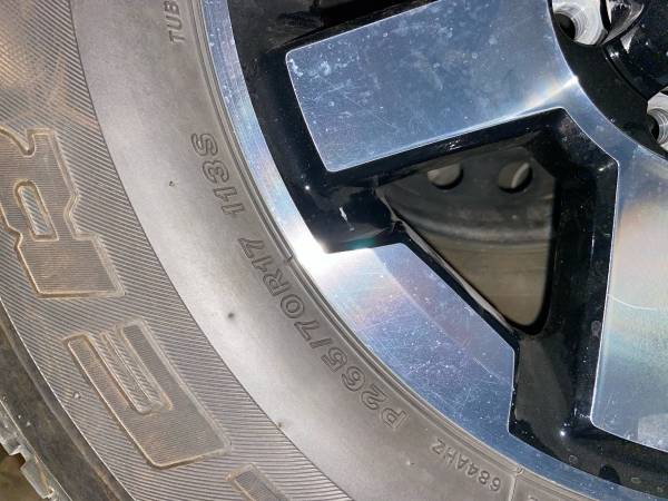

I'm going to buy a set of 2019 4Runner TRD Off-Road Premium today with 75 miles on P265/70R17 Dunlop AT20 Grandtrek. Wish me luck.

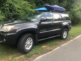

2012 FJ wheels with skinny tires
I went skinny with 255/75/17 on my FJ Takeoffs. I like these as they are not as common. The only lift I have with mine is FJ Trail suspension swap. So with the skinny tires and suspension swap, I have only about a 1 inch lift, give or take.
No Rubbing at all. I might go bigger after these Jeep tire takeoffs wears out but if too big and the 4Runner is too tall, I'll have a hard time loading my kayaks.
I got these for $600 and I almost feel like I stole them. I still have tread left on my stock wheels so I haven't put them on yet. Should I expect and rubbing on the front or rear?

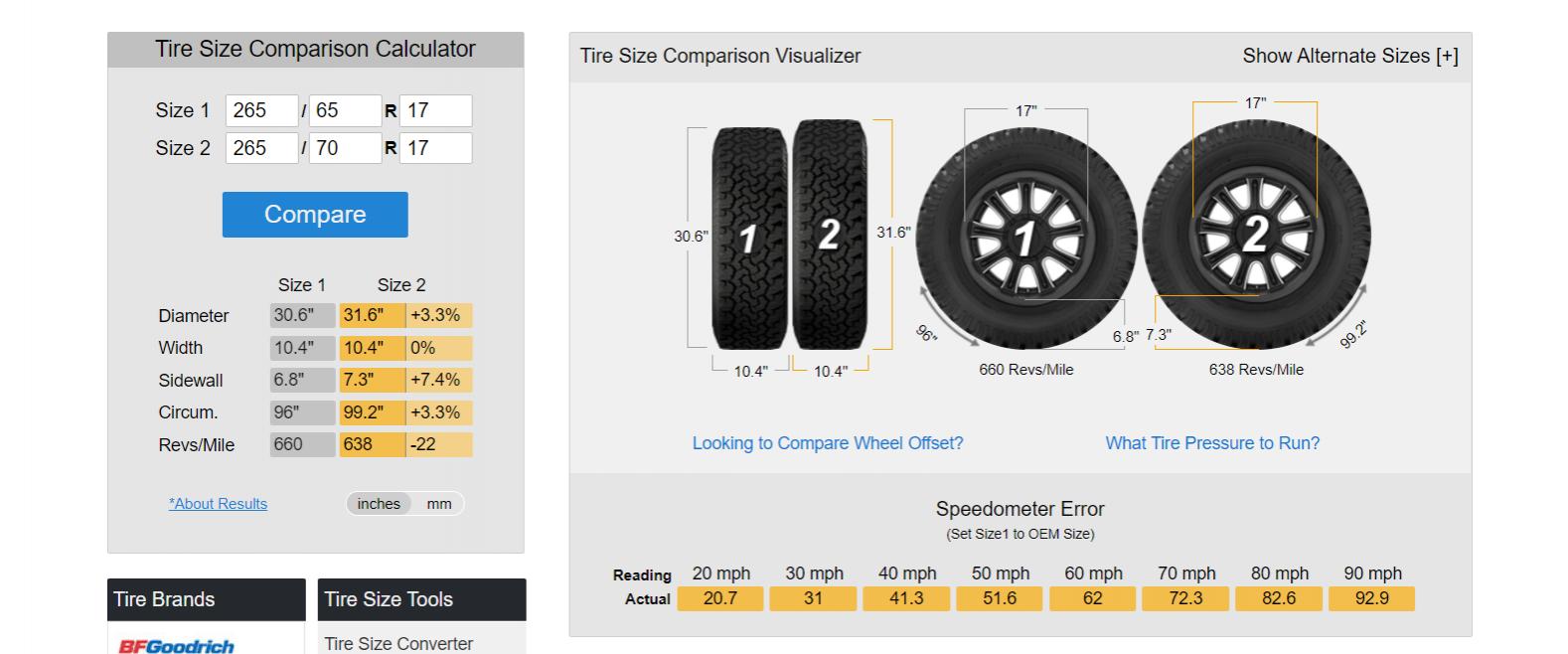

Sorry for nitpicking, but although the diameter difference is 3.3% the speedo difference would be less than 2% (considering it was reading higher to begin with the difference is less that negligible)

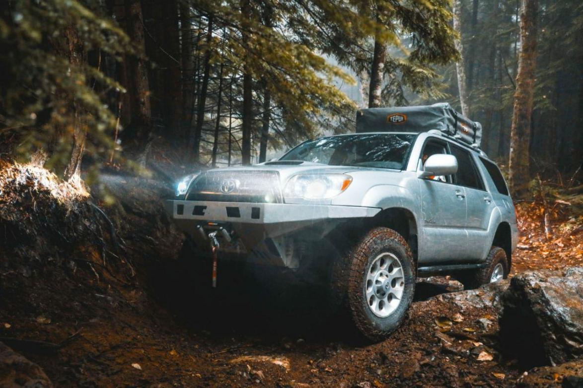

Have the same rims -- love this style.
Gotcha, I was just assuming circ_small=pi*dia_small and the bigger size was circ_big=pi*dia_big and the speedometer scaled off circ_big/circ_small. I have noticed on worn 265/65s the speedo read slightly under, so it makes since about a negligible difference. For curiosity sake, where can/how can I calculate how much the speedo is off by?

Hey, to be honest I havent dont math, I have used the web site:
Tire Size Comparison
It has proven to be fairly accurate in its assesment when I compared my speedo to a GPS.
