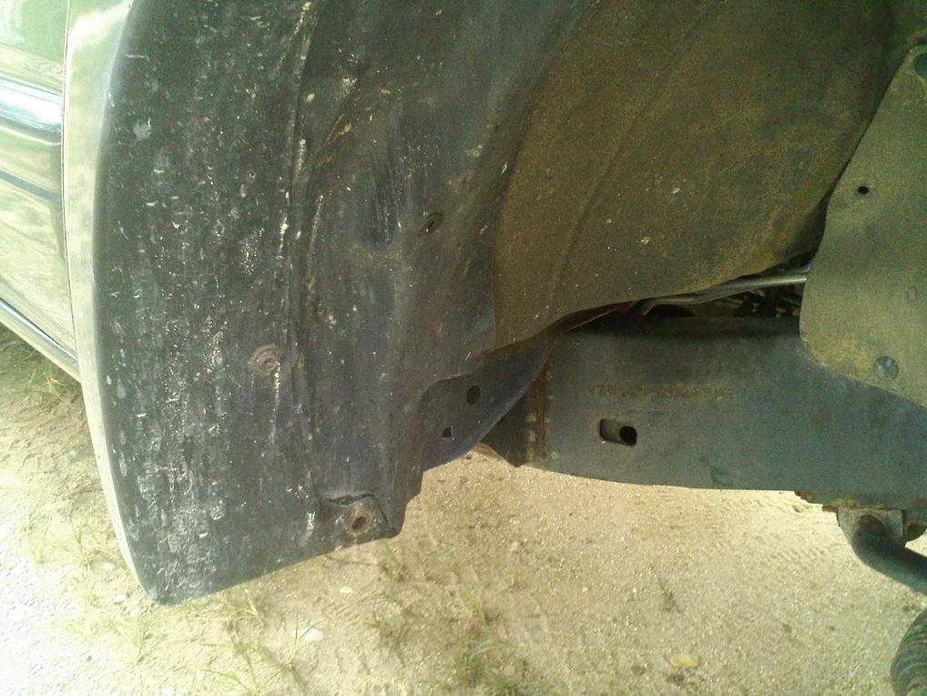

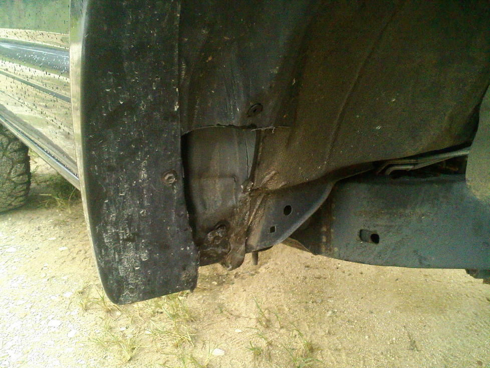

Can anyone post photos of 255/85/16 on their 4runner?
Where is the pinch weld located? Anyone have any photos of it pulled back.
Thanks everyone!
can anyone post photos of 255/85/16 on their 4runner?
Thanks everyone!
