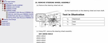

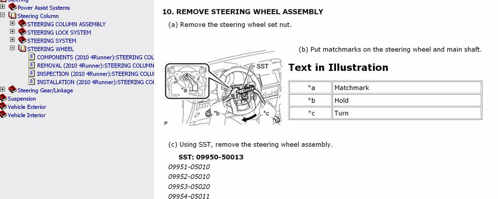

It does have to be marked first so it goes back on the same.That's why they were supposed to put matchmarks per the repair manual before removing it so it goes back on in the same orientation.Service guy is the idiot.....
From the repair manual
1. INSTALL STEERING WHEEL ASSEMBLY
(a) Align the matchmarks on the steering wheel assembly and steering main shaft assembly.
