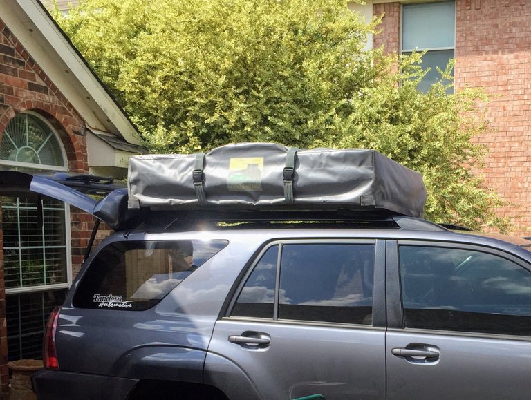

Here's the only pic I have right now of the tent rails bolted to stock (Limited/SR5) roof rails, we haven't mounted the tent for the summer yet:
The tent rails effectively become your crossbars when mounted this way, and allow for a lower profile than when using stock or aftermarket crossbars (plus you don't have to buy anything extra to mount your tent).

So I just got my CVT and got it up there on the factory rails that run parallel with the vehicle and bolted it there. I'm having some issues getting the annex room into the channel due to the bottom of the tent bars/rails that run perpendicular to the roof rails sticking out so much further than the roof rails (did that make sense? Did in my head..). I'm going to go back out and try and put the cover on (cause that's more important than the annex).

Yeah, to mount the tent like I did and have it open to the side of the vehicle requires trimming the tent rails a bit. I had to trim them flush with channel side of the tent in order to be able to easily get the cover and annex on and off.
Since you're eventually getting a different rack though, I'd hold off on modifying the rails until you have the final setup ready to go.
