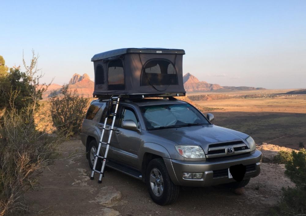

I put a cascadia St hellens RTT on my stock 03 runner. Its not ideal, at all. In windy areas it flops around a lot, and dramatically reduces MPG. Some days IM doing 18 mpg. other days I’m doing 15 mpg. Not sure if having it snug on a stout rack would make a different but it seems like it would for me. There’s also a lot of wind noise.

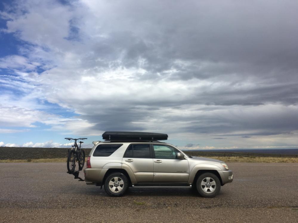

I have a Roofnest and use the factory roofrack with Yakima crossbars. I have not had a problem camping at state parks, national parks,or dispersed sites using my rtt.

Thanks, do you have one with RTT closed? trying to gauge if I can avoid a low rise roof rack for want to keep a both low profile and lower weight.
You mean if you can use the stock rack?
It bounces around A LOT in high winds. I wish I had a more rigid rack.

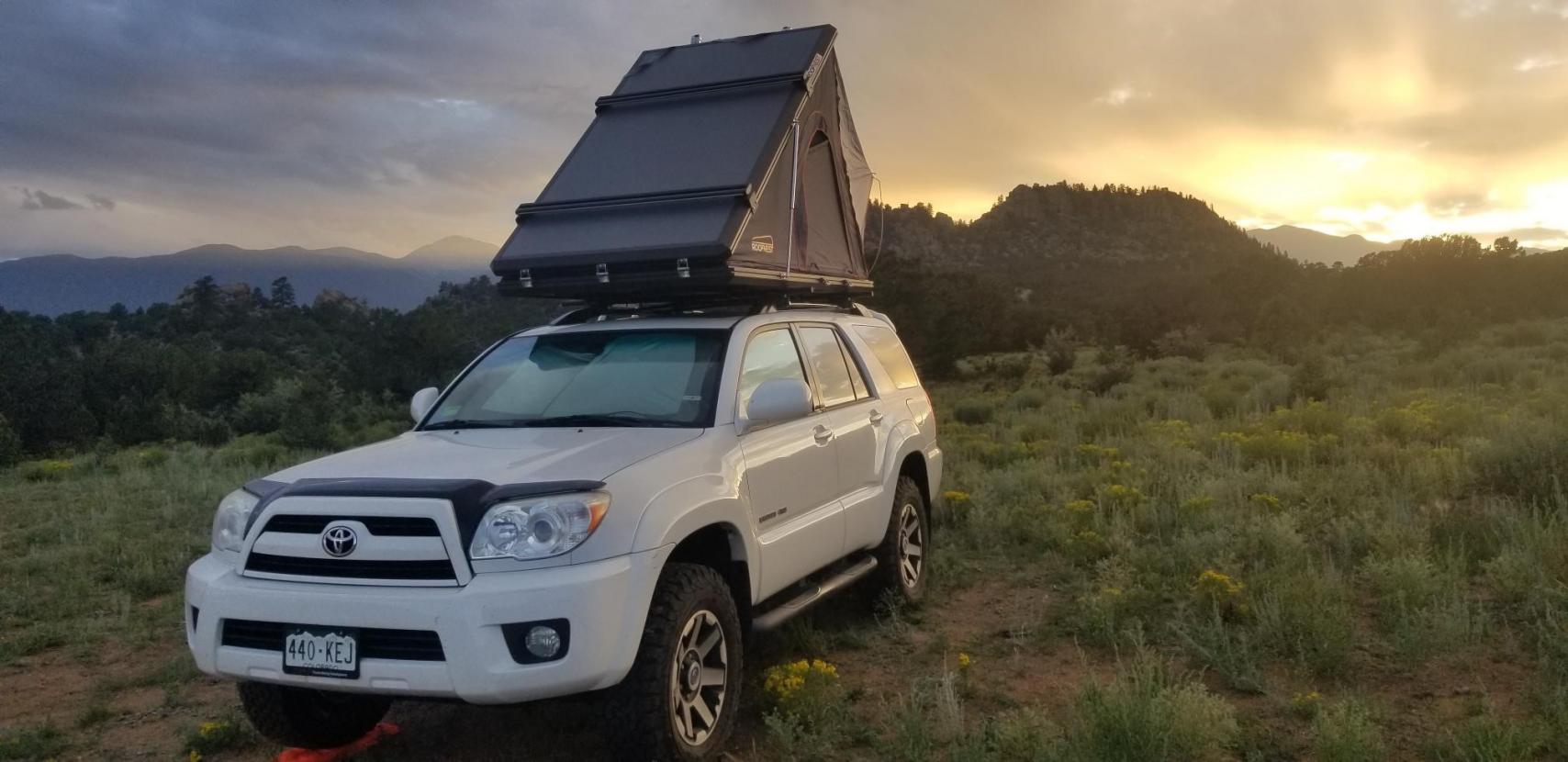

To be fair.. your RTT is probably one of the heaviest options to buy. My smittybilt was only 150lbs, the MIA overlander that is a hard shell is up to 250, wouldn’t be surprised if you’re over 300lbs on that ?
Yes, didn’t know it’s that bad. Buying a rack and filling it with a RTT have felt is a waste of money. Btw what RTT is that?
It’s the cascadia St. Helens. Just looked at their site and they dropped the price by $1,000 which kinda sucks because I’m trying to sell mine. Selling because I’m to a city and having some issues with the 4runner. Makes camping a lot more fun tho!
Website says its 150 lbs without the ladder. Wasn’t too heavy lifting it overhead, just awkward.
