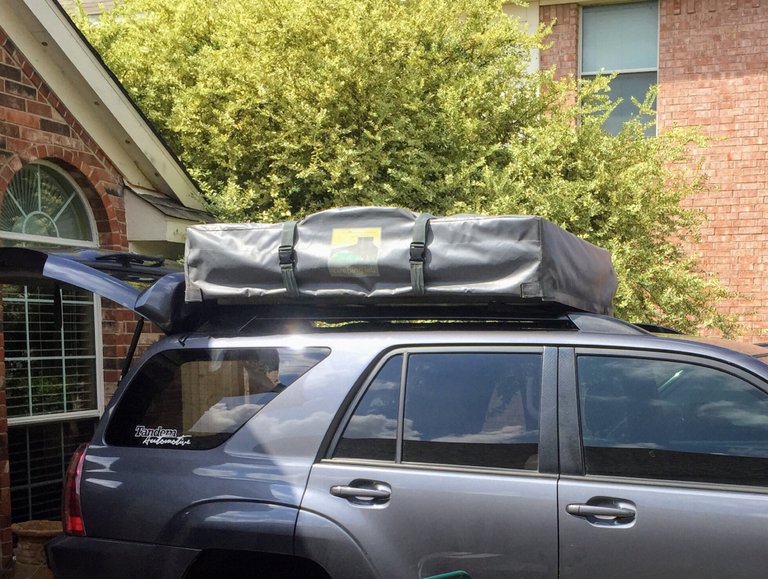

I just want to check in and say after 5,000 miles with a Tepui Ayer attached to the factory rack, we decided to throw down for a Thule Kit to put on my old bars that I had laying around. On our last night on a trip we had some flex from the stock 4runner cross bars that just made it feel a bit weird and since we have the Thule bars already, we figured we might as well have something a bit sturdier.
Also, mounting the Tepui on the stock cross bars was a huge pain in the ass... and truthfully it took way too long to put the thing on, which is why it stayed on for so long.
That being said, the low profile was nice and I'll post some updated pics and a review after next week when we head out for a quick overnighter with the Thule bars on and such.
Here are some pictures with it mounted:
306A7638 by Andrew Villa, on Flickr

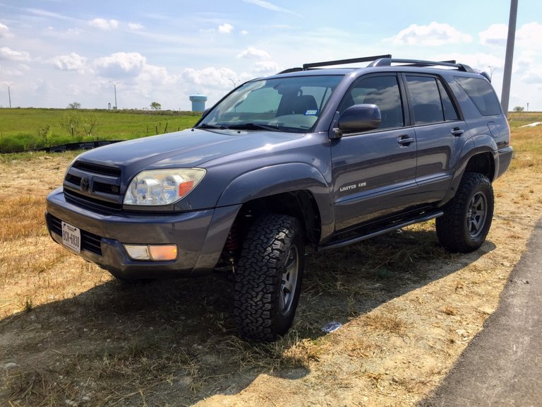

Factory Roof Rack
I'm debating just buying 1" x 3" 80/20 T-Slotted cross bars, which are pretty much what are used on Prinsu Design and FR roof racks, and just attaching them to the my 2007 Limited factory side rails. They should be stronger than the factory cross bars and the factory side rails seem to be beefy enough to hold a lot of weight.
The side rails have to be just as strong or stronger than the 1/4" aluminum side rails I see that come with $1000 roof racks.
Anyone try this or have any specs on how much the side rails are rated for (not the cross bars)?
