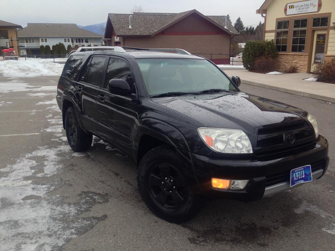

Pretty simple Q but I can't find through forum search. I just spent the holiday week plastidipping the crap out of my rig and am now terrified of having it peel off.
If anyone has tips for washing or to keeping the stuff from peeling help me out. Thanks!!

Yes. Just let it fully dry/cure for a couple weeks before doing so.. At least until it loses most of its "grabby rubbery" feel, and feels more like a soft plastic to the touch..

I have had dip on my truck for almost a year now and its still holding up just fine. Don't wash the truck for a week or so and you will be fine. I have have been off-road a few times, had my rims covered in mud for weeks and dip still looks new when washed. Once it is set up touchless carwashes will not hurt it.
I had a set of Enkei RPF-1 wheels plasti-dipped black for about year to change the look of a previous car for a while. Left tires on the rims and used notecards stuck in between the rim and the tire. Never had an issue pressure washing, stones, snow, ice, salt, scrubbing etc.
