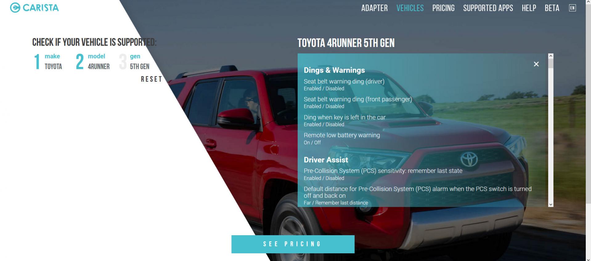

Anyone know how to turn the seatbelt minder off on the new 22s? There are no yt videos and the owners manual is vague.
You used to be able to do it on earlier generation 4Runners with no special tools, but I believe the 5th Gen requires you to tap into the 4Runner's Brain. You'll can ask the dealer to do that for you, or if they charge you (mine wanted $100 to do any Dealer programming) pick up an Obd2 dongle like Carista. It will allow you to turn off the seatbelt dings, as well as a whole number customizations like make the turn signal click louder or a different sound, open all windows with a long remote button push, etc. It's $30 for the adapter and the smartphone app, and includes one free month of the app use.
Toyota 4Runner 5th gen | Carista OBD2 supported vehicles | See what’s available for your car - Carista
