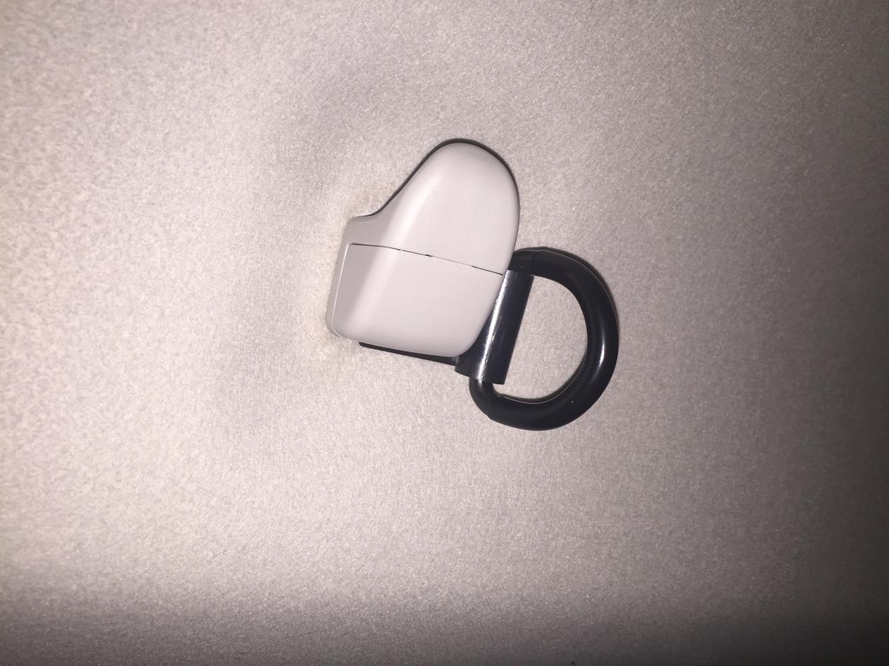

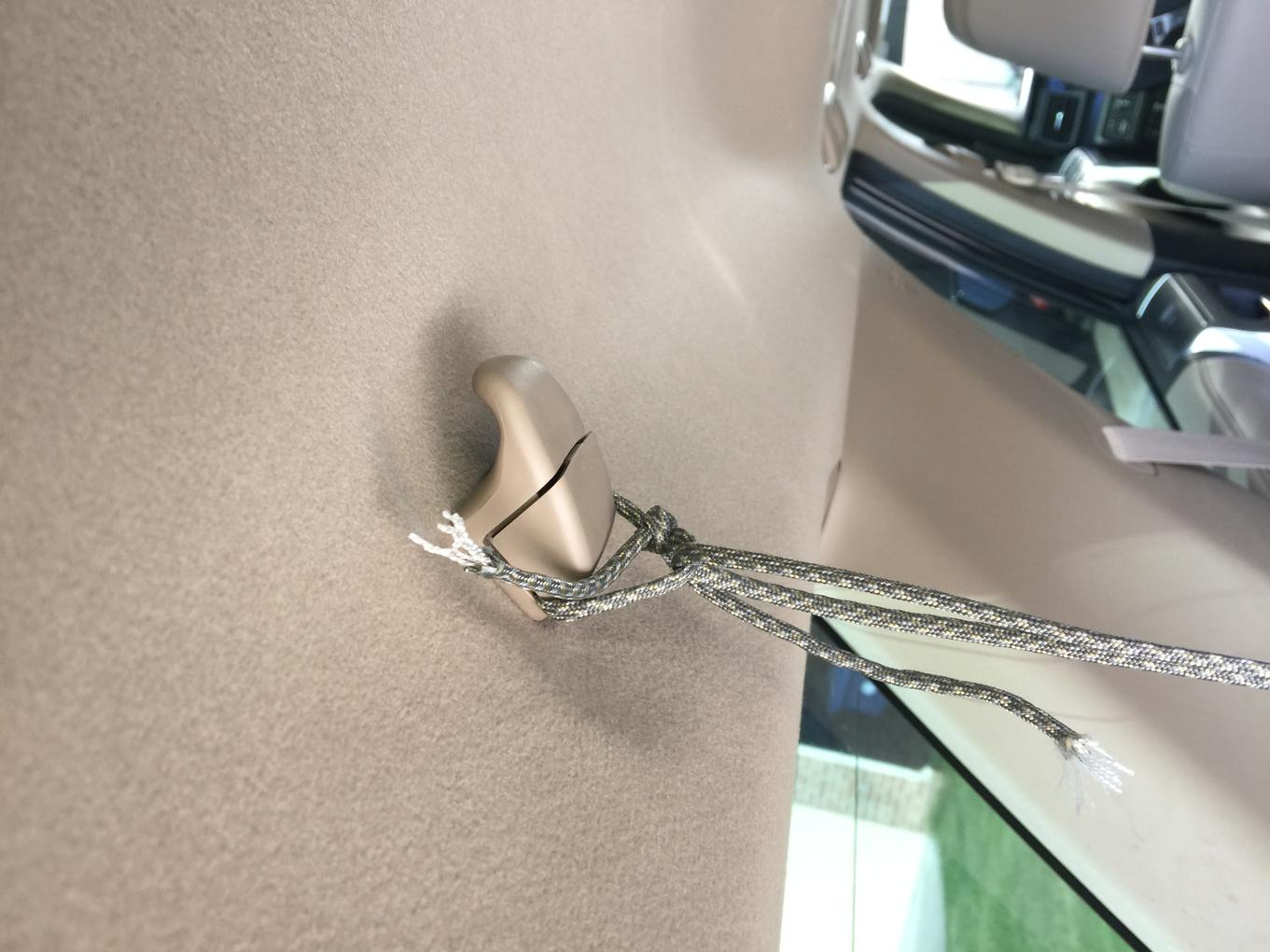

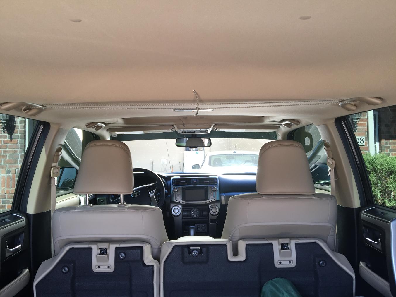

Hey folks. Trying to quickly rig a makeshift fishing rod holder (similar to this Boat Buckle® RodBunk Deluxe Rod Carrier : Cabela's) before I head out this weekend. Purchased some rope from walmart and quickly strung up two "rope shelves" on the handles in the front and middle row. Ran into my problem when I get to the third and final "rope shelf". The "handle" (hardly a handle more like a hook) in the third row won't hold my rope so I can string it across the roof.
Two questions:
1) What the heck is that for? It comes somewhat unclipped and there's a bolt underneath.
2) Any solutions to help get around this problem, I sat in the trunk of my truck for 30 minutes trying to figure out a solution and came up with nothing.

I believe I've seen people put a D-Ring in place of the hook, which would work for your case.
Unbolt the hook and bring it to HD and find a D-ring with a bolt hole the saae size.

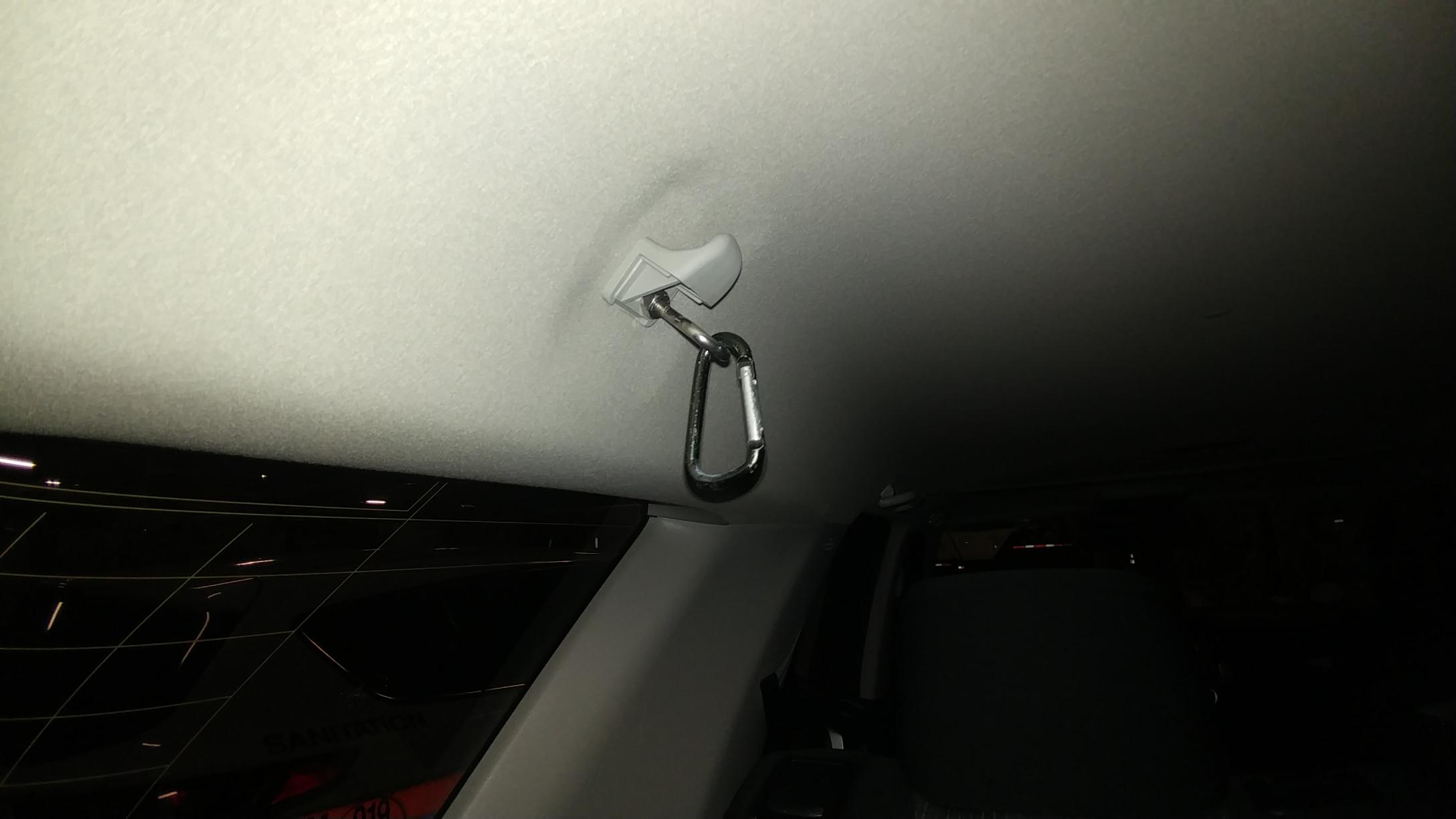

Thanks a ton for the great advice. Went to HD right after I saw your post, bough a couple D-rings and rigged it up beautifully.

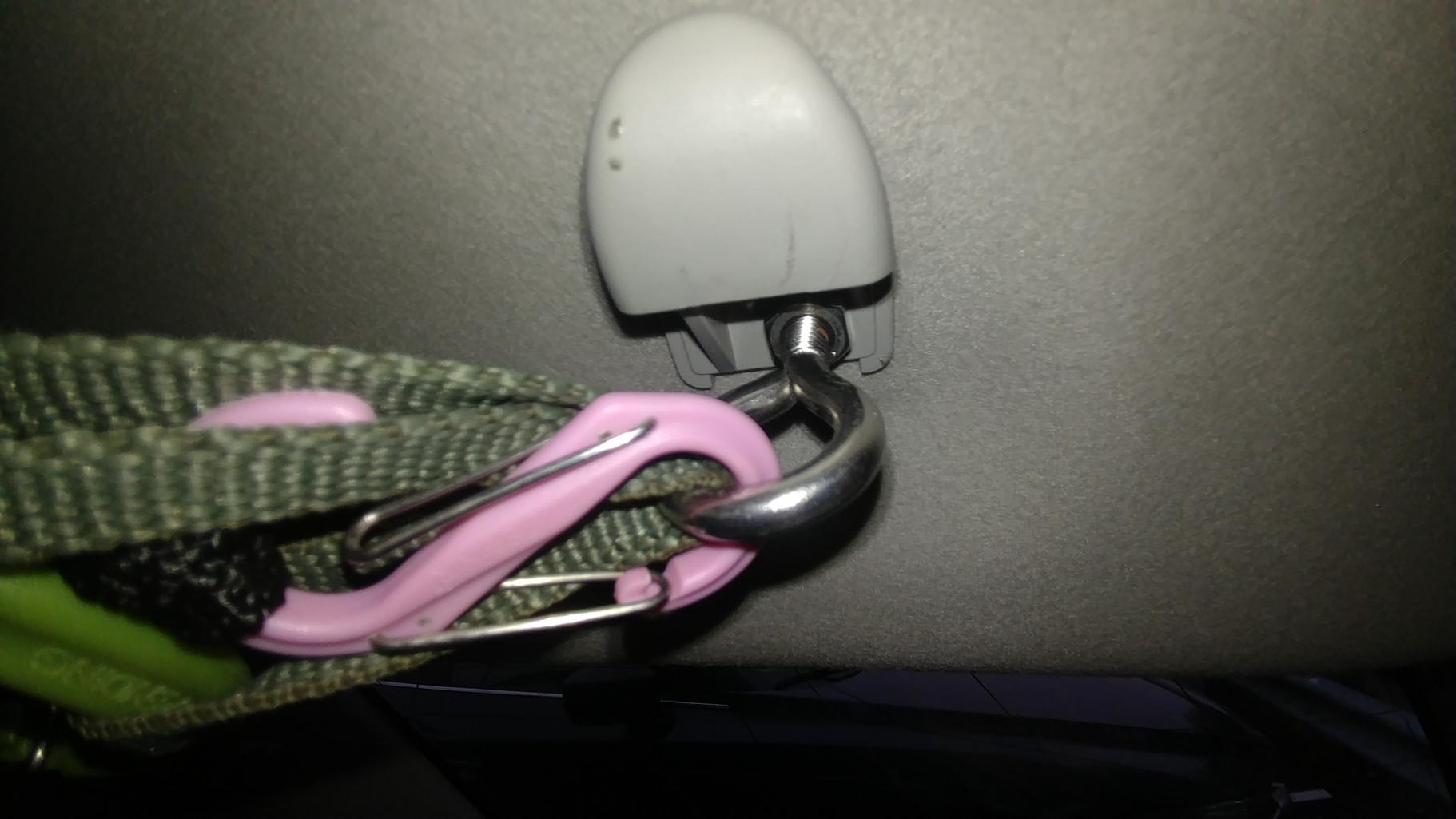

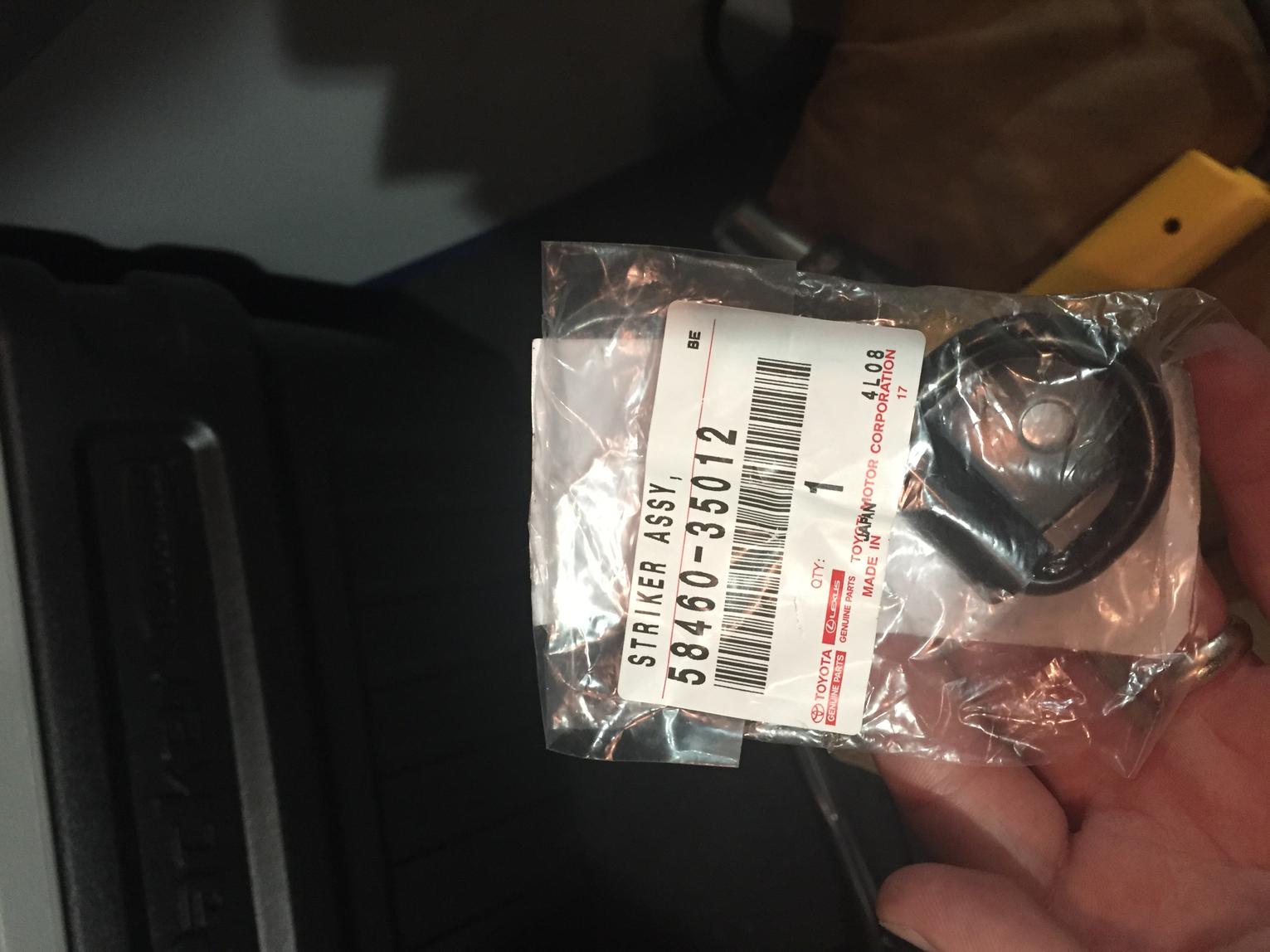

Your already got your solution, a similar option but retains the "clips"

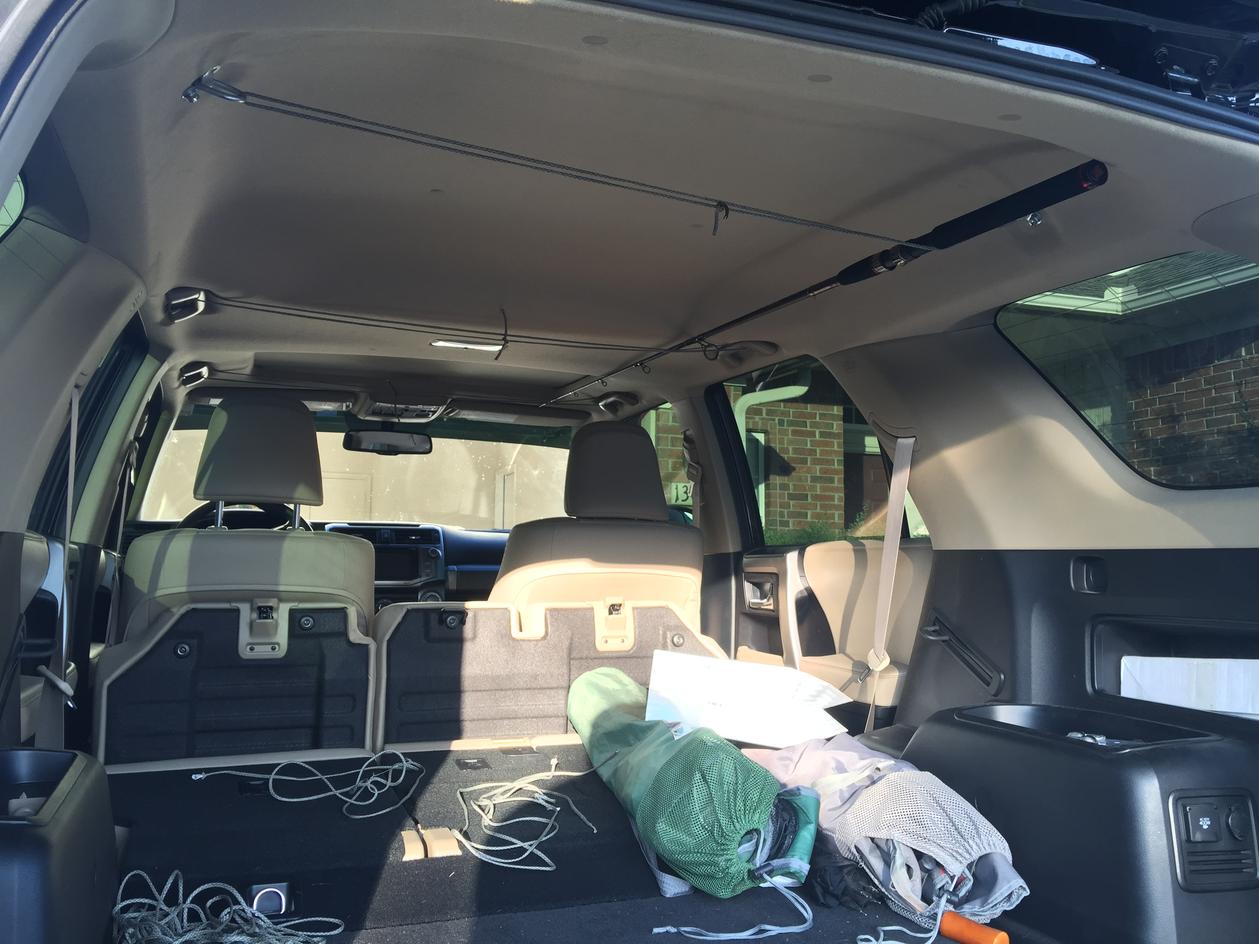

My Mod...
Just what I did. Super useful. I used to have the rope shelf setup. Then I got a ceiling cargo net from Santa. The rods sit on top of the cargo net just fine too. I just make sure to hook any lures on one of the top rod guides so that I don't wind up pulling two trebles out of the cargo net for a few hours. I guess the hook keeper would be even better since it's down by the handle and wouldn't even have to cross over the top of the cargo net. But I got used to not using the hook keepers after forgetting and sticking myself a few too many times.
