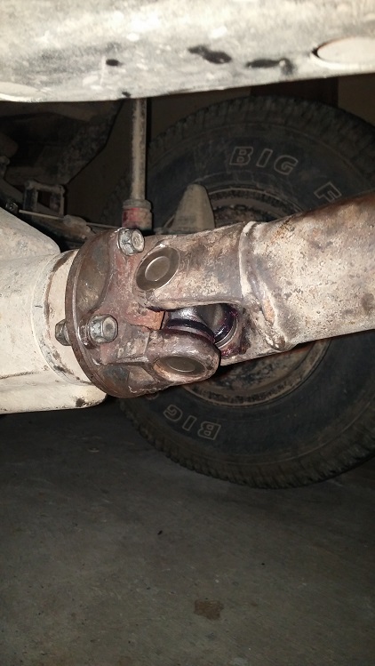

I replaced my u-joints and boy were they shot. I can't believe the yota was still driving. Not to mention none of the bolts were torqued down.... It was a major pain getting the old ones out but the new ones went in fine.

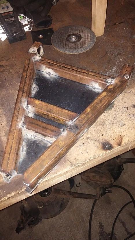

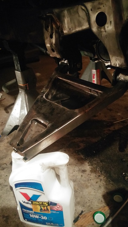

I got my first A-arm tacked up and almost ready for welding. I'm waiting on my bushing kits which are 2 weeks out :mad: I jacked up my upper arm mounts so I guess my kit won't be bolt in.. I got a T100 CV and measured 16.5" of travel. I figure about 15" of that is usable so I am shooting for 15" of 4WD IFS travel.

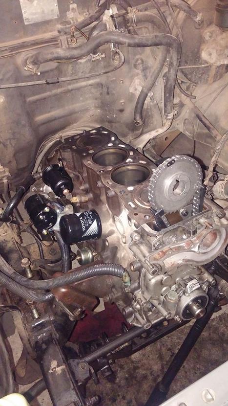

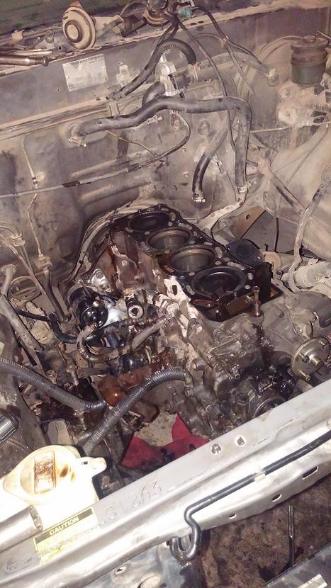

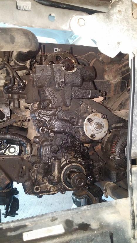

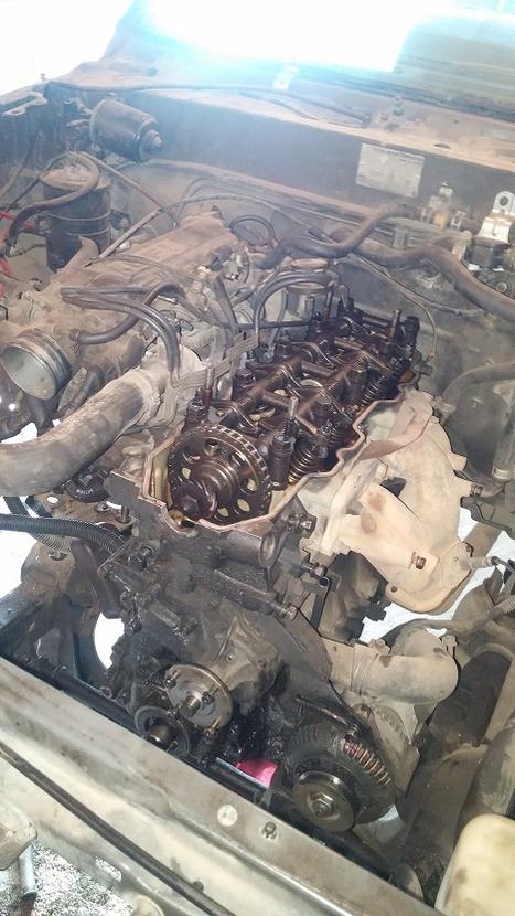

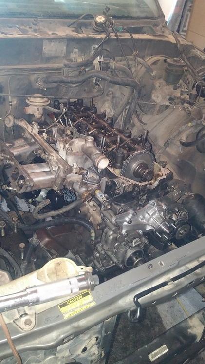

So I'm throwing in a new timings set and oil pan gasket. I have the front diff completely out. Is there anything cheap that I should replace or look at while I have the head and everything off?
haha :D
Sorry. At least you'll get some practice doing the gasket now. As long as you've got the head out, take it to a machine shop for a checkup, they'll let you know if the valves are good and if it needs resurfaced. Be sure to put a straight edge on your block mating surface while it's accessible.
So [MENTION=49649]KidVermicious[/MENTION], I guess it's a good thing I pulled the head because I have replaced TONS of baked on gaskets. The manual said to pull both the pan and the head anyways. I don't think it would have worked with only the pan.

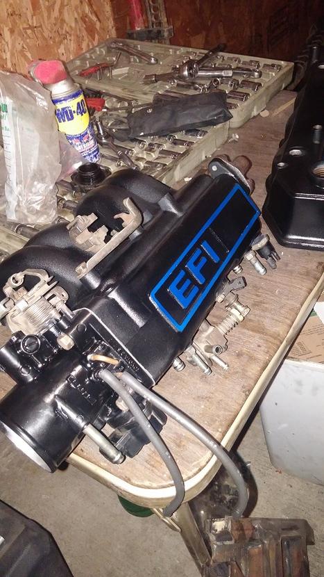

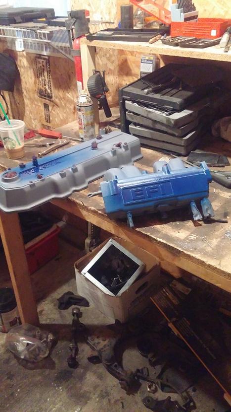

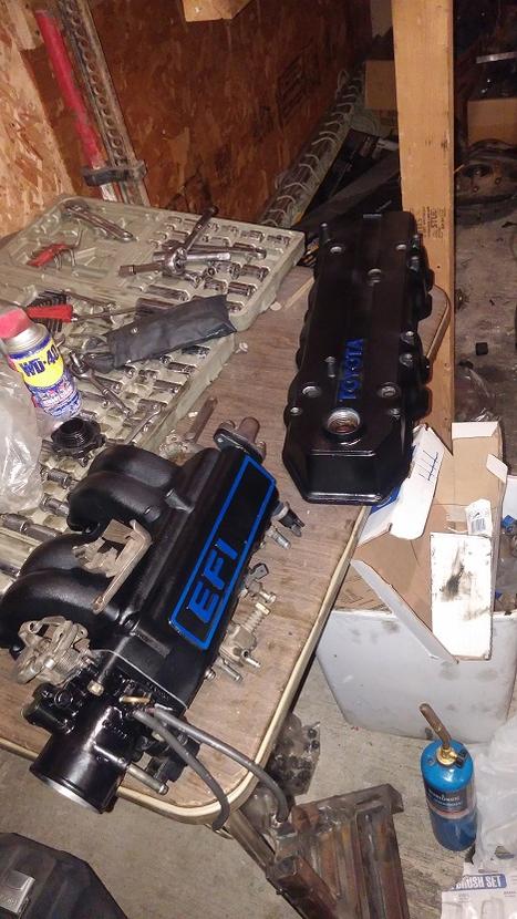

I made good progress this weekend. I wanted to clean everything and throw a little paint on while I had it apart. I have spent HOURS cleaning this greasy ***** up. I'm still not done cleaning either. It looks so much better though and I think it's gonna look mean when it's all back together.
I'm a little confused about the new oil sending unit. It seems like it sticks out far but it's really tight. I figure the space is so you can get a wrench in there? When I took the old one out I didn't notice because I couldn't really see in there, but I feel like it screwed in further...

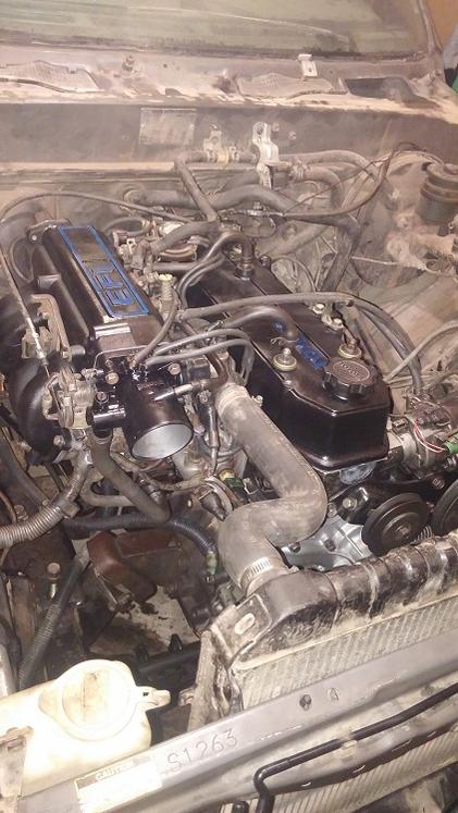

Almost done with the engine. Then I'll be able to focus on suspension

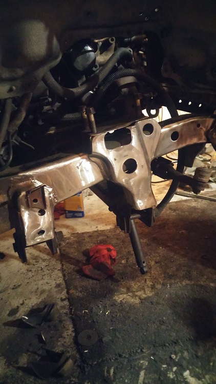

Today I ground off my stops and shock mount. I've decided I'm gonna cut off the whole UCA mount then box in the motor mount. It will make it easier to make mounts for my new UCA's and clean it up a bit.

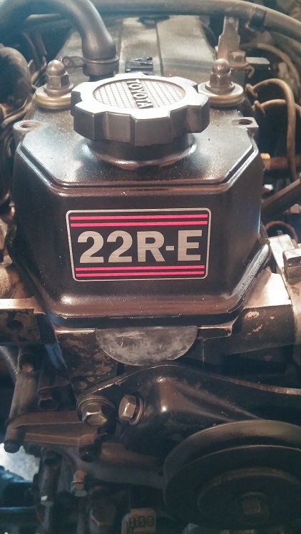

I got a sweet sticker for the valve cover too

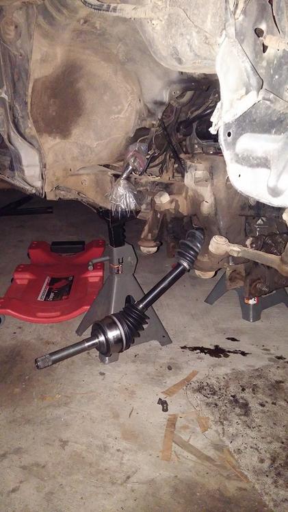

So I'm waiting on joints, but I got as far as I could without them. Looking good so far. Everything lines up right. My upper arm is going to be insane. Have you ever seen a horizontal uniball on a first gen? Neither have I, but we are about to :D

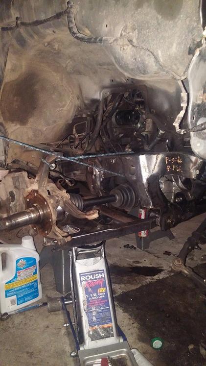

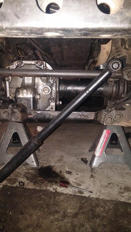

I cleaned up the front axle and got it back in. That ***** is HEAVY

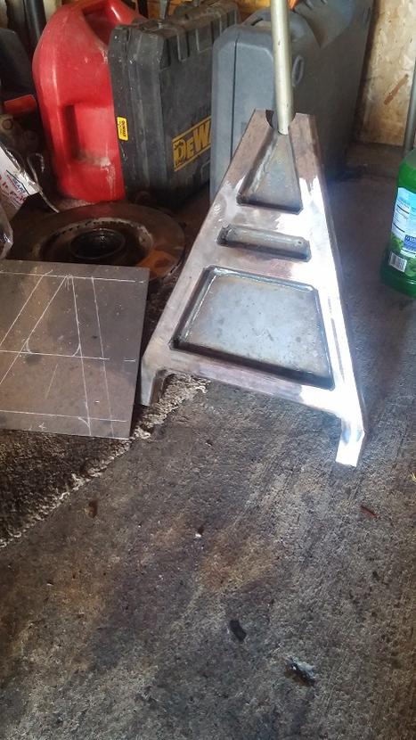

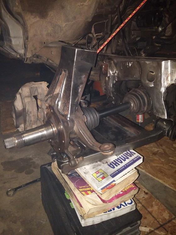

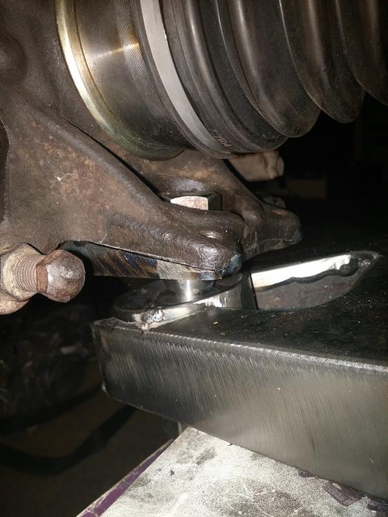

Finally made some progress on the suspension. I had to make a weird adapter plate for the spindle to the lower uniball in order for the spindle to sit parallel with the lower arm when the uniball is centered. I also cut a new hole for the uniball cup in the lower arm to optimize my CV/spindle/tire placement. So far it is cycling almost 16" of travel. The uniball is the limiting factor, but since it is limited to basically the end of the CV's travel I don't really care. And since my upper uniball with be mounted horizontally, there shouldn't be anything else limiting my travel other than my fender which I can deal with in the future.
I don't think I have posted a picture of my modified spindle yet. I pretty much made a beefy gusset then slapped some plates on top to mount the uniball. I couldn't find anyone on the internet that made a gusset for the 1st gen spindle which I thought was interesting. I think that's about it for now. Thanks for reading! :wave:
