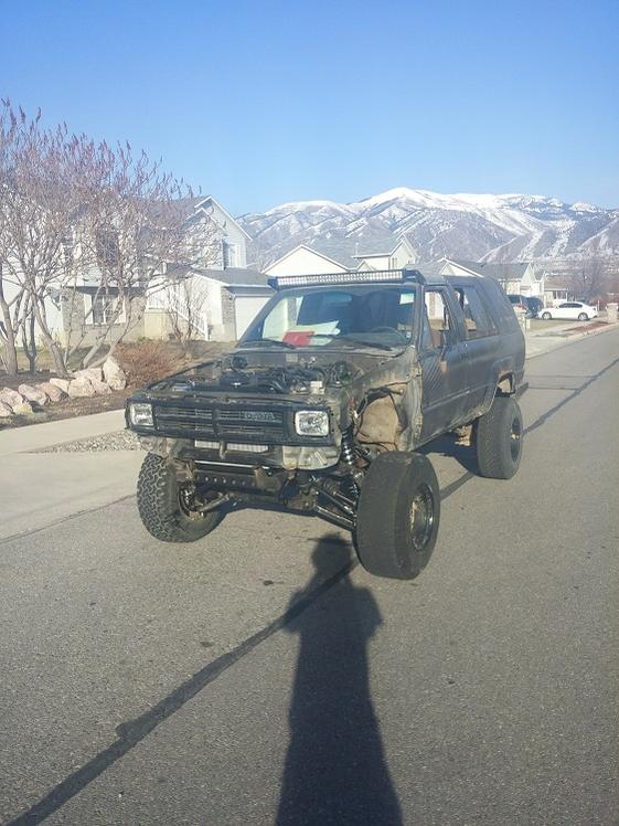

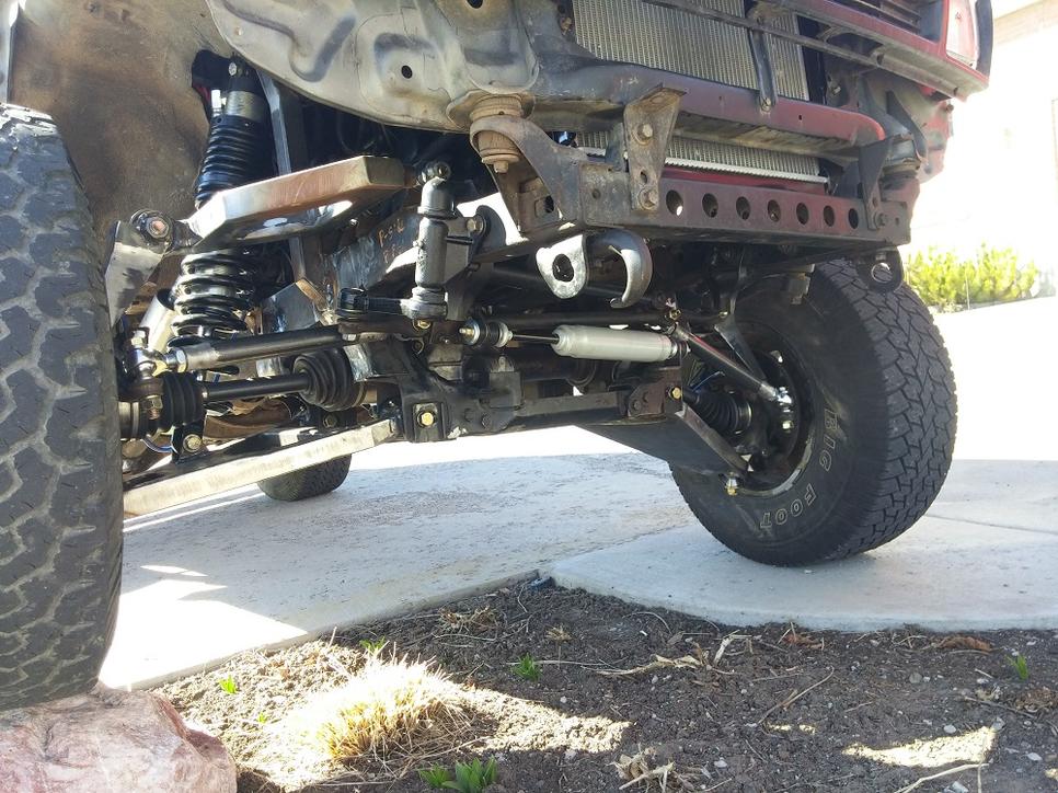

So nice. What are you going to do for fenders? That's quite a bit of uptravel.
Thanks man. Im gonna have like 4.5" sharp bulge glass. After seeing how far it bumps Im thinking about running 35s instead of 33s for more ground clearance at full bump. I am confident the 31s will stuff perfectly in the fenders, but when I get new tires I'll have to set the bumpstops accordingly. Also, its about 3.25" wide each side because I'm using T100 axles

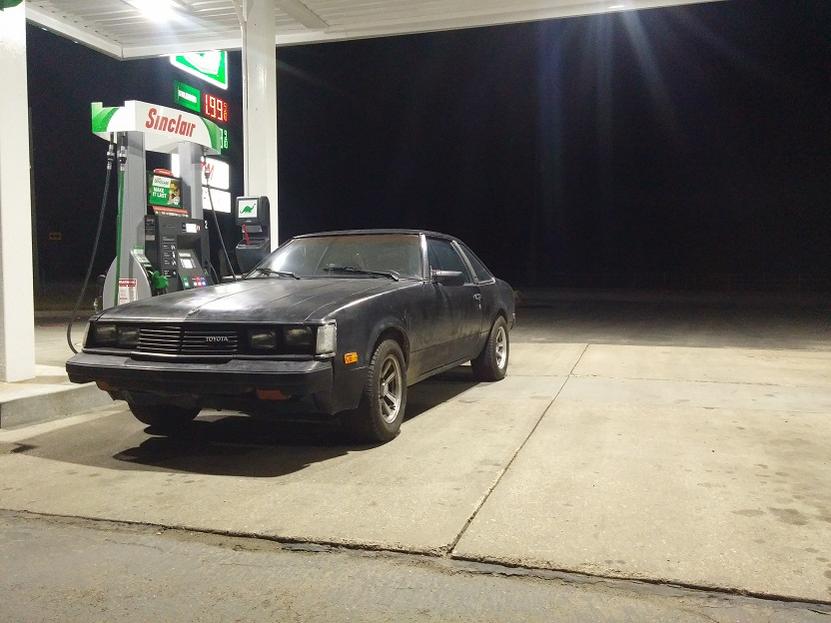

First off, I bought me a sweet 1981 Celica (RA40) with the 22r for $750. I couldn't pass it up and its an awesome little get around car.

So the good news is she's running and driving pretty well for not being tuned AT ALL. I need to adjust camber and toe mostly on the passenger side. The driver side is surprisingly close though I may adjust the toe a hair. I think the best thing I could do right now is find out the exact spring rate I need for the front to settle it down a bit.

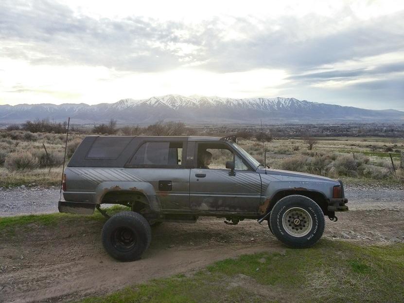

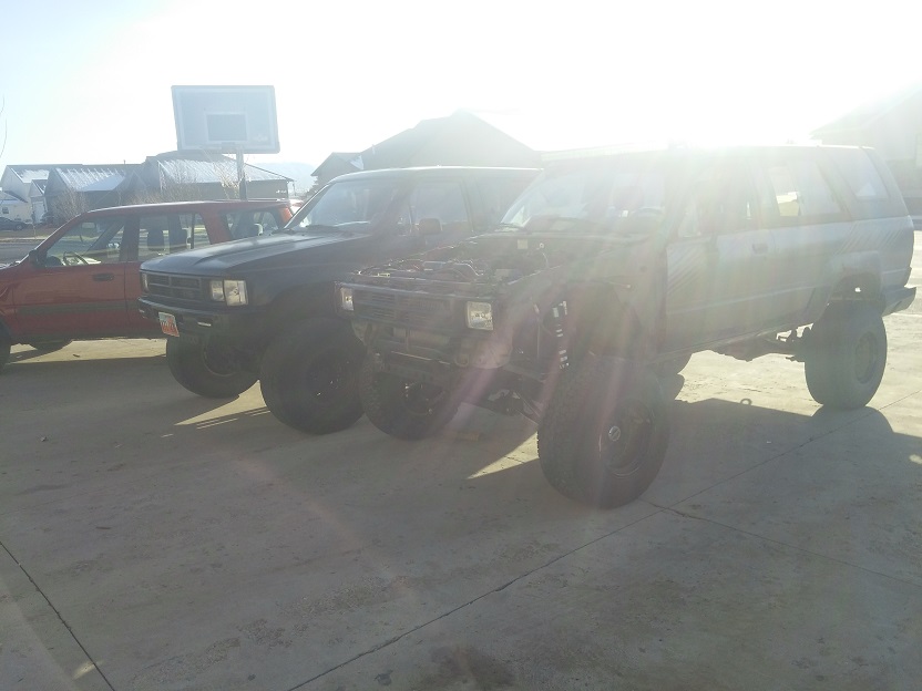

Did some minor adjusting today then tried to flex in our rock garden :)

A few pics from today

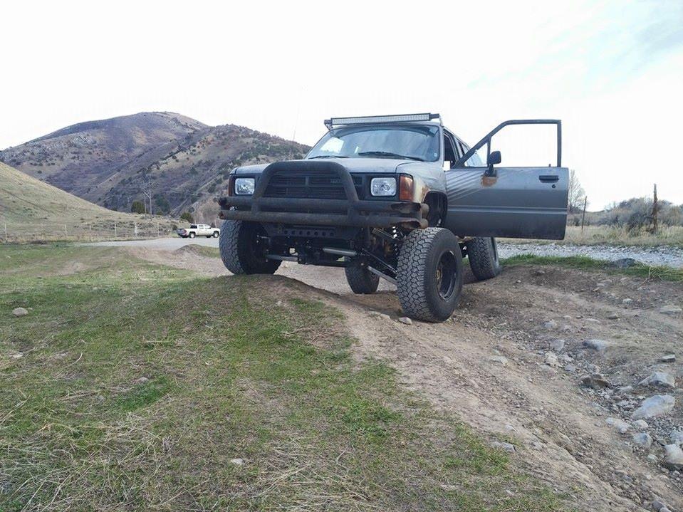

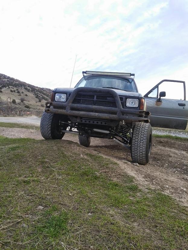

More pics since I'm bored in class :D I'm really impressed with the suspension and how nicely it's behaving despite having less than an hour of driving time. It's funny since the rear used to feel super smooth since the stock IFS was so stiff, now the rear feels horrible since the front end is so smooth. Very impressed considering this is the second LT we have built, and is considerably different than the double A-arm suspension we first did for my 3rd gen. Still lots of fine tuning to do, but I think Cartzo might have the most unique IFS of any 1st gen excluding the fact it's cusom. Hopefully the highest performance IFS too after a few tweaks in the near future :)

It looks so much better without that POS bumper. I think I'm gonna throw a quick bumper together at work because that ugly thing is ruining my front end sexiness
