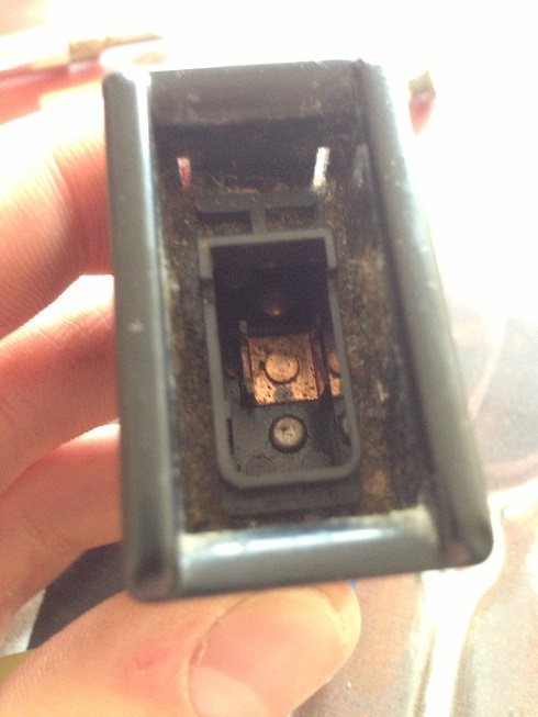

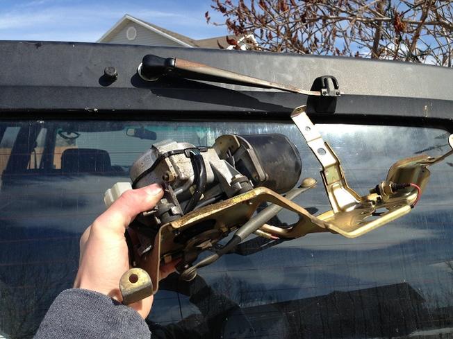

So today I was a little bored so I decided to pull apart my center console to try and find out why the rear window button wasn't working. I got the switch out and didn't know what else to do other than pull it apart and see if it was still functional. Everything was fine as far as I could tell it was just really dirty so I cleaned up all the metal contact points and put it back together and what do you know? It worked! I'm happy because things are never that easy for me. I also switched out the whole rear window wiper system with the one from my old white shell because the spindle that the wiper arm attaches to was messed up.

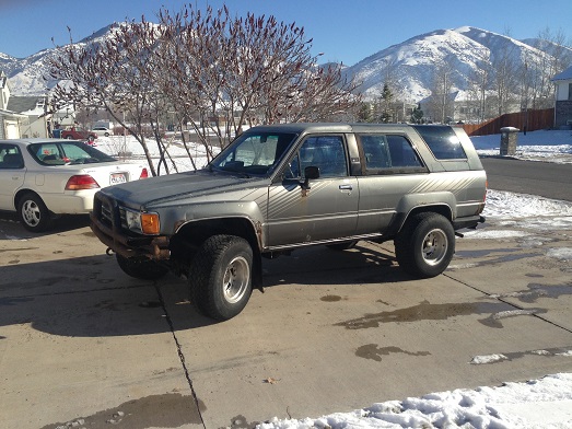

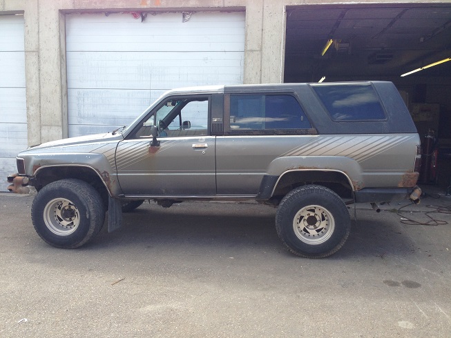

Did my own little zuk mod today and damn did it make a difference. The ride is awesome and it looks so much better. This should hold me over until I get new springs. My girlfriends dad had some coil springs laying around that he let me use so it didn't cost me anything!

... I got the switch out and didn't know what else to do other than pull it apart and see if it was still functional. Everything was fine as far as I could tell it was just really dirty so I cleaned up all the metal contact points and put it back together and what do you know? It worked! ...
Yes, in the past 26 years, someone must have spilled, coffee on that - LOL! Those switches are placed in a very bad condition, while there's so much space on the dash.

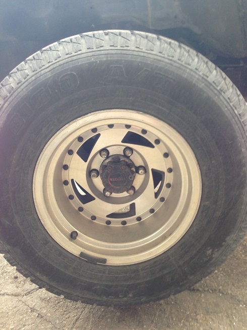

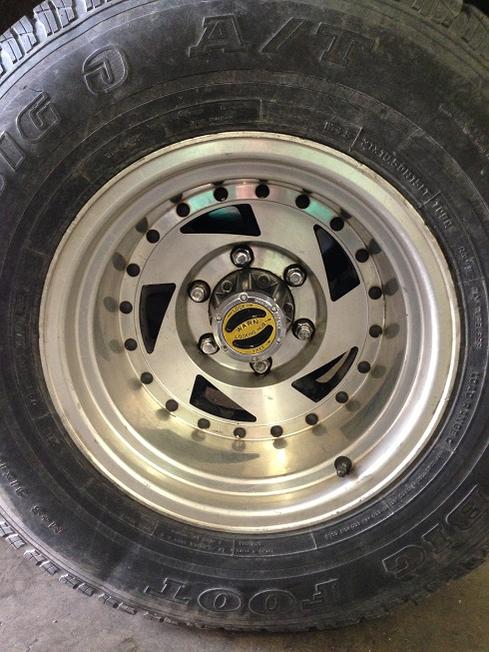

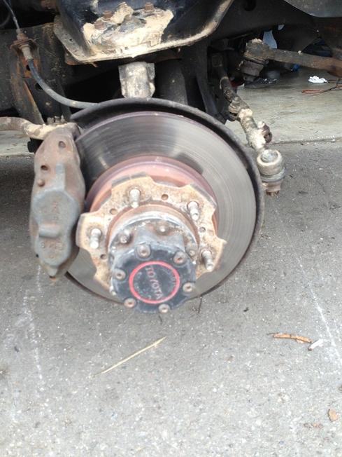

Got the hubs in today and 4WD works again!! I'm super happy with the Warn's they look awesome. I had a few troubles when stripping down the auto hubs but I just followed the instructions from 4x4wire.com and it was cake!
